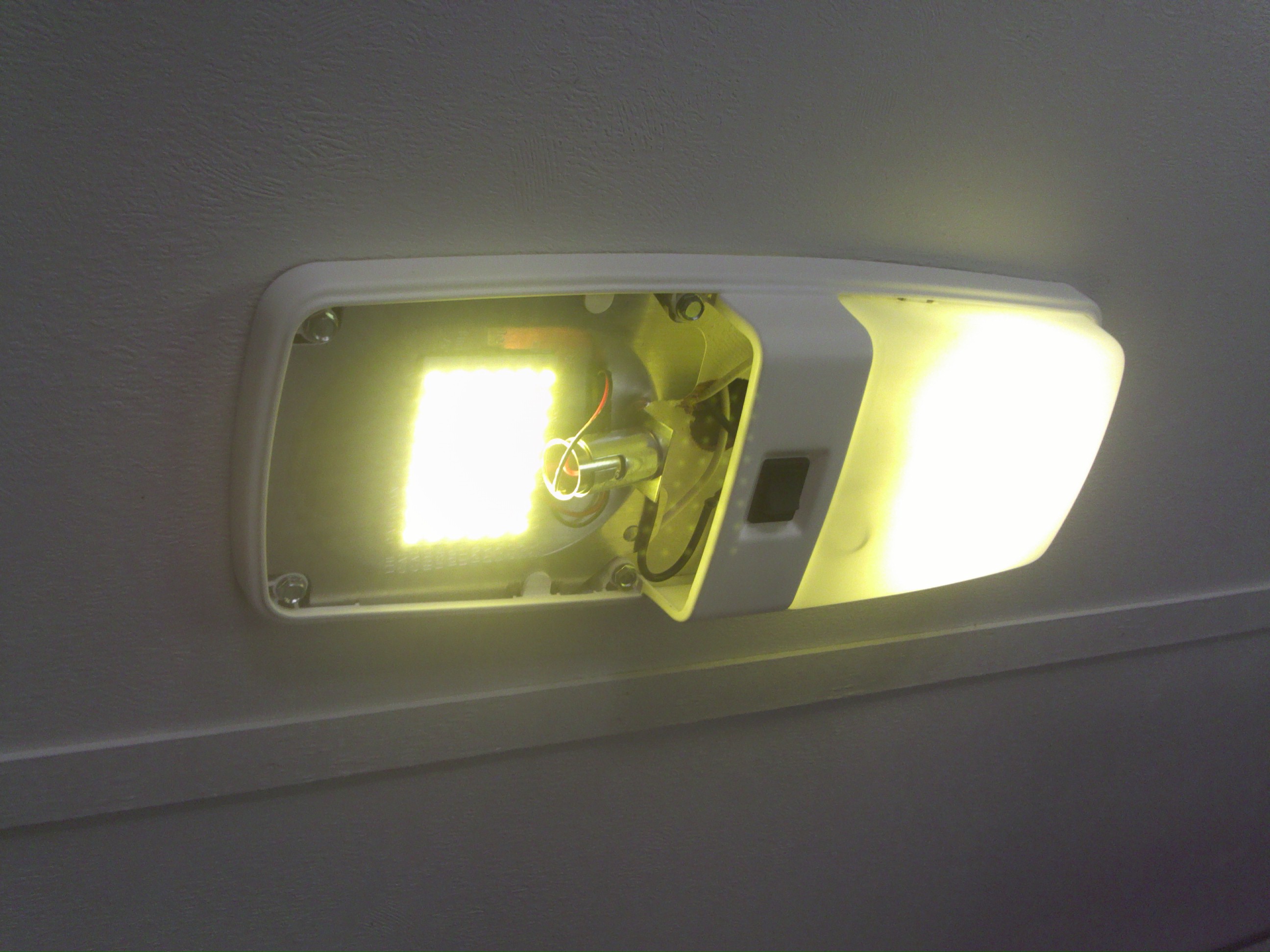

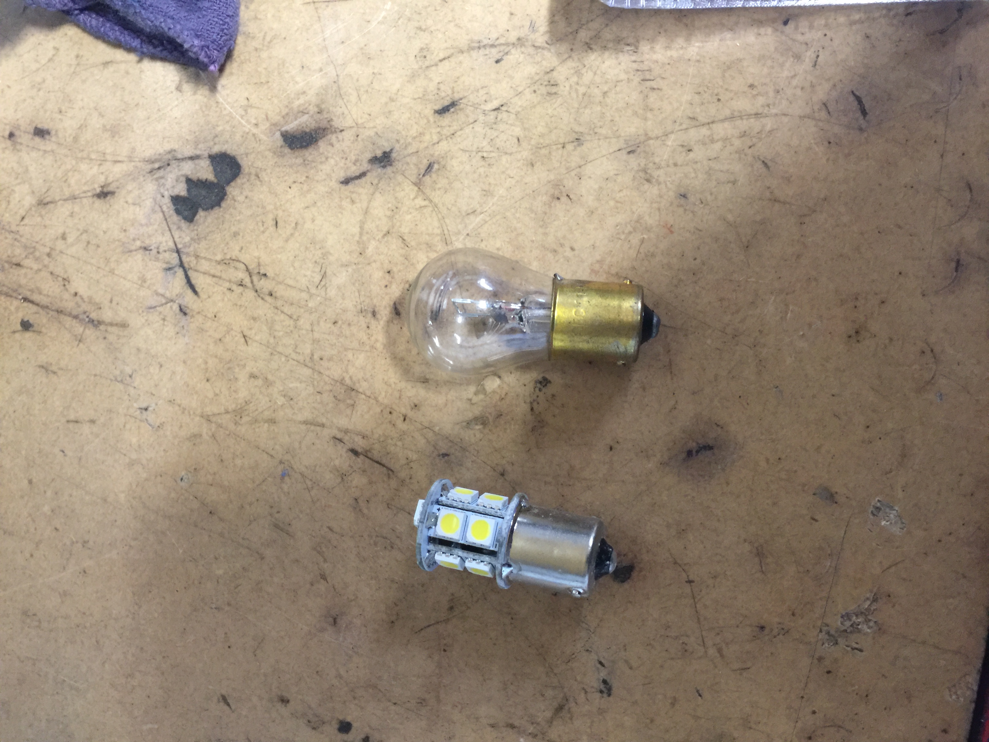

Amazon LED vs stock incandescent
post-9131-0-72979900-1456262155_thumb.jp
LED on left stock on right
post-9131-0-52118700-1456262171_thumb.jp
Very very happy with the change!!!! Didn't "have" to run the generator at all for the batteries, just for the microwave and air compressor

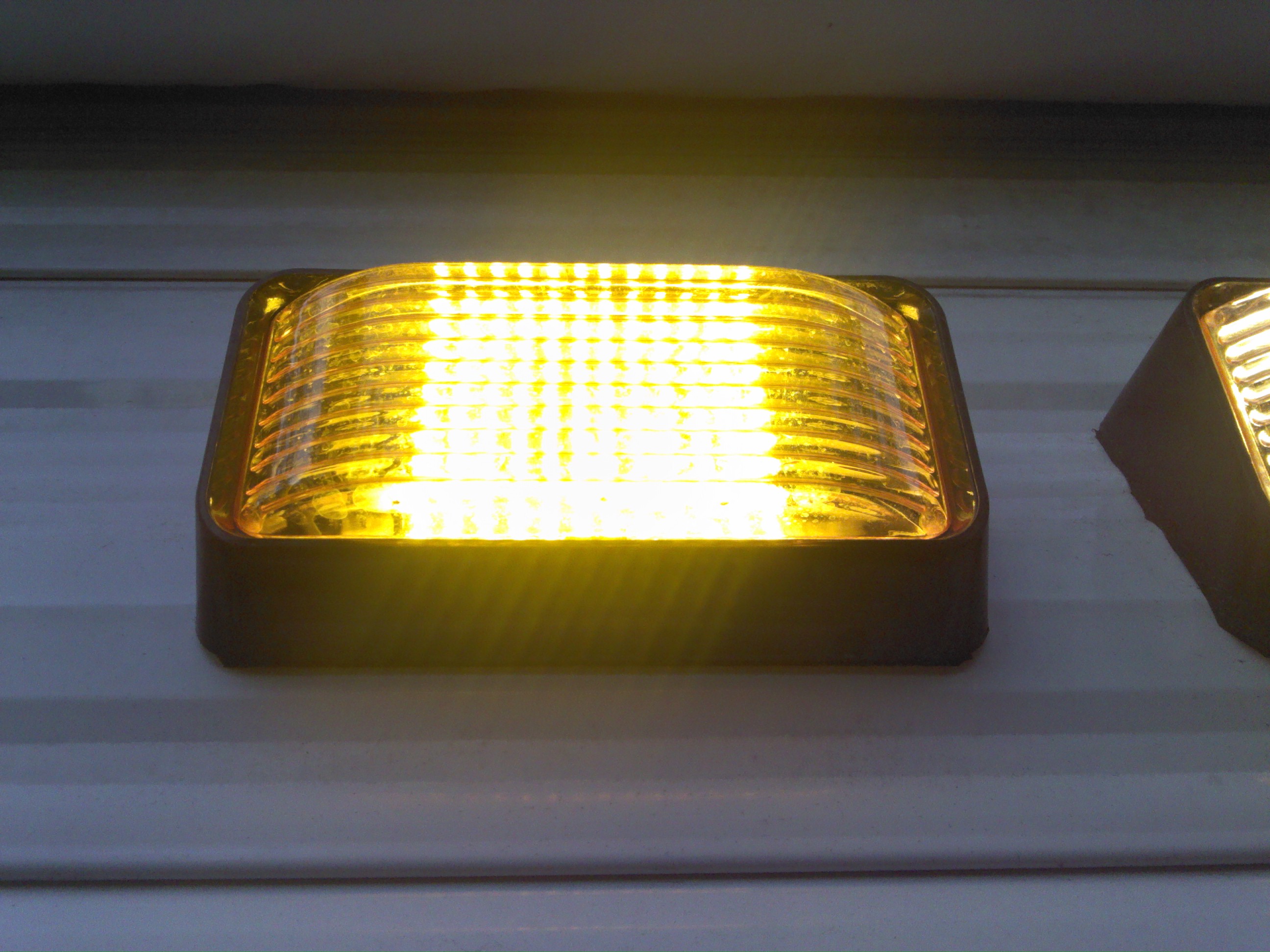

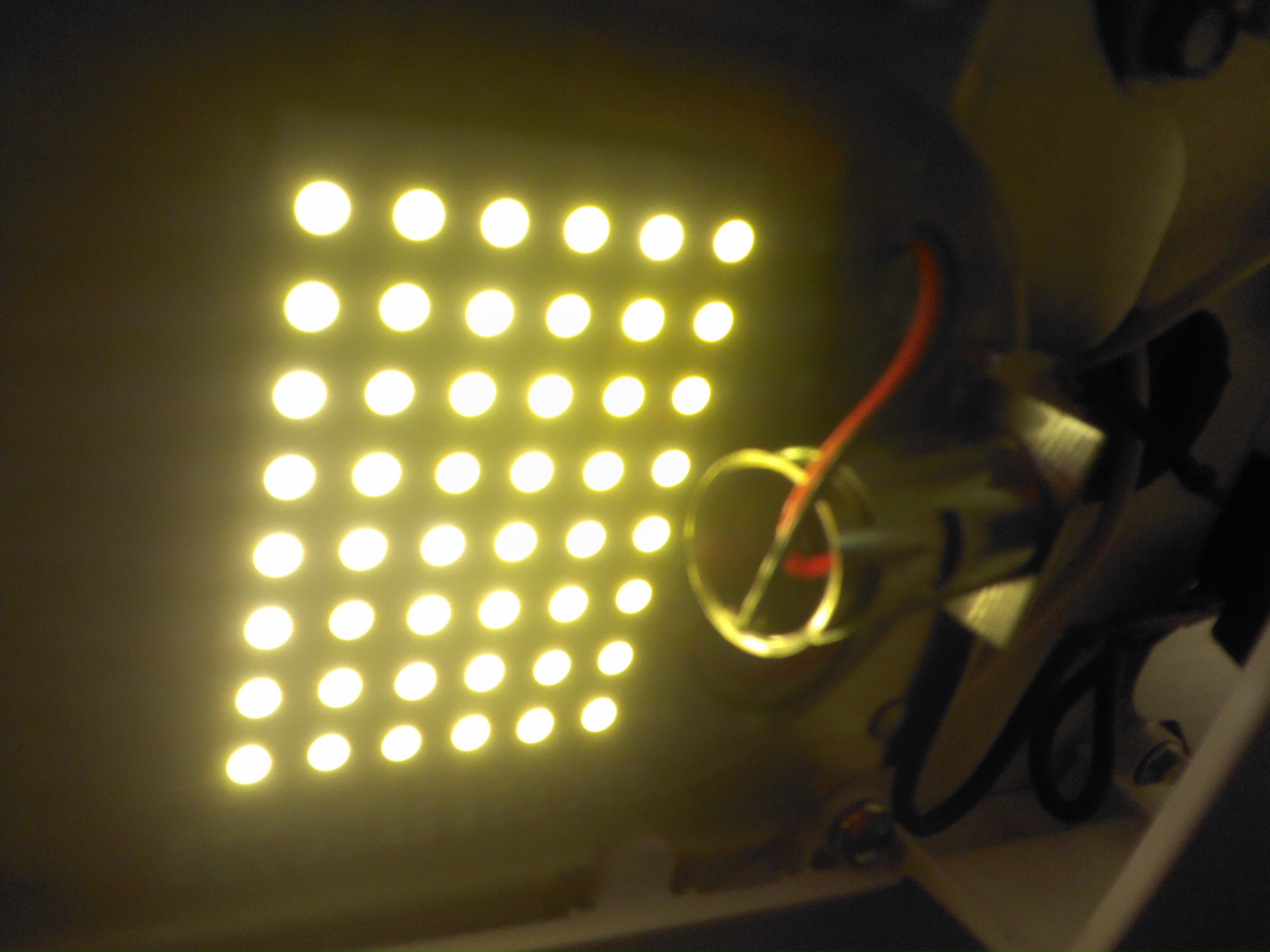

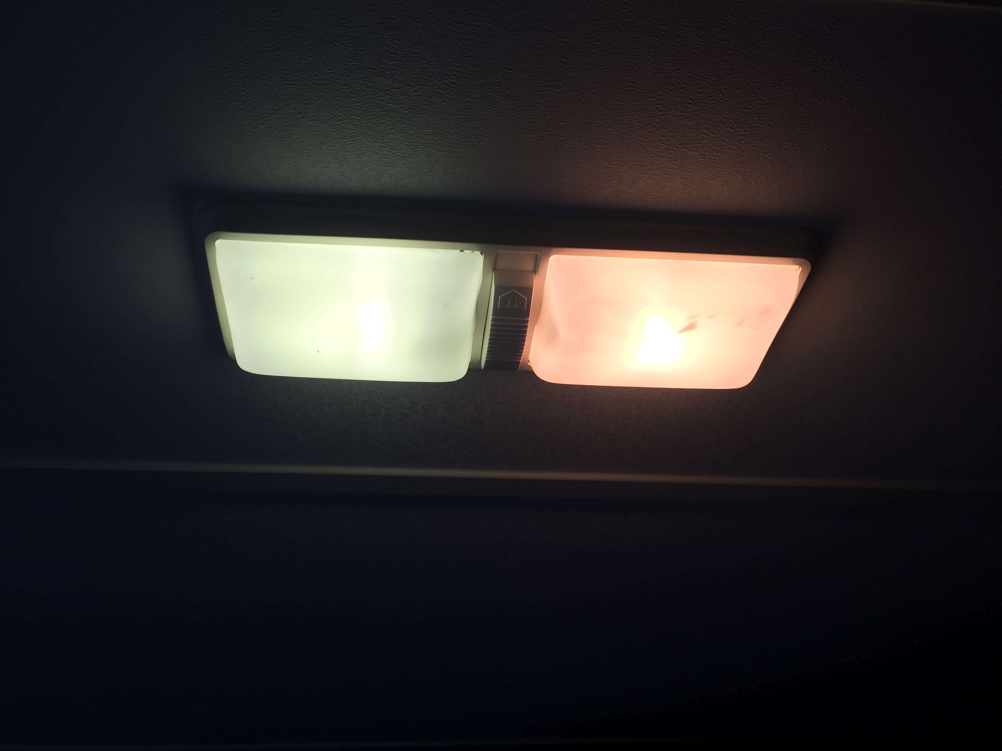

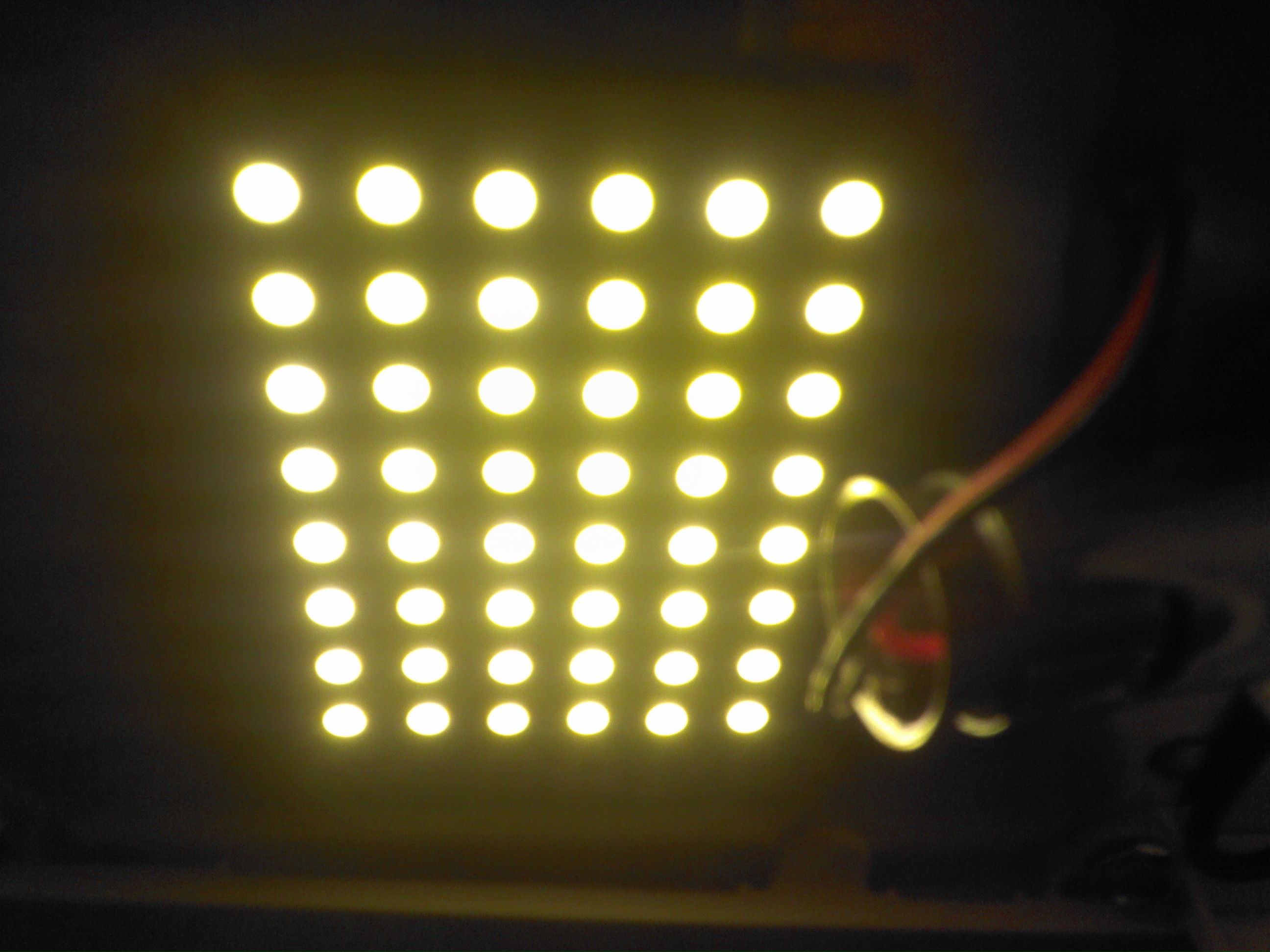

I went with the flat panels also. They have 48 LEDs on each panel. I colored the inside leds with a yellow marker pin...lol...looks good!

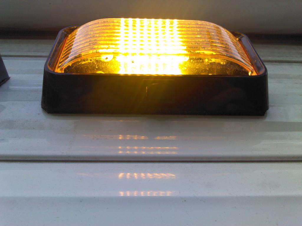

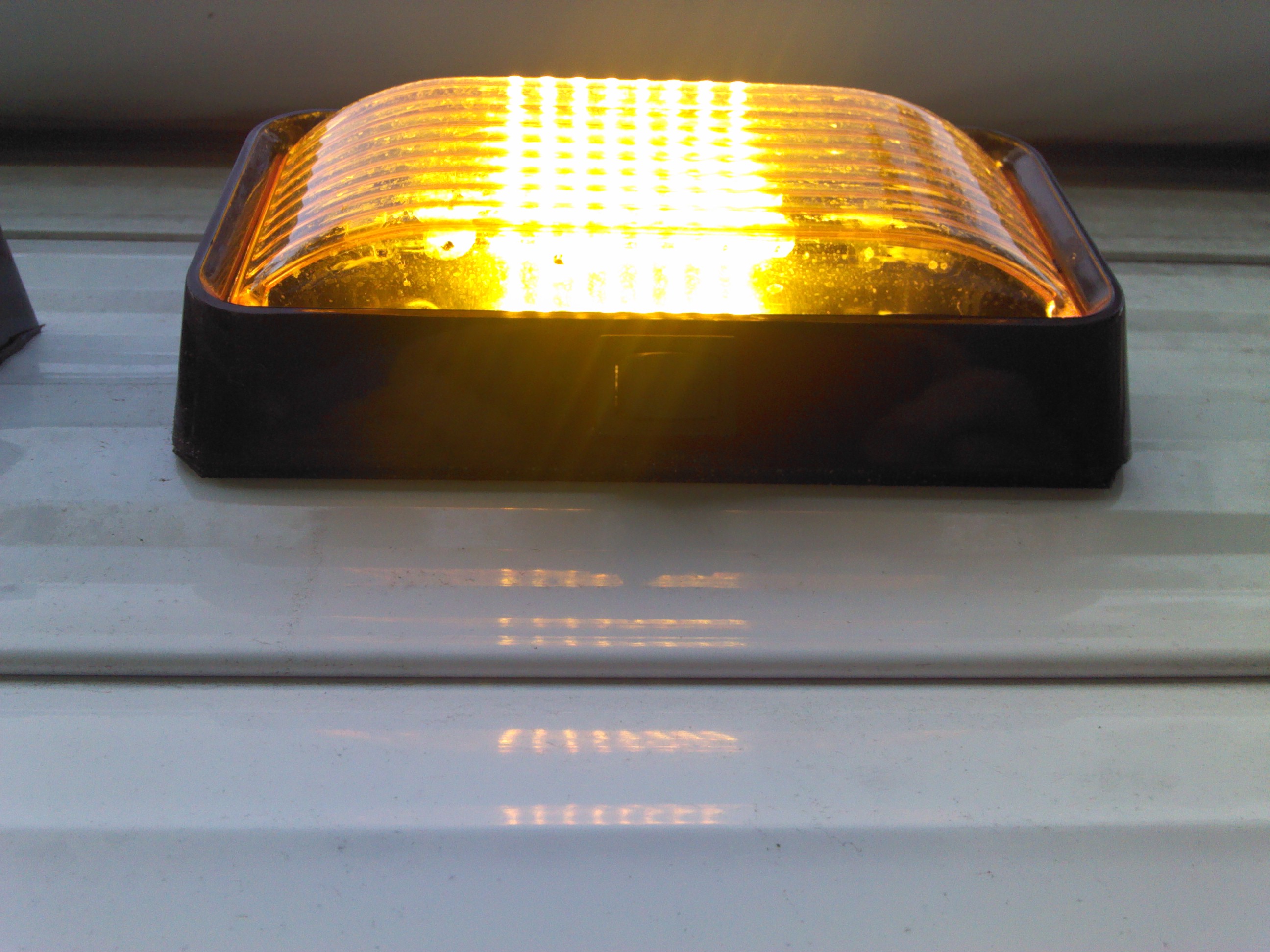

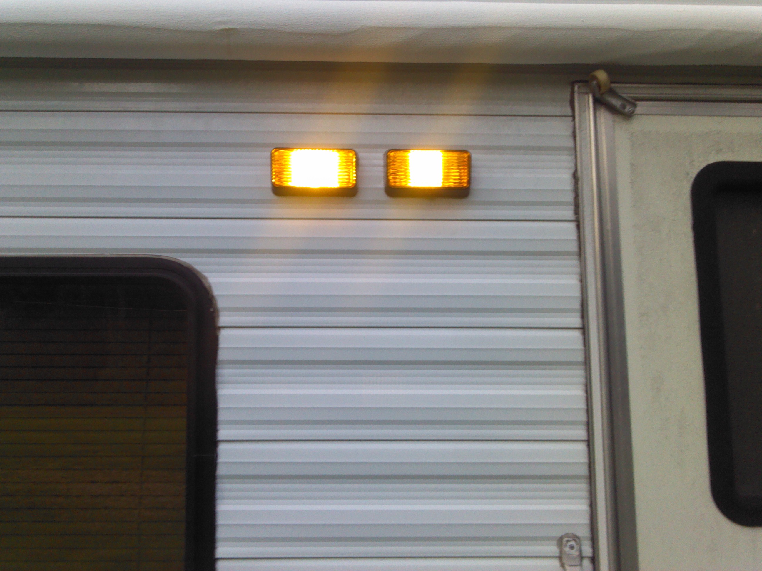

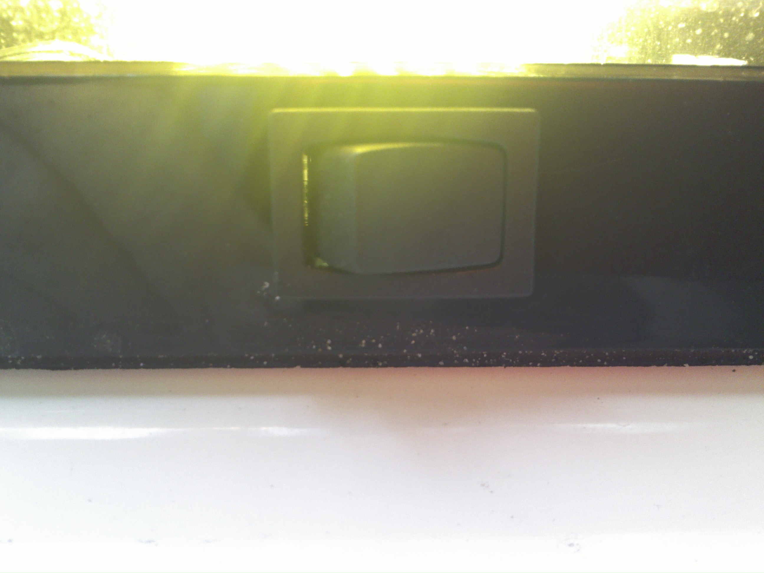

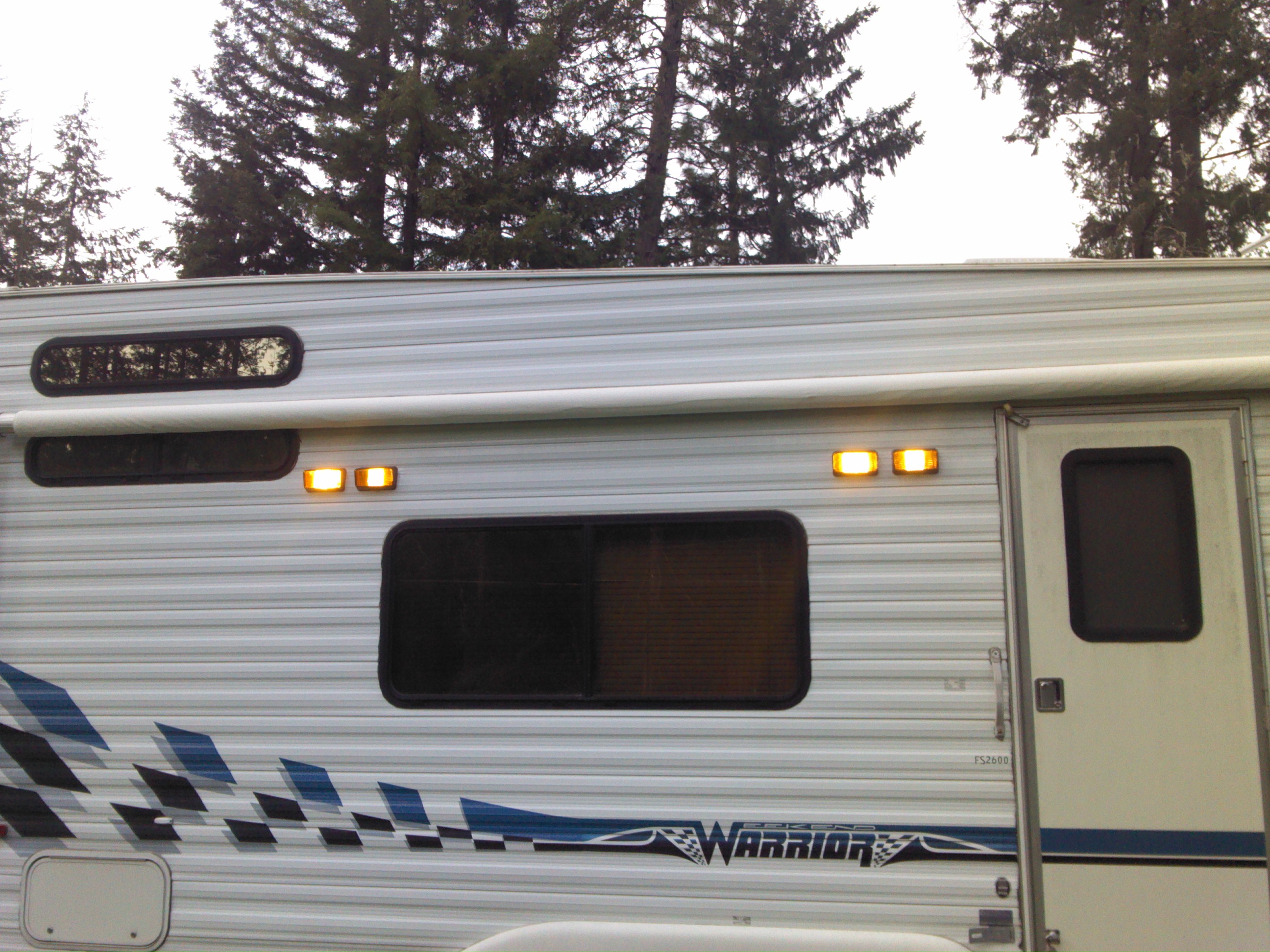

I put them in the outside lights also with amber glass. I mounted four lights on the door side of the trailer... used an outside switch on two of the single 48 led housings to power/switch the 94 led lights next to them. It took about a foot of wire in the wall to switch power to each 96 led light. I now have low, med & high beam of light. And no bugs with amber!
