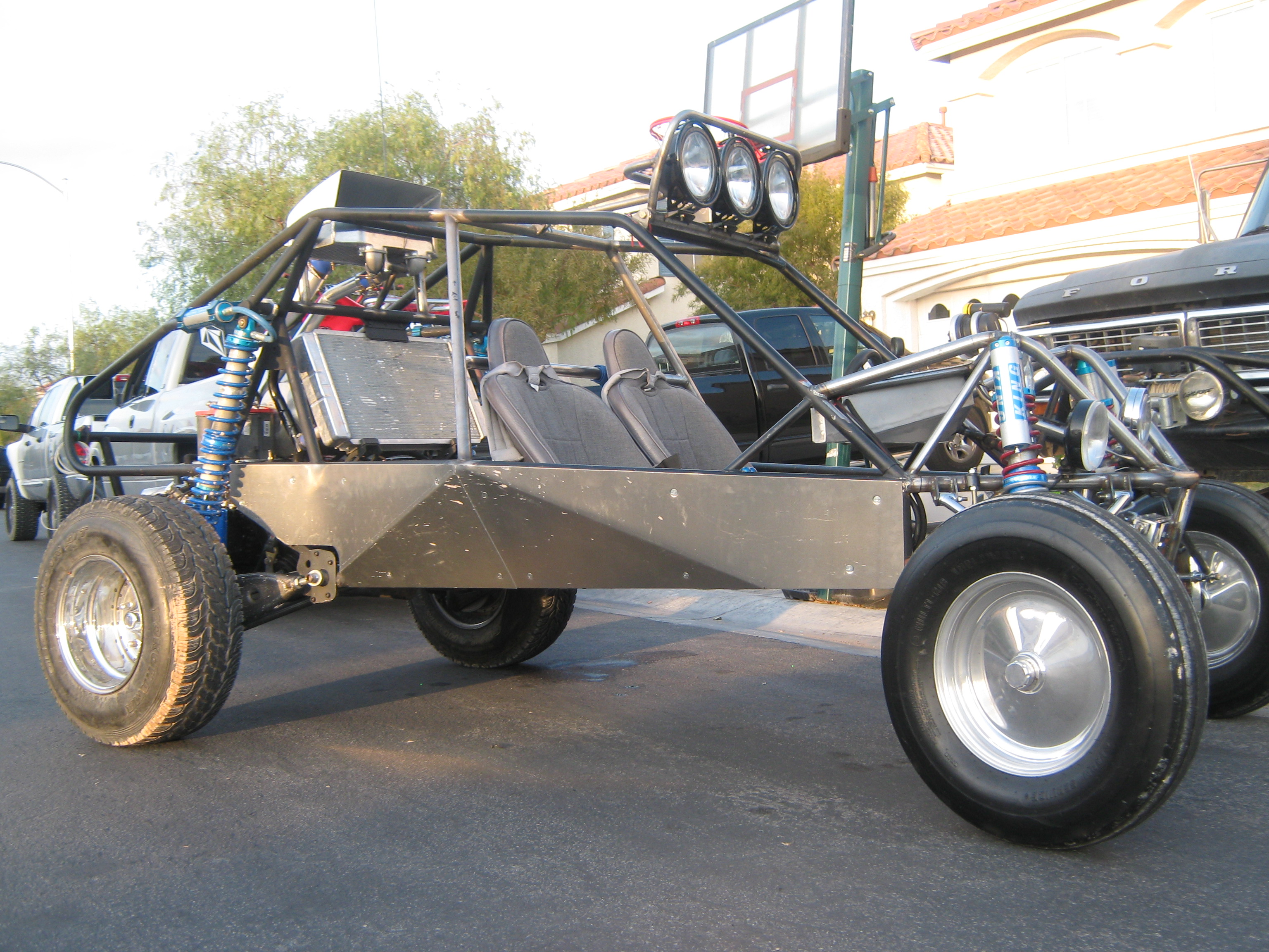

I've been lurking for quite a while and finally decided to quit being lazy and post pics since the car is is about where I want it.

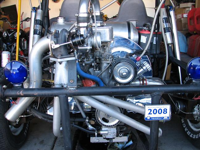

Started out 3 seasons ago as a mid travel 4 seat fugitve frame with a 1915 turbo'd IRS car with a 5 rib 002. After the first season the vw gave me soo many issues that I decided a repower was for me and in went a 2.5 turbo subi post-4148-1253542589_thumb.jpg
So of course with the subaru and supporting parts was extra weight so I pulled out the torsion bars and put an eliminator kit in with the heim setup and wheeled and dealed with a buddy for some King 14in 2.5 coilovers. Shortly after that with a few fun rides in the desert the rear boxed 3x3 arms decided to taco.

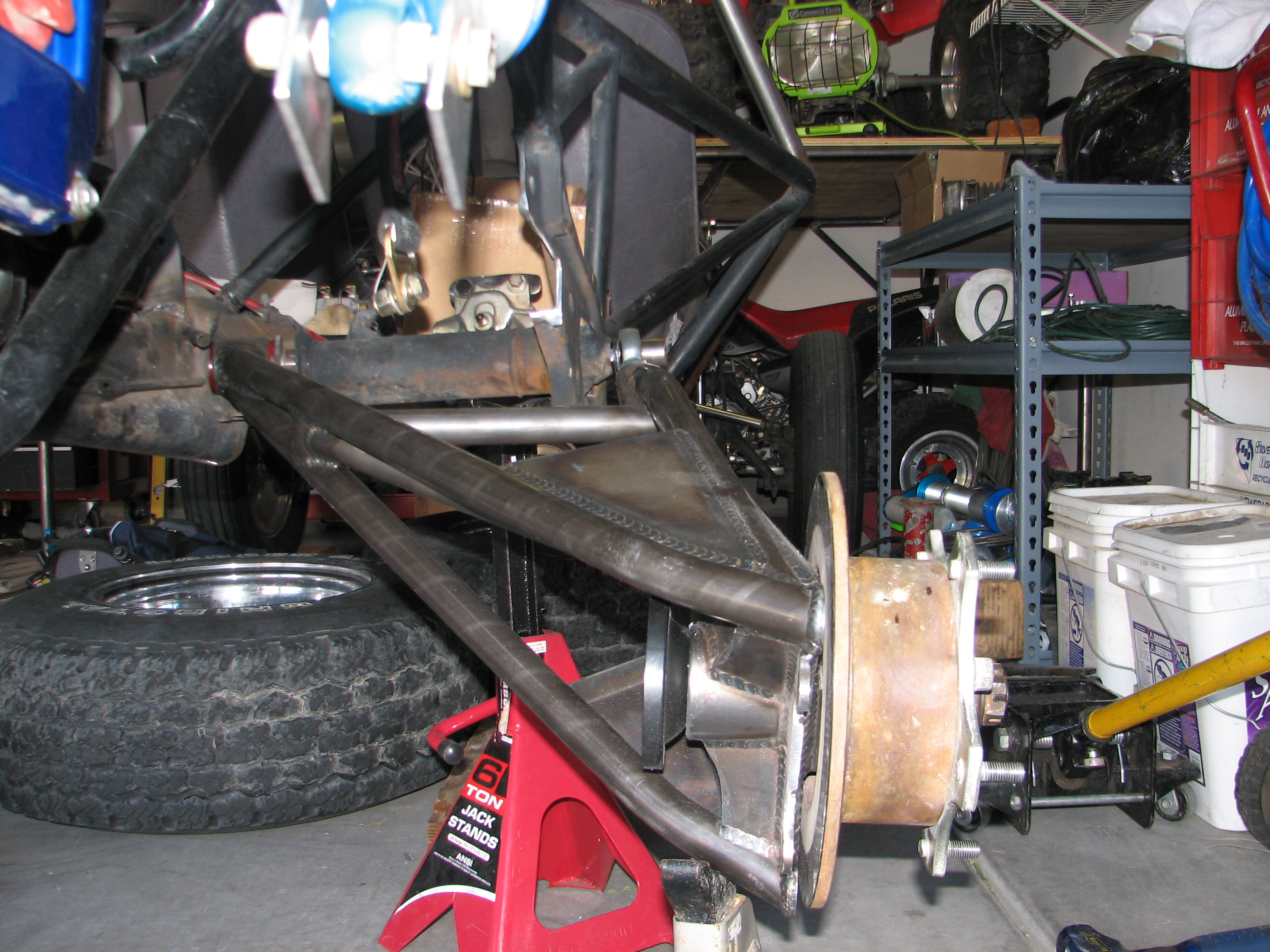

next was a set of Averys offroad Chromo 3x3 arms that I had them made to reach all the way up to the torsion housing and not bolt up like your average 3x3's. MUCh Beefier.post-4148-1253543144_thumb.jpg
Along the way with that ordeal I upgraded to a set of wilwood calipers on the rear and ditched the 2 piston conversion calipers that came with the car.
Over this summer the 002 tranny was swapped out for a built 091 close ratio from Don's bus boxn WOW what a difference.

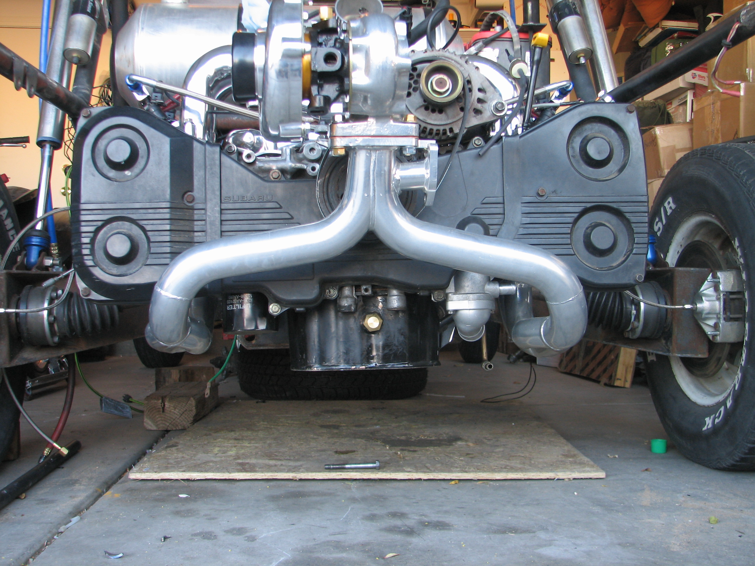

All this leads us up to current events trying to finish to go out this season. A couple weeks ago I had a knocking in the engine, after further inspection I had pieces of bearings in my pan. I have had an STI block laying around and so it has gone in and the engine is on it's way back together but this time will be running 10lbs of boost compared to the 5 I had in the last engine.
So next added was an oversized STI intercooler I mounted but had to have plumbed and a scoop installed.
I contacted a local Fab shop (Rock Monster) and had Justin Cramer look at what I needed, he built the scoop and plumbed it.

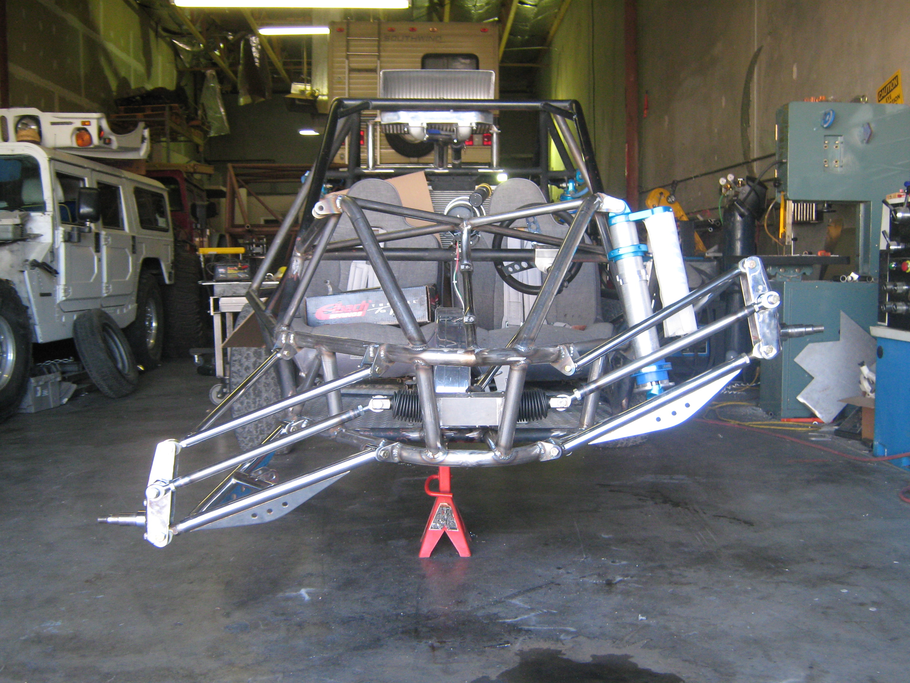

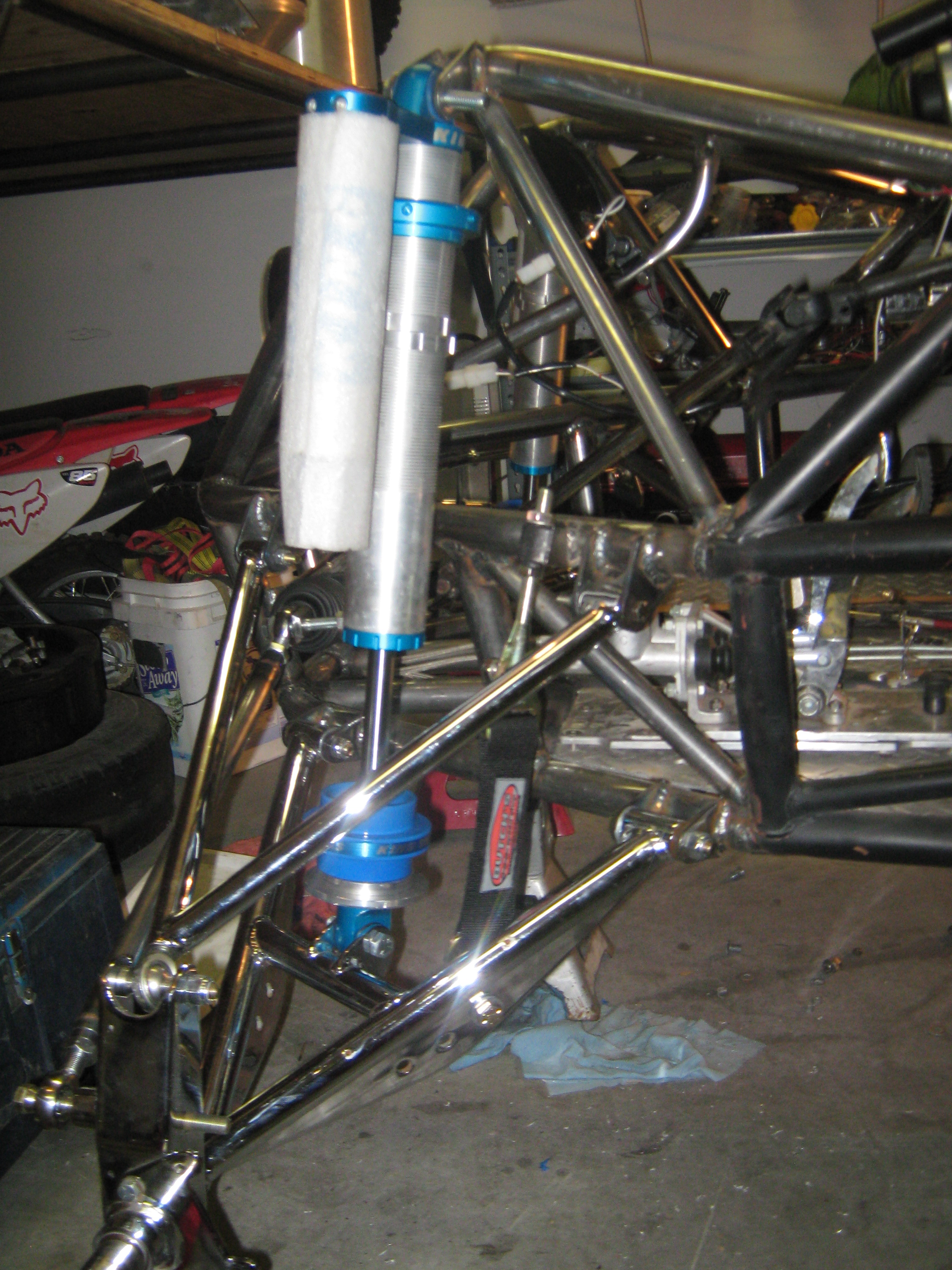

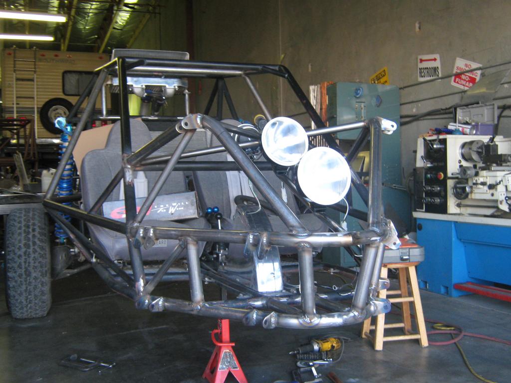

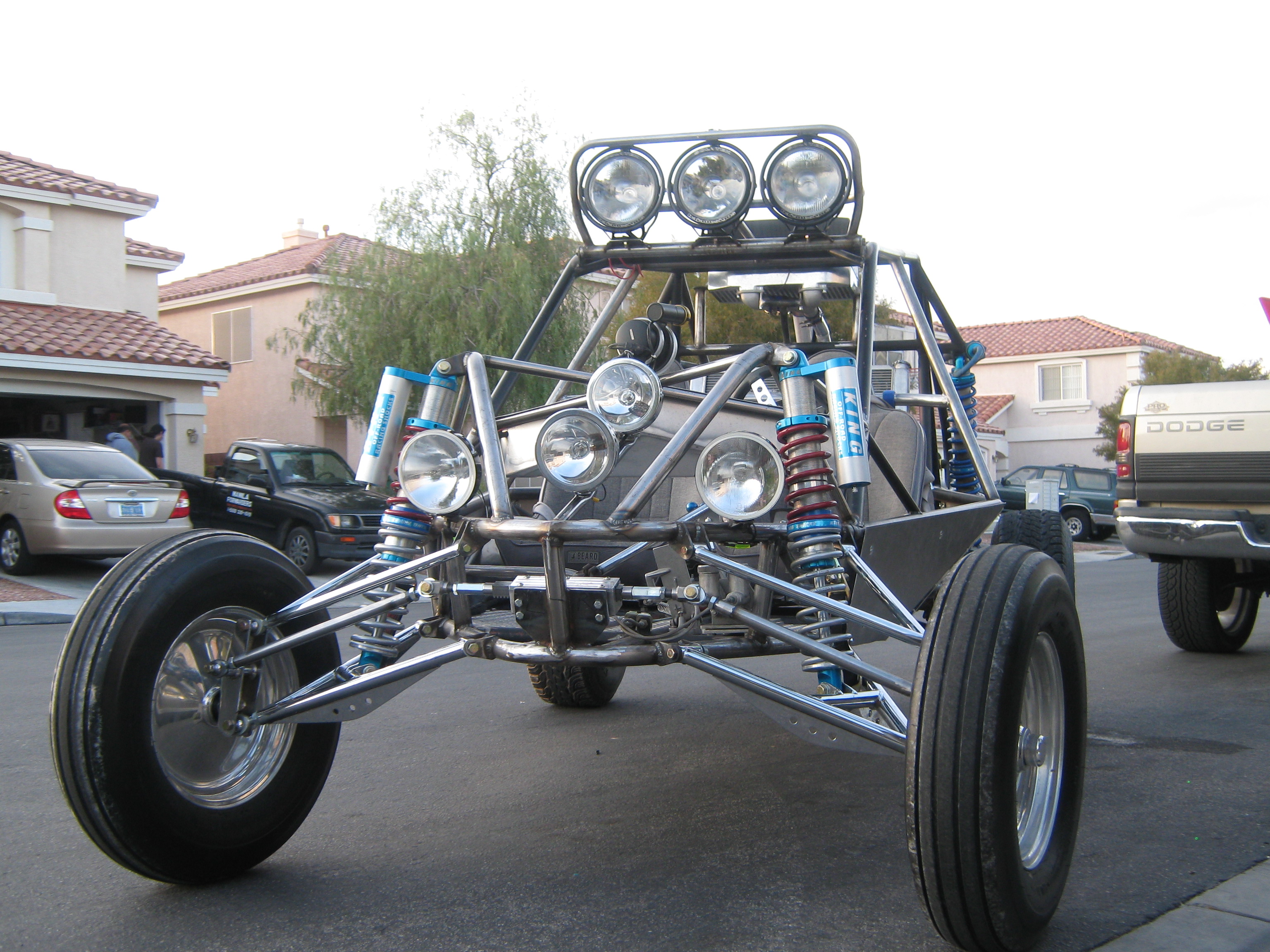

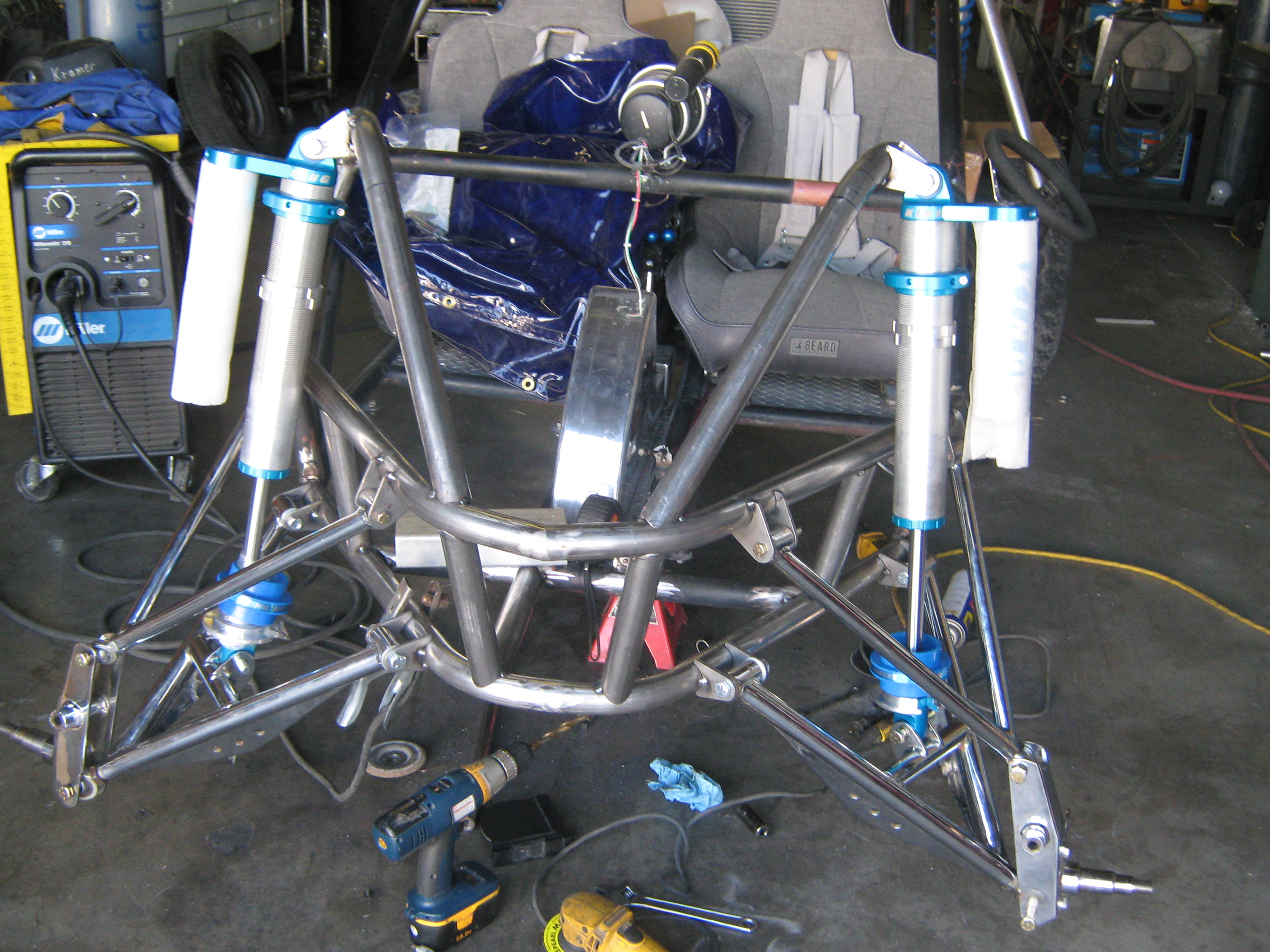

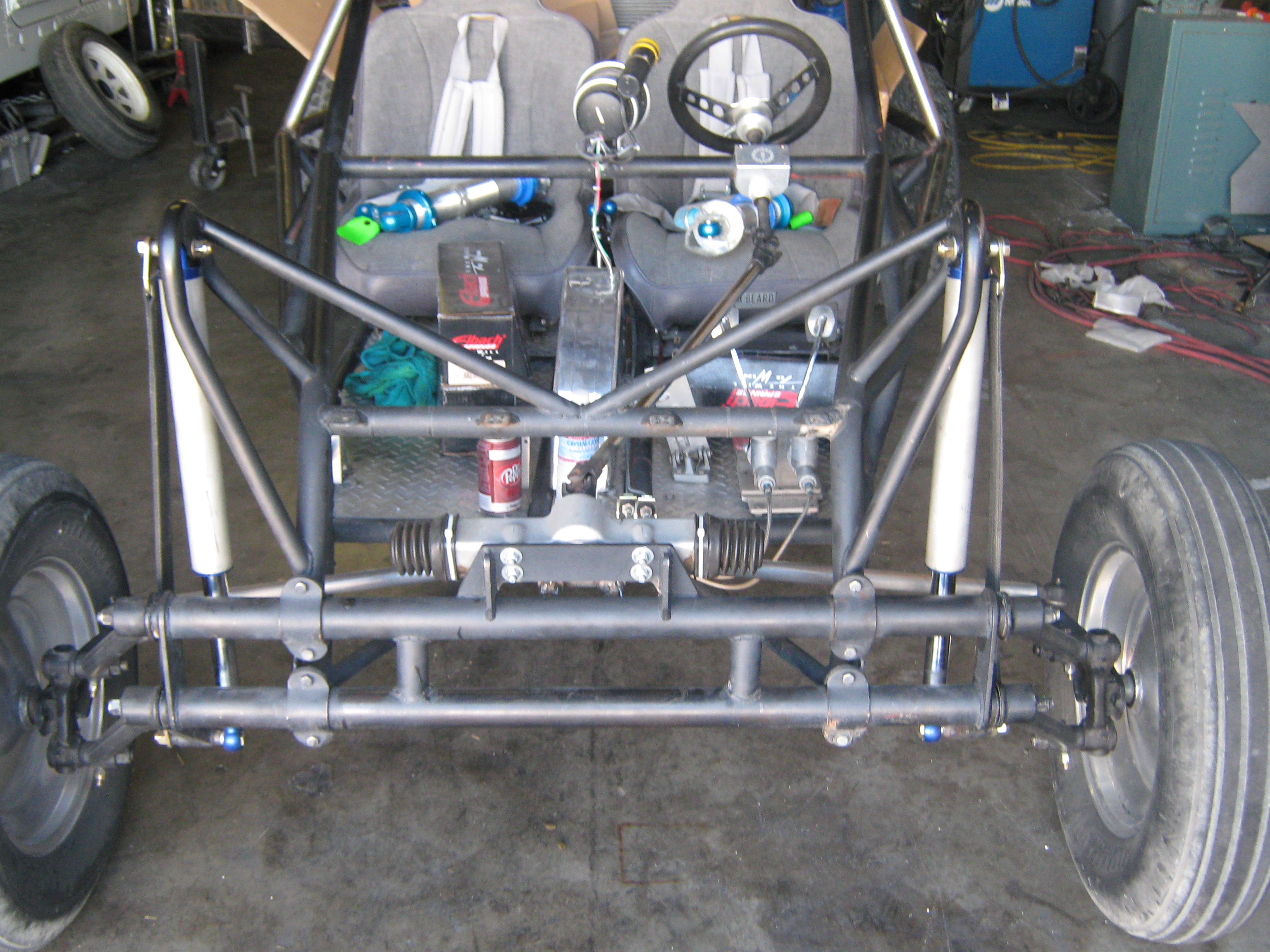

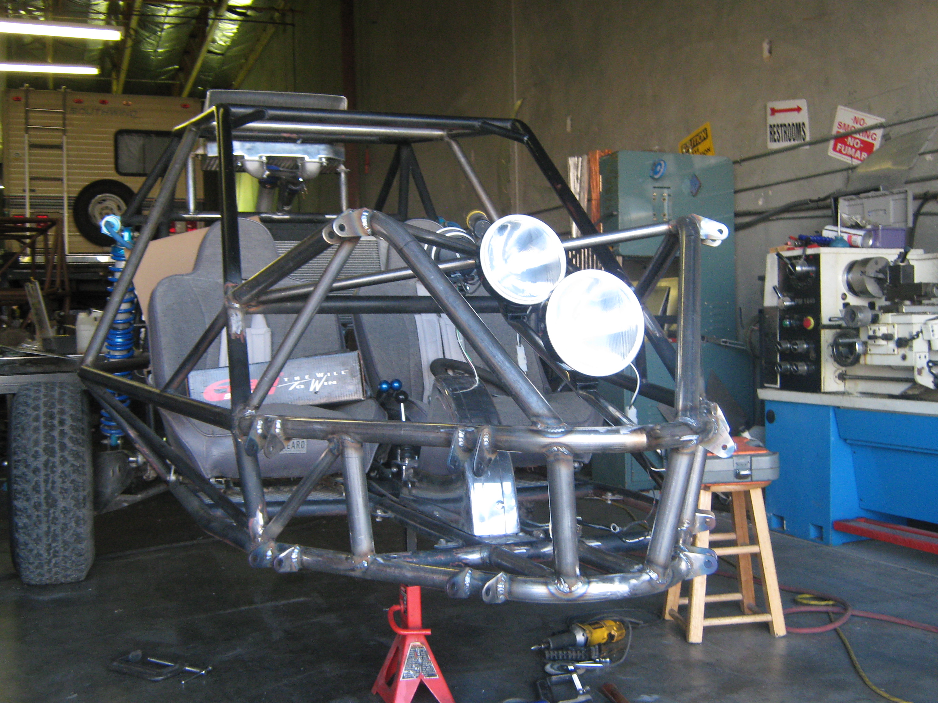

As everything always snowballs we couldn't stop there. I had picked up a set of used Funco A-arms and spindles for a great price a while back. Also a set of 10in 2.5 king piggybacks. All that was left was to chop the front of the car off and make this work. Justin did a great job and had it done quickly, I'd recommend him to anyone. Adding pics to next post.

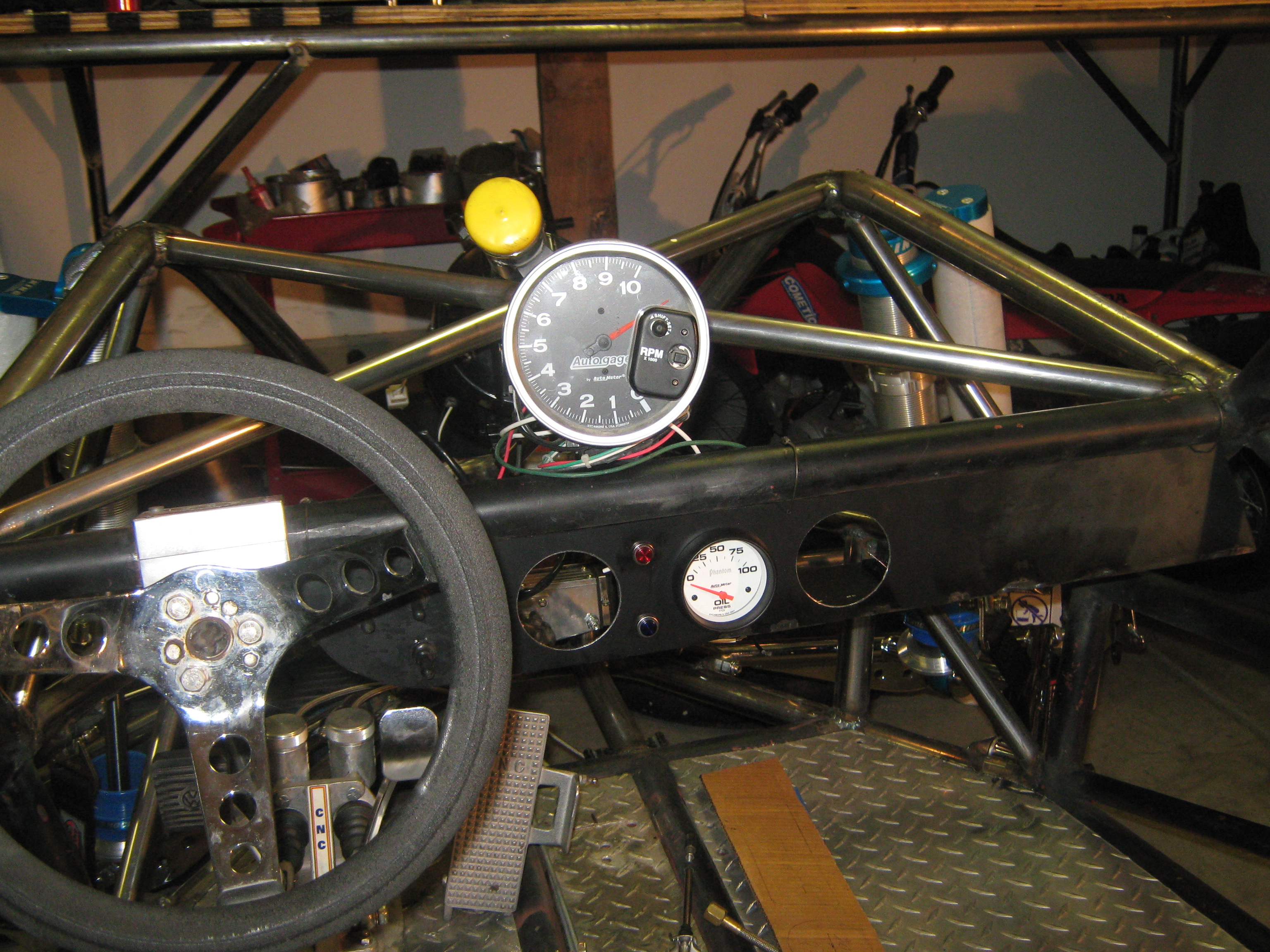

This week I added the limit straps and adjusters up front and finally decided on where all my gauges and switches were going. I used to have a 3 gauge center box but it was too low to be watching while duning and switches were not in my reach while strapped in the seat. So this is where they are going now, this is kind of just a mock up until I have cash to have it all done in aluminum, also the other gauges are on order.

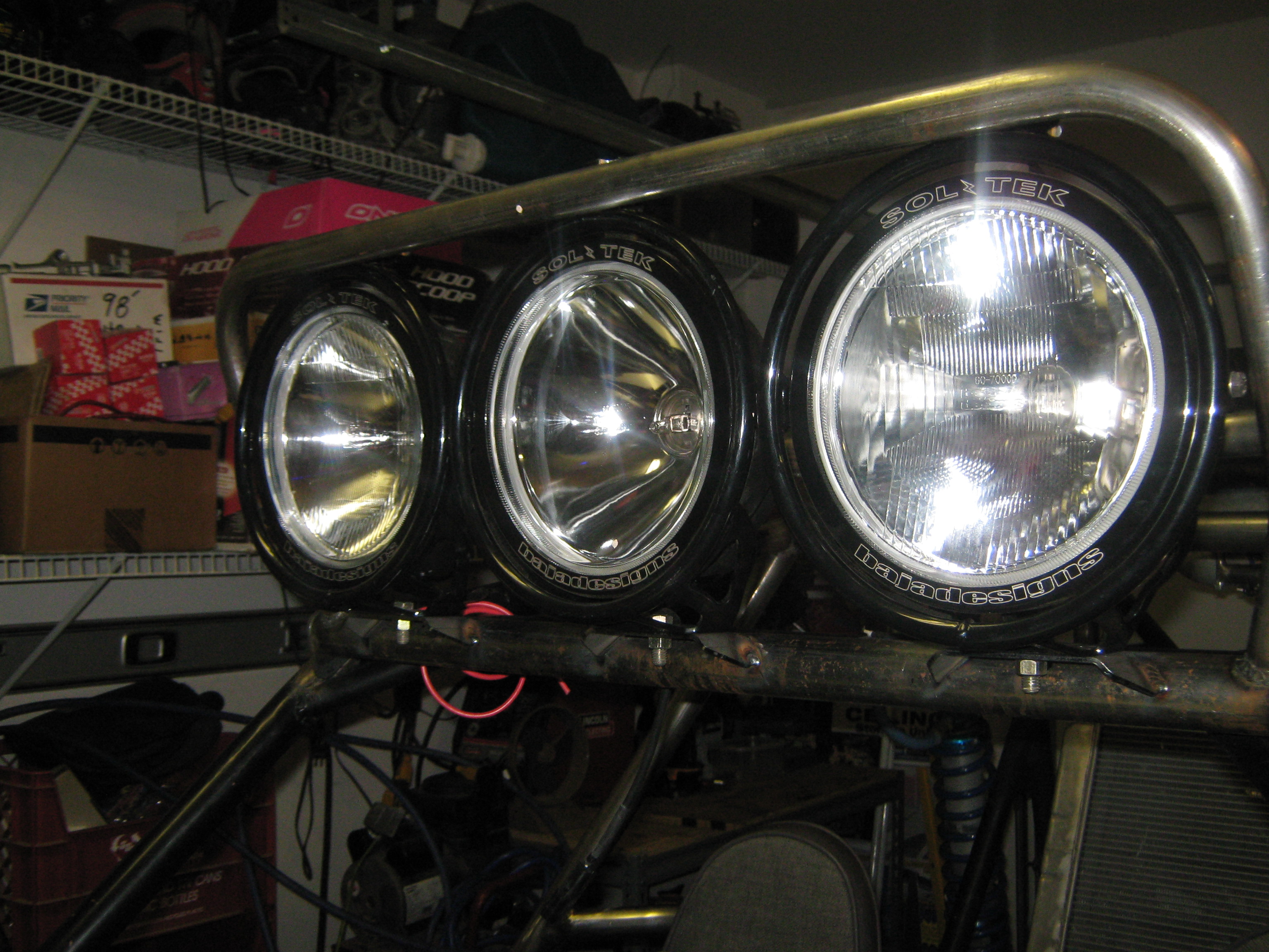

Haven't done too much lately but work on the dash. It ended up being more fun and a little less cash to do my dash myself. Only thing I paid for was for someone to tig weld the 2 upright sides on the lower box part. I still have to place all my switches where I want them and some idiot lights. So inside will be a fuse panel and a few relays for the lights. A While back I picked up a set of front tires and rims and also added an adjustable light bar and 3 HID's, one is off being repaired.

It looks great. One thing I noticed is you don't want the bottom of the front tire coming up higher than the bottom of the front end. That could cause some major problems. If the front suspension compresses all the way and the front end digs end you can get hurt pretty bad. Just my thoughts.
Don, It's all good bottomed out with no springs on at full compression with the tires I have on there I still have 3 full inches of ground clearance. LOL no way I wanted to be laying frame with my front end! Thanks for looking out and the input, keep it coming. I have 4 children thhat ride with me in this car so if anyone sees any issues that need to be addressed feel free to post up. This is a learning process and my first sand car so I love everyones insight.

Added the idiot lights and all my switches today. So this is pretty much finished except for adding another switch for something later and a cigarette/12v source socket and plumbing the inside. Should be real close to all buttoned up this weekend I hope.

Also worked out some bugs with some mean bump steer in the steering. Now it is cycling 18in up front and close to no bump.

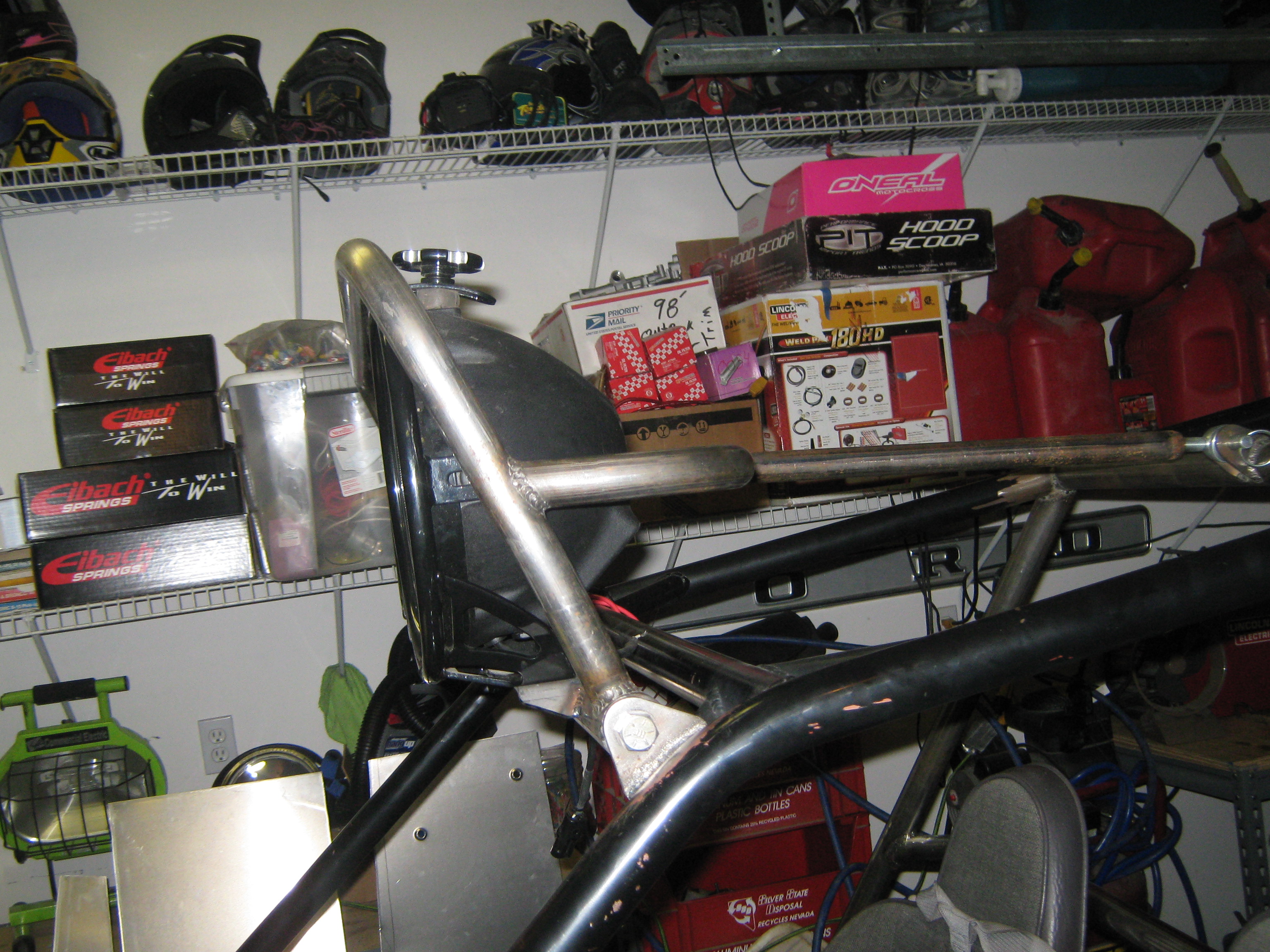

I ended up selling my Pro Comp HID's and buying 2 pencil and 2 flood Baja designs that I'm converting over to HID, I used my lightbar I built for the other lights with moving the tabs and rotating it a bit.
The last pencil will replace the 2 pencils I have in the center of the hood area.
Today,Justin (that did my front end) and I finished up my side panels, all that is left is some bead rolling and I need to buy some more aluminum for my roof piece.
