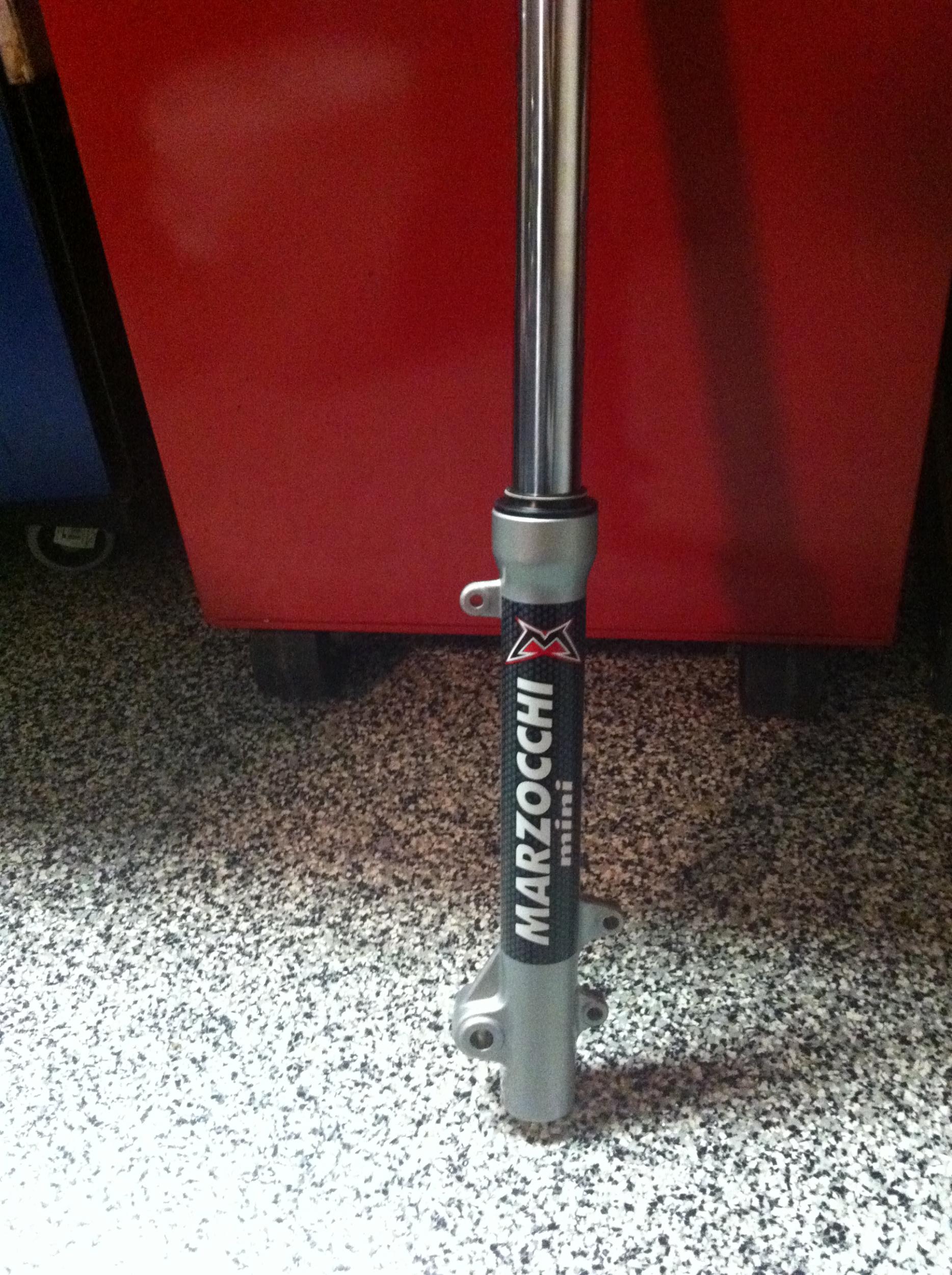

I've already started collecting odds and ends. Saw a decent deal on these NOS Marzocchi forks and grabbed them:
post-3304-0-51653300-1336635116_thumb.jp
Which brings up the first question: Is there a big difference between running them as leading axle vs. trailing axle? I know the theory is that they should handle differently, but I don't know if it's noticeably different. Right now, the axle is set up as trailing, but I think I want to go leading just to gain a little clearance from head to tire.

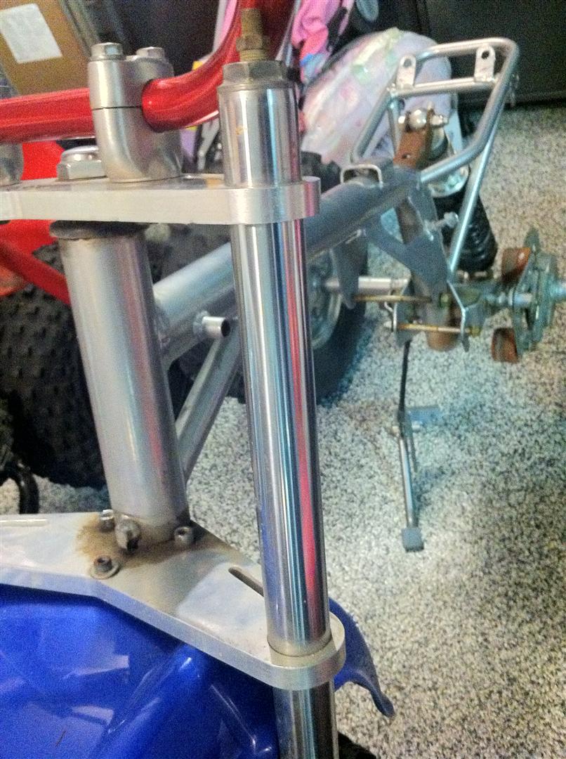

Here's the forks that are on it now: A little long, and not cycling very smoothly. Anybody know the diameter of the forks that originally came with the A+? I've seen them run XR80 forks, which are 27mm, but these are 30mm. (the Marzocchi forks are 32mm)

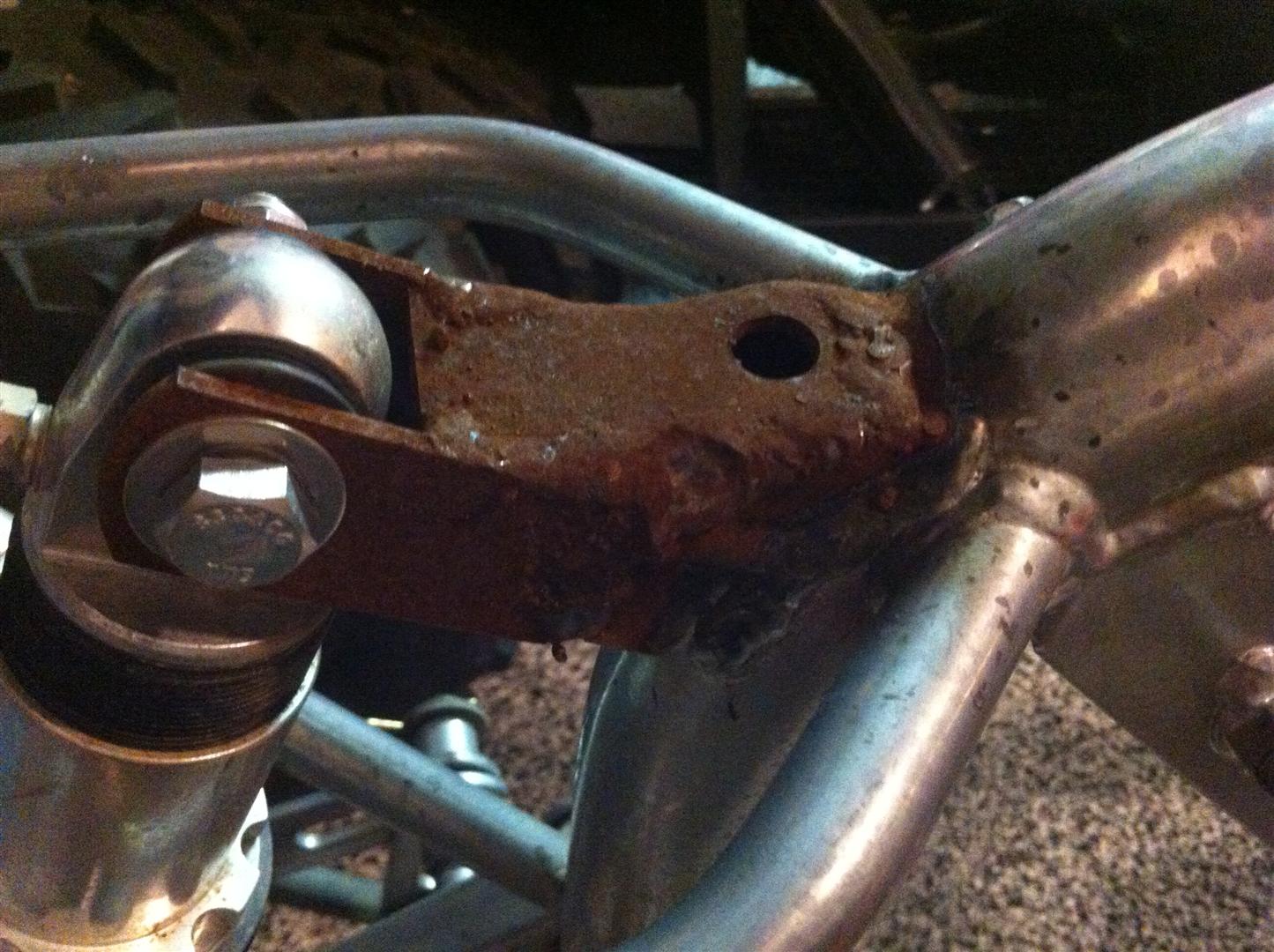

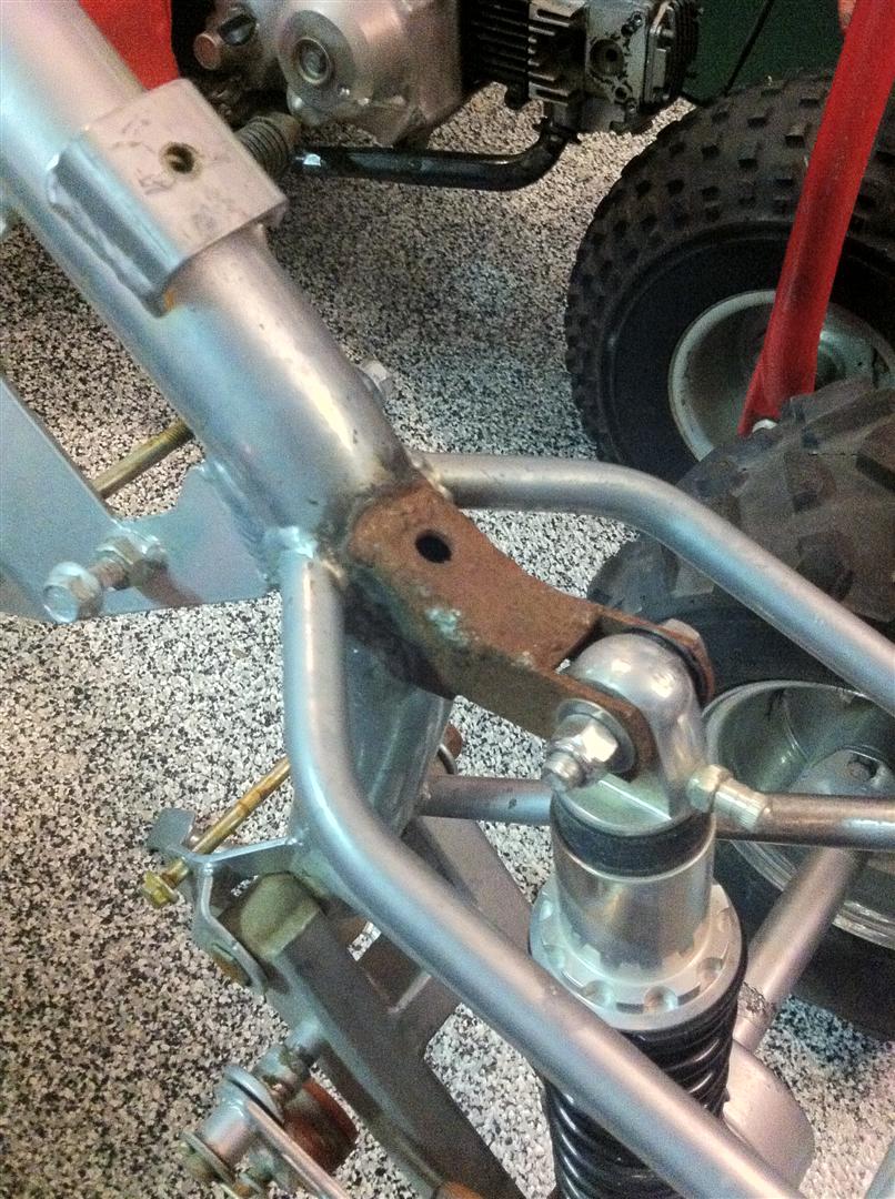

The frame is already powdered, but the rear shock mount looks like it was re-welded afterward. Gonna need to be cleaned up and then I'll see if it needs to be remade. Hopefully it cleans up ok. If it needs to be done again it will be too tempting to cut it up to extend the frame a little.

Leading axle = more rake and quicker, twitchier turning...some times too quick and twitchy. Trailing axle the opposite. Good luck, looks like a sweet project.
