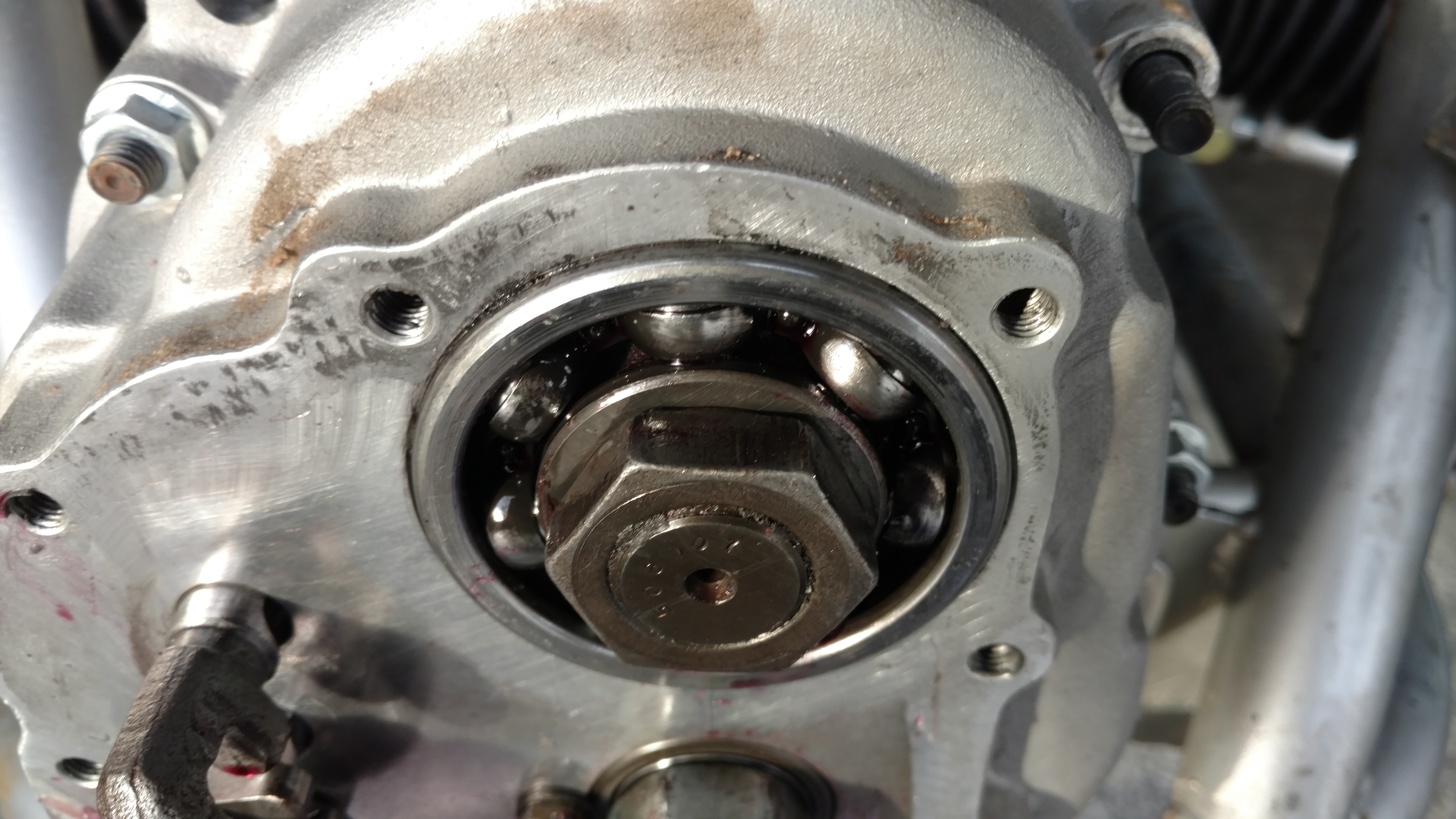

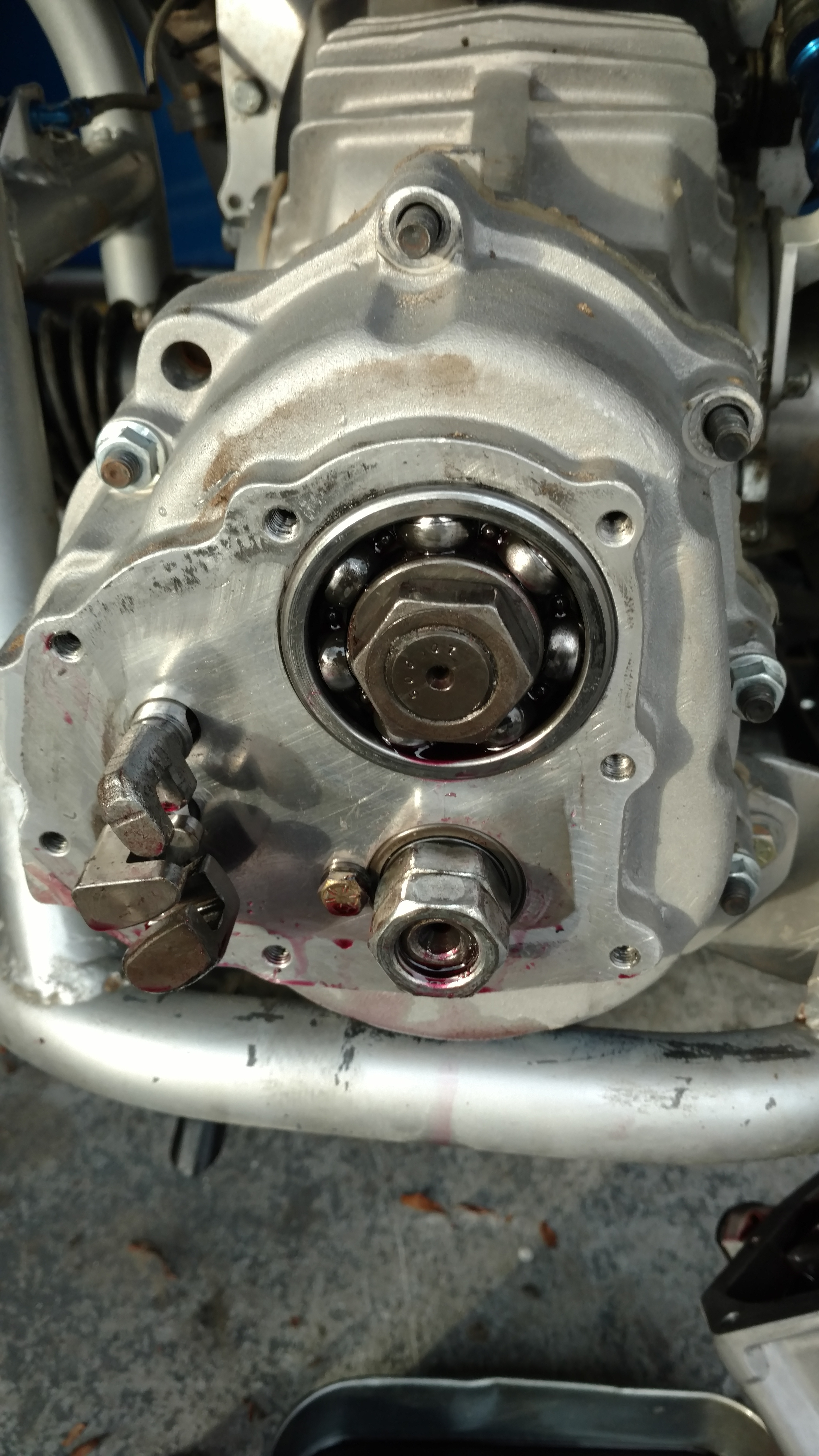

Step 1: Remove the rear shifter cover. This is what you'll see.
Step 2: Using an impact gun, remove this nut.

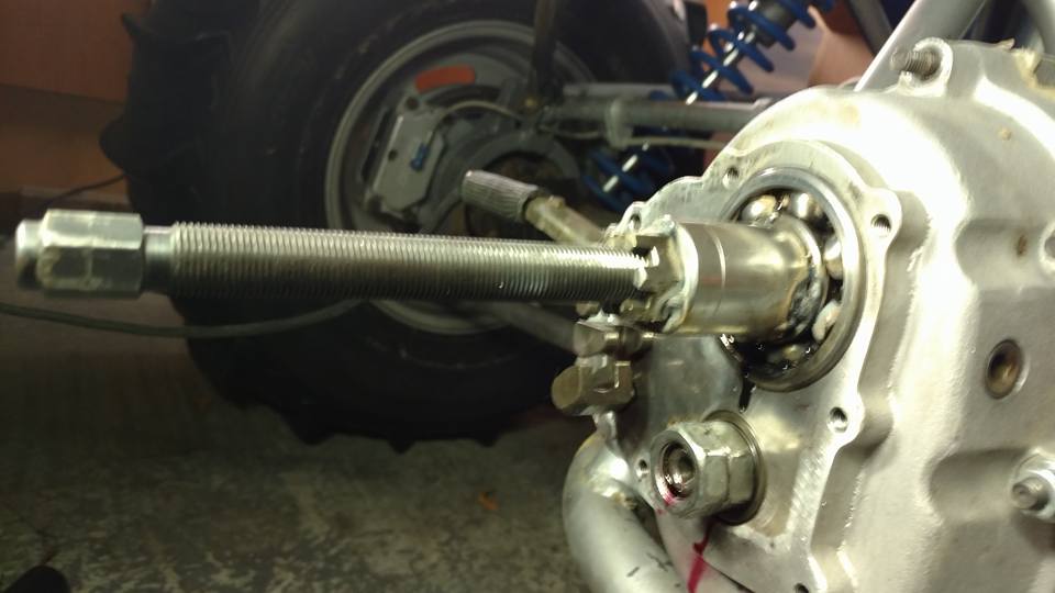

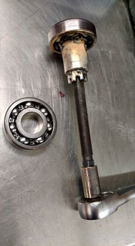

Step 3: Find a 1 inch socket you don't care about, a long fine thread bolt and a nut with the same thread. (I used the center bolt from an old steering wheel puller. I had to drill out the center of the socket to 5/8" so it fit through.)
Weld the nut to the back of the socket and then carefully weld the socket to the inner race of the bearing. Thread the bolt through the nut and pull the bearing out of the trans.
Note: Be careful not to lose the shim that will likely be stuck in oil on back of the bearing.

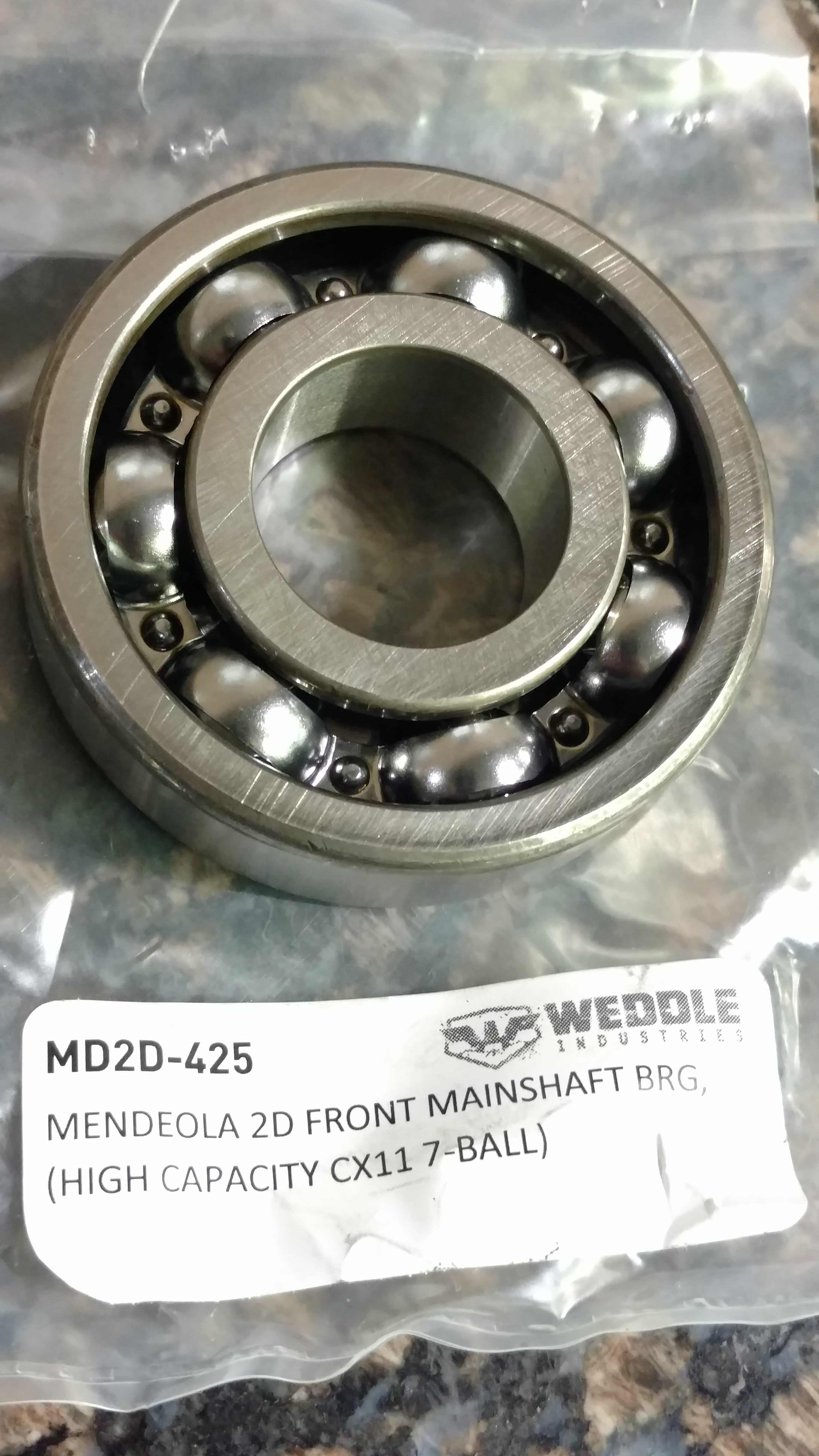

Step 4: Once have your new bearing (gently tap it into the case). With a hammer, use the old bearing and welded puller as a driver to seat it fully into the trans. Install the nut and torque to 78 lb ft.
