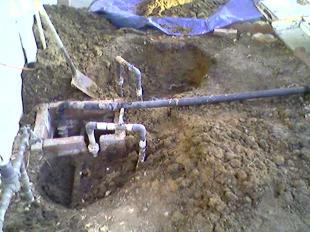

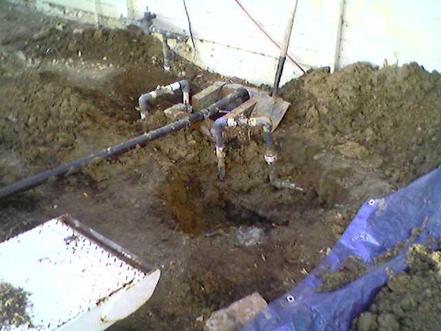

HappyHour Posted December 31, 2007 Author Posted December 31, 2007 it turns out to be something bigger than expected and not just some little pvc pipe issue. Something is a miss underneath my house in the crawl space that has now come to the front of my house. Here are some pics of the digging I did yesterday............ Quote
EY3BA11 Posted January 1, 2008 Posted January 1, 2008 looks like your in for a little fun... right about now would be the time i would call a plumber and let them play in the crawl space.. LOL American home shield is an awesome home insurance.. My folks have it on all their homes.. and a 35 dollar deductible is all you pay to have someone find and fix damn near any problem.. With us growing up in manufactured homes things break constantly so the insurance has more than paid for itself.. Quote
