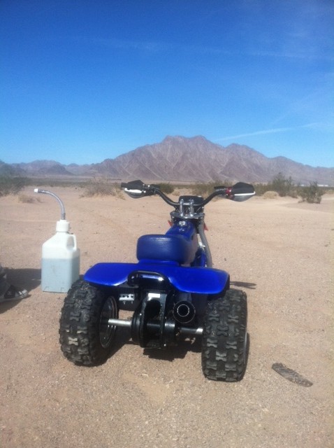

JVZ Posted January 31, 2012 Author Posted January 31, 2012 At last, project is complete. I took it out to the Dry Lake bed for a little test and tune shakedown and it definately rips! Im amazed at the difference in power and the fun factor just tripled. The project definately required more time, parts, and trial and error than I anticipated but was worth it. A couple of things I learned along the way, the Cobra under exhaust does work and will clear the starter (also sounds great). The chinese carbs that come with them are not very good quality. The one I received had a stuck slide right out of the box, bowl leaked, and lost the screw on the choke plate (not while it was running thankfully). So I ordered a Mikuni VM 20 carb which I was told was actually bigger than the Chinese 22-24mm carbs (Hondaatc70.com), I put the Mikuni on and it is not only easier to tune, makes it run better, but it give the tank more clearance. I put the new motor in with the carb and manifold spacer on and still cleared the tank. The only thing I had to do was bend the reserve fitting on the tank straight down. No hammering, welding or any other modifications. Also, I read that using a hotter plug NGK C6HSA is better and should eliminate any fouling issues, which I do have. Im putting the new plug and will retest, so we will see. Quote
andydew Posted January 31, 2012 Posted January 31, 2012 At last, project is complete. I took it out to the Dry Lake bed for a little test and tune shakedown and it definately rips! Im amazed at the difference in power and the fun factor just tripled. The project definately required more time, parts, and trial and error than I anticipated but was worth it. A couple of things I learned along the way, the Cobra under exhaust does work and will clear the starter (also sounds great). The chinese carbs that come with them are not very good quality. The one I received had a stuck slide right out of the box, bowl leaked, and lost the screw on the choke plate (not while it was running thankfully). So I ordered a Mikuni VM 20 carb which I was told was actually bigger than the Chinese 22-24mm carbs (Hondaatc70.com), I put the Mikuni on and it is not only easier to tune, makes it run better, but it give the tank more clearance. I put the new motor in with the carb and manifold spacer on and still cleared the tank. The only thing I had to do was bend the reserve fitting on the tank straight down. No hammering, welding or any other modifications. Also, I read that using a hotter plug NGK C6HSA is better and should eliminate any fouling issues, which I do have. Im putting the new plug and will retest, so we will see. No joke. I've been shaking mine down as well. Found a loose ground connector causing all kinds of headaches. So much fun though! I was attempting a donut in some gravel and about 180* into it, the tires caught some traction, and I wheelied it nearly into my fence . Definetly has more power...maybe too much for me apparently Quote
JVZ Posted January 31, 2012 Author Posted January 31, 2012 Yeah they are some crazy lil drifters! I just re- did all of my grounds because I was worried they would come loose Quote
