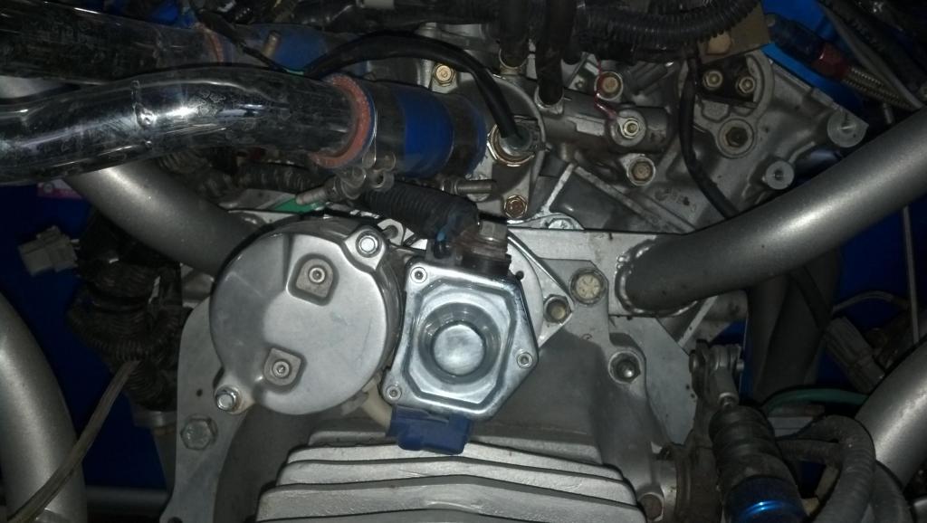

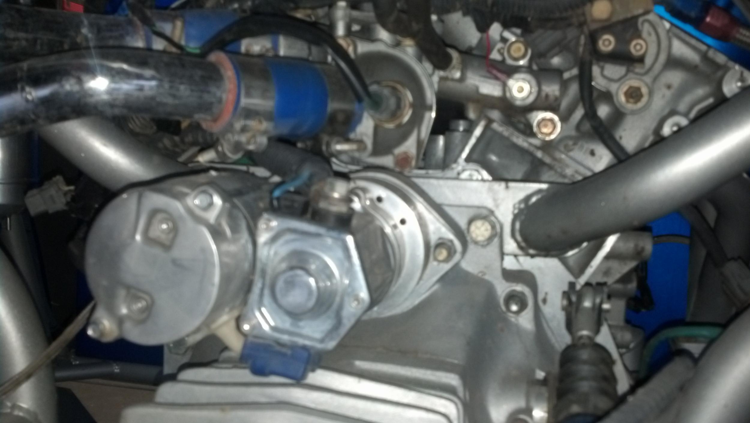

FireKracker Posted September 11, 2013 Posted September 11, 2013 So I have been running a Honda 3.5 with a 091 built bus and made the jump to a 2D (actually a DECO) ... when I married up the 3.5 with the trans, i came across a challenge.... the starter motor was wanting to occupy the same space as the coolant manifold. So I went to GD.com and did some research and found a few threads on some mods that others have done. I am curious to find out what options I have (what have you done or seen) to alleviate my problem. I am pretty sure someone has one of these manifolds laying around or knows where I might find one....thanks Quote

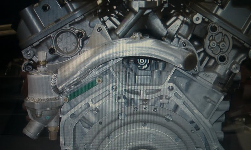

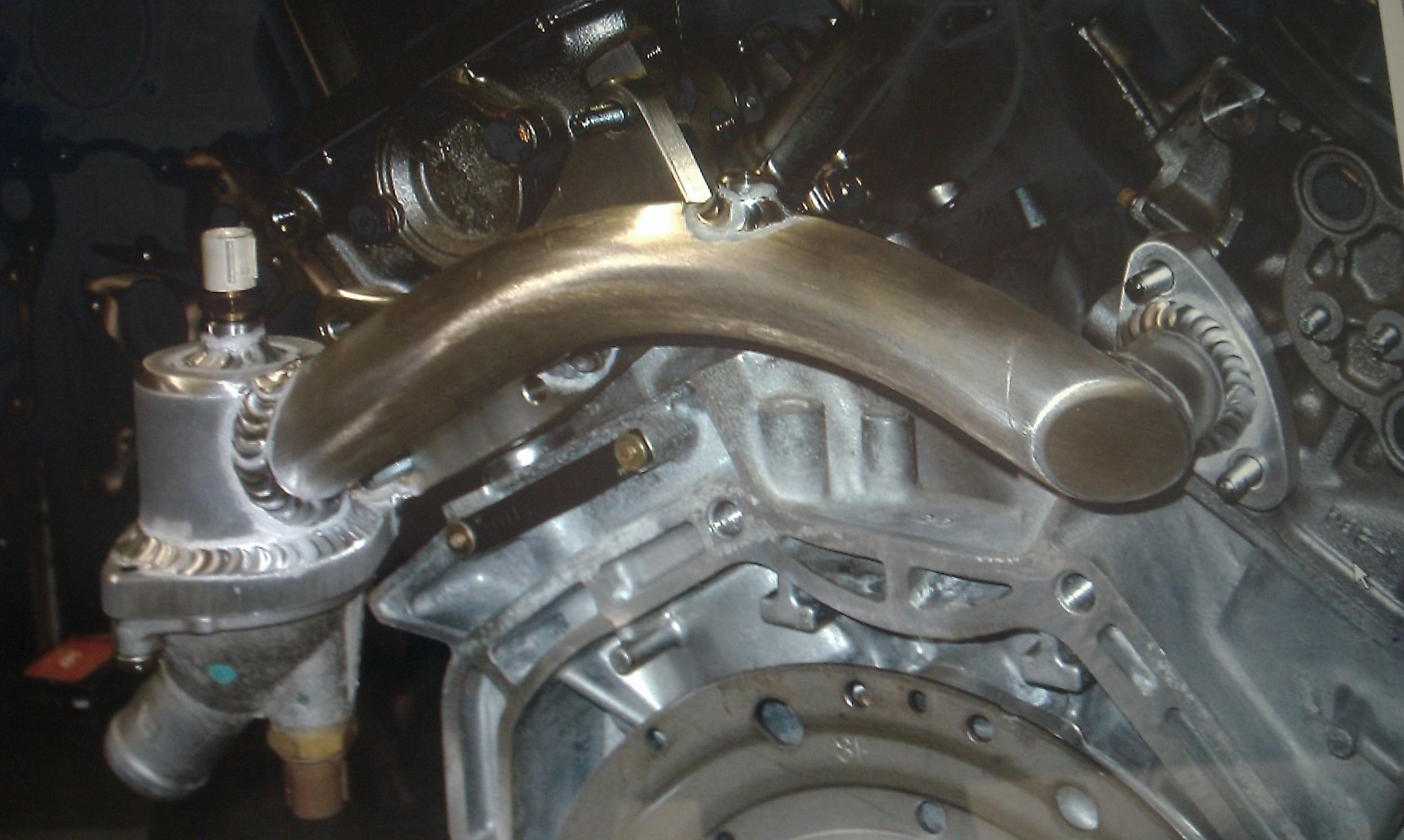

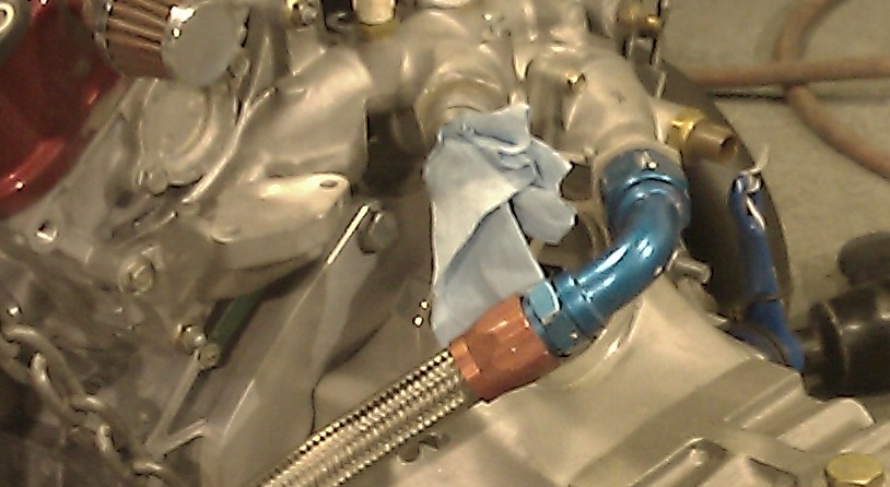

FireKracker Posted September 11, 2013 Author Posted September 11, 2013 First pic is what I have, other two are mods that others have done Quote
SAND~~SNAKE Posted September 11, 2013 Posted September 11, 2013 Rees, I do not have the modified piece in the 2nd and 3rd pics, I do have the piece in #1 pic and my starter cleared it fine. You are more than welcome to come look at it if it gives you as idea? Quote
FireKracker Posted September 11, 2013 Author Posted September 11, 2013 are you running a high torque starter.... if so, I gots ta see how ........PM'd you my cell Quote
SAND~~SNAKE Posted September 11, 2013 Posted September 11, 2013 yes I am I reclocked it...call you tomorrow....enjoy the show! I was lost ? Quote

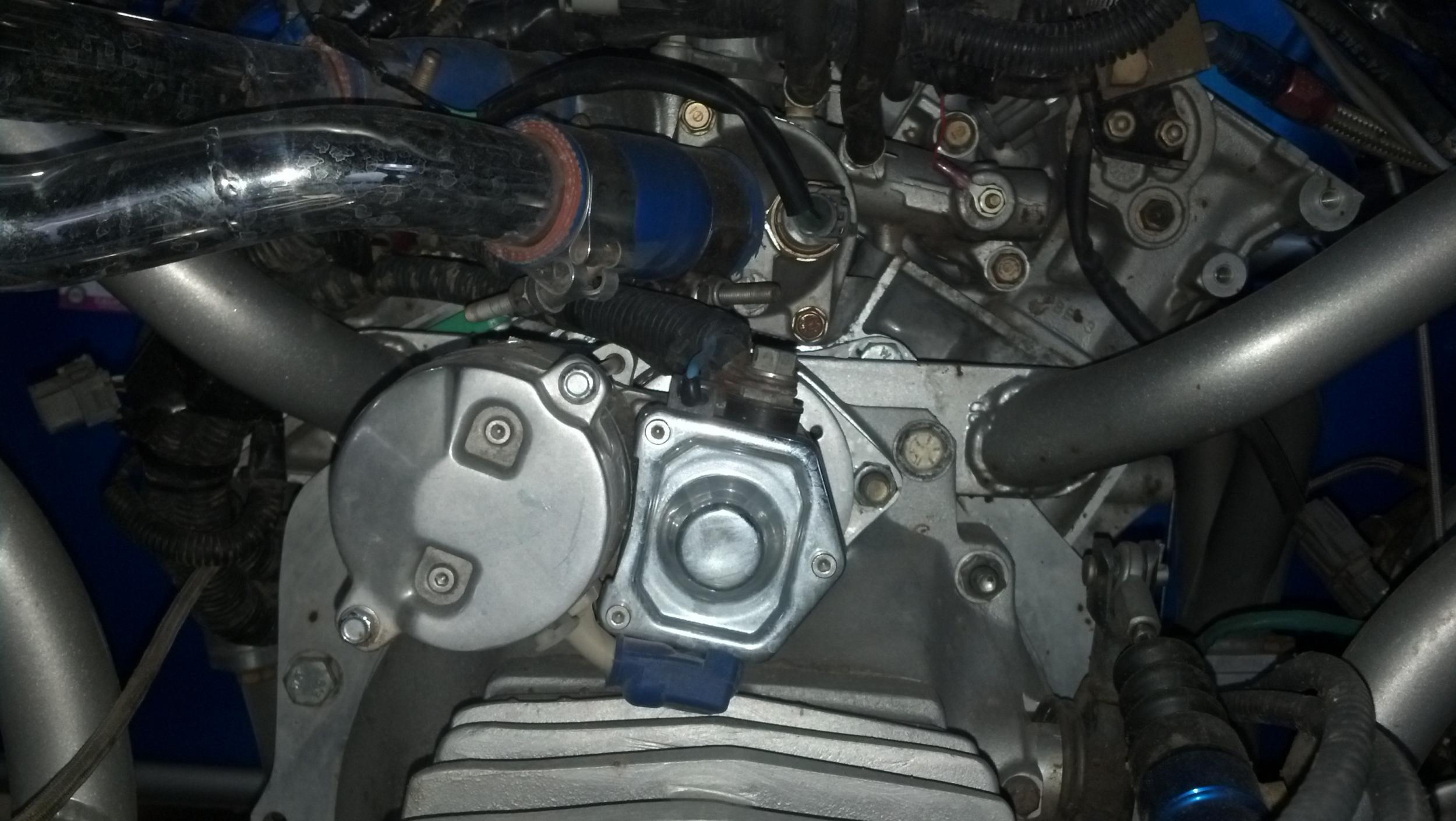

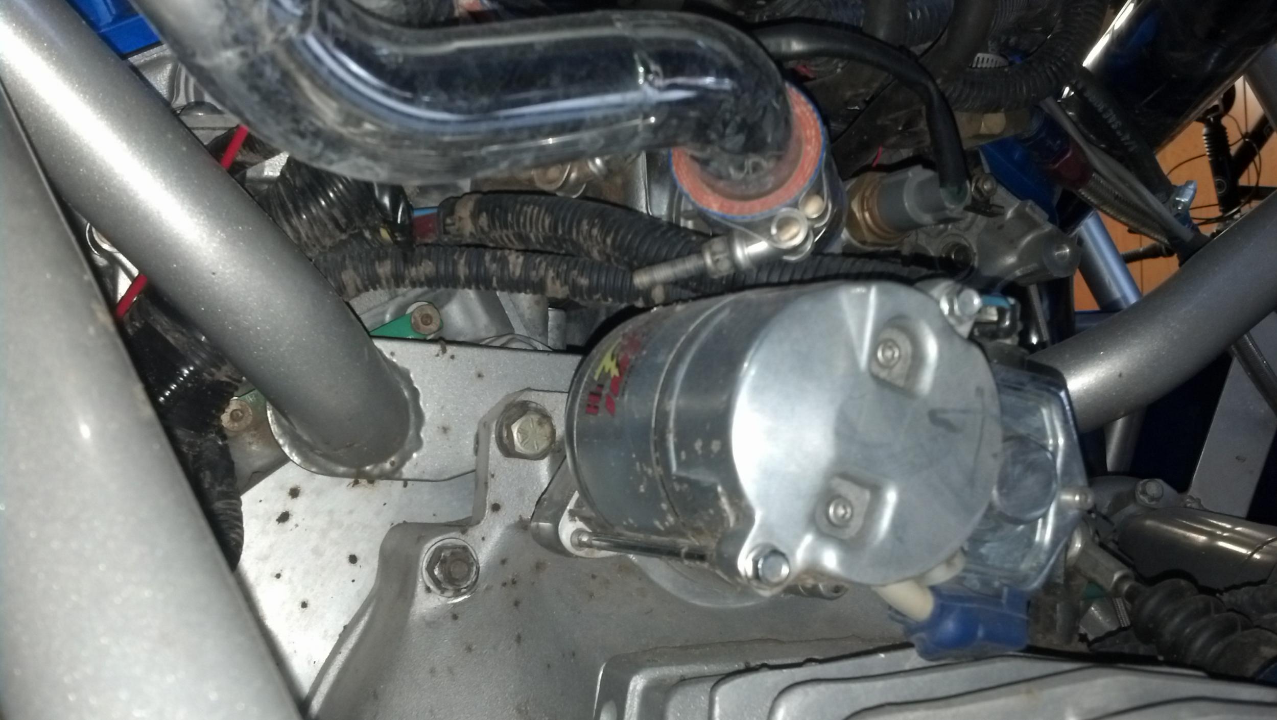

dunefreak Posted September 11, 2013 Posted September 11, 2013 Hey Rees, I got your message yesterday. Forgot to call ya back though. Sorry! Anyways, here's what mine looks like. It's a bit different than your setup. Quote
FireKracker Posted September 11, 2013 Author Posted September 11, 2013 Pete, is that a 3.2 or 3.5 ?? .... is that a gear reduction starter? The starter that I bought from John over at RC wont clock to that angle....problem possibly solved with a different starter... part #? Quote
dunefreak Posted September 11, 2013 Posted September 11, 2013 3.5. I bought it/ didn't build it so your guess is as good as mine. Well yours is probably better. I haven't even wrenched on it yet. Quote
FireKracker Posted September 13, 2013 Author Posted September 13, 2013 (edited) After seeing Pete's pick, I did a little research and found a starter made by IMI specifically for a Honda and Mendeola application, It is a Hi Torque 101-NL... about 3 bones .... Thanks Jim and Pete for the help!! Edited September 14, 2013 by FireKracker Quote

SAND~~SNAKE Posted September 14, 2013 Posted September 14, 2013 High torque starter 101 nl......nose long. Mendi transmissions does not properly work with that starter, Intermittently grinds....Found after much research and conversations w/John @ outback and Chris at IMI the Mendi was machined 25 thousands out of specs and a SPECIAL ADAPTOR was needed to correct the issue. Quote
FireKracker Posted September 14, 2013 Author Posted September 14, 2013 Super ..... I am using a DECO case...hopefully i won't have the same problem...if so, do you know where can I find that adapter plate? Quote
SAND~~SNAKE Posted September 14, 2013 Posted September 14, 2013 Correction John @ Outfront made his own version and no longer carries, Chris (IMI) machined one for me, After I spent $340.00 with them. Quote
