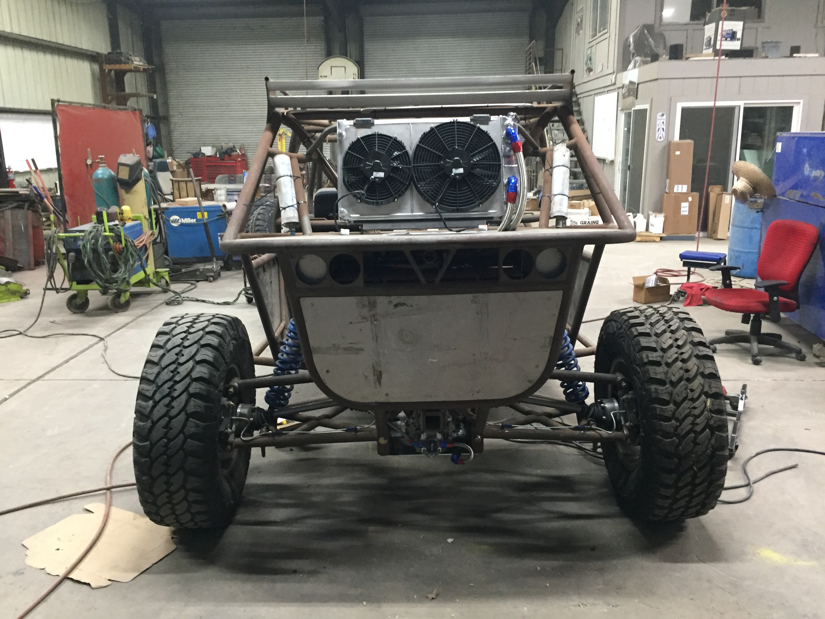

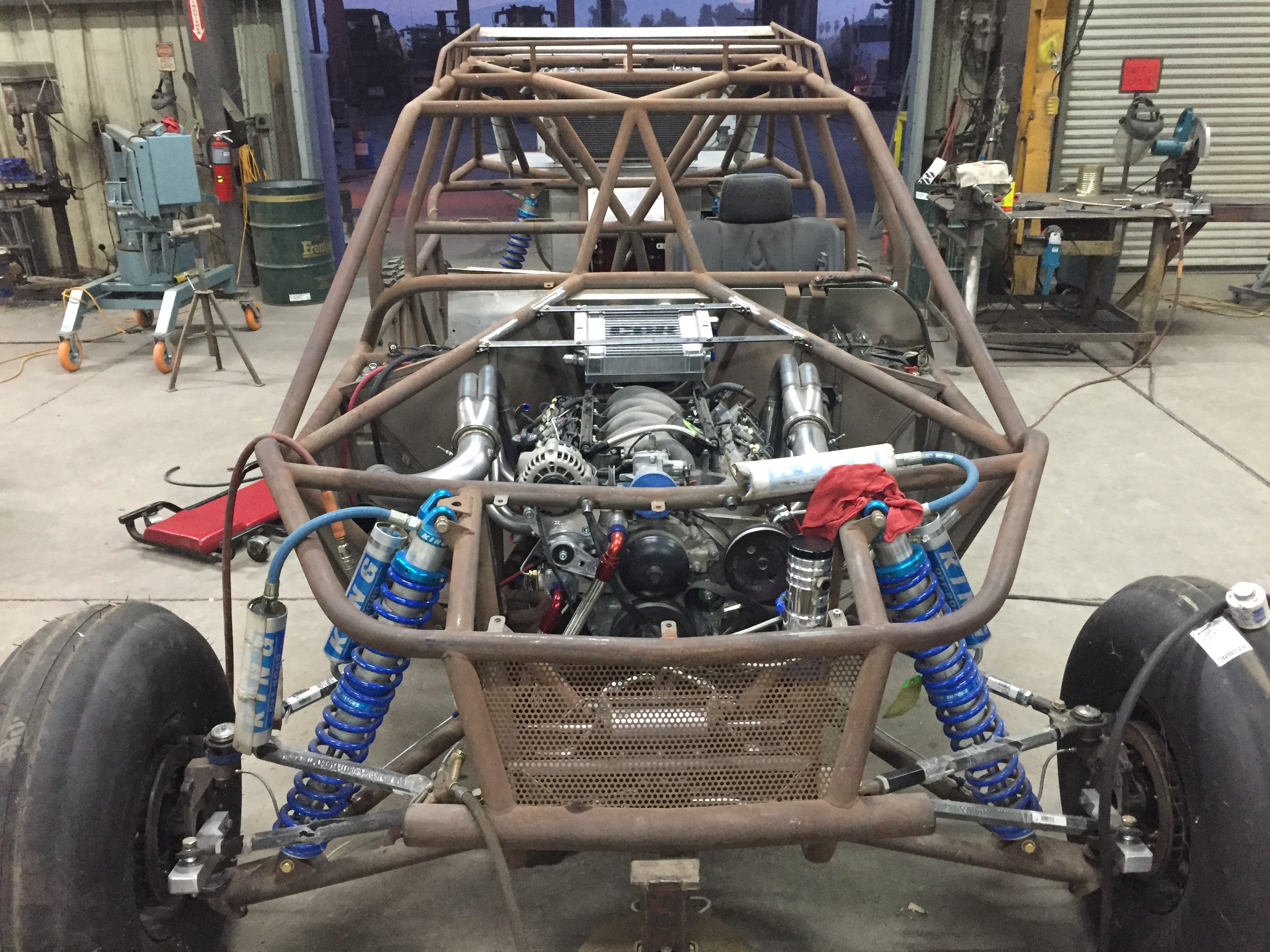

A few more updates

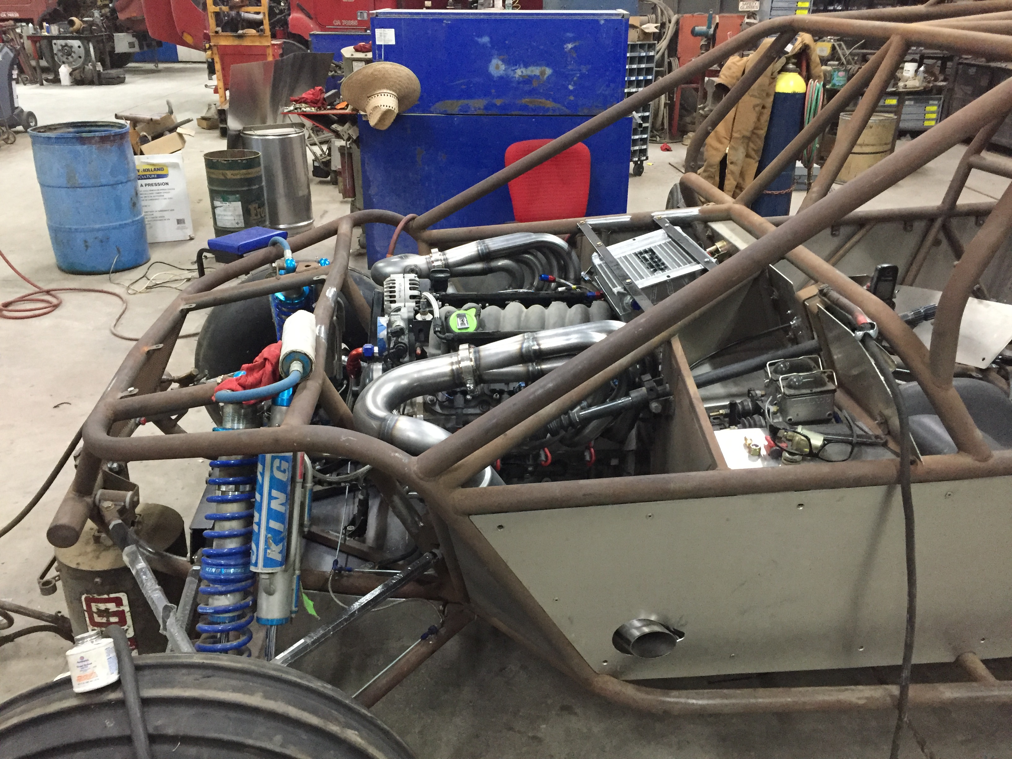

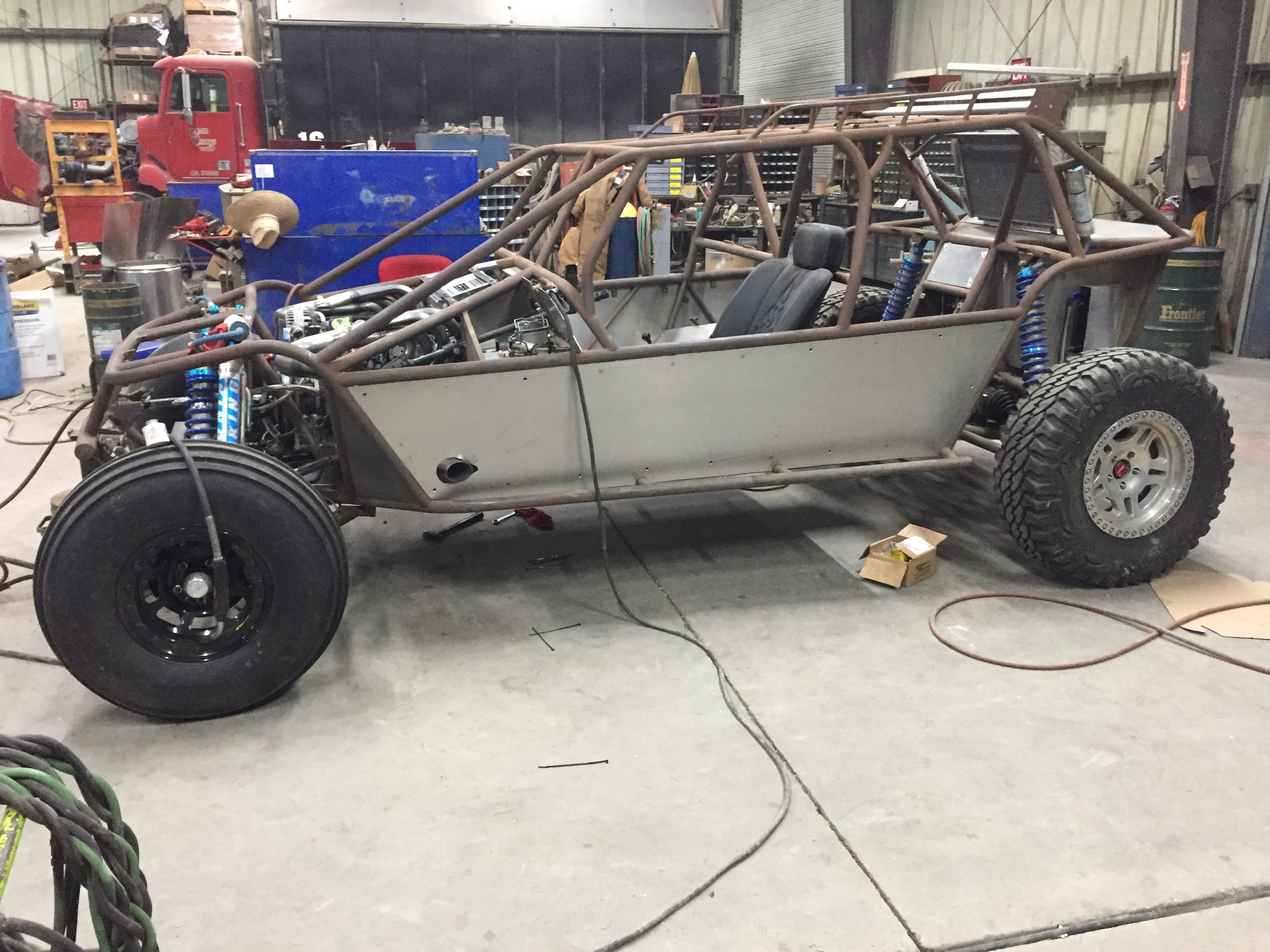

transmission cooler in. Got a different pulley from cbm for the tensioner.  Helped to put a shorter belt on and now the belt doesn’t rub itself. 03789412-A6FD-4E10-AA98-C3B1D911FD78.thumb.jpeg.468c85ee2689e21f1562f8ea9cb0931b.jpeg
Radiator mounted and lines hooked up. I had to make a short hose for suction on the quick change oil line. The fitting I had in there hit the skid pan so it had to go.
Got fluids all in.

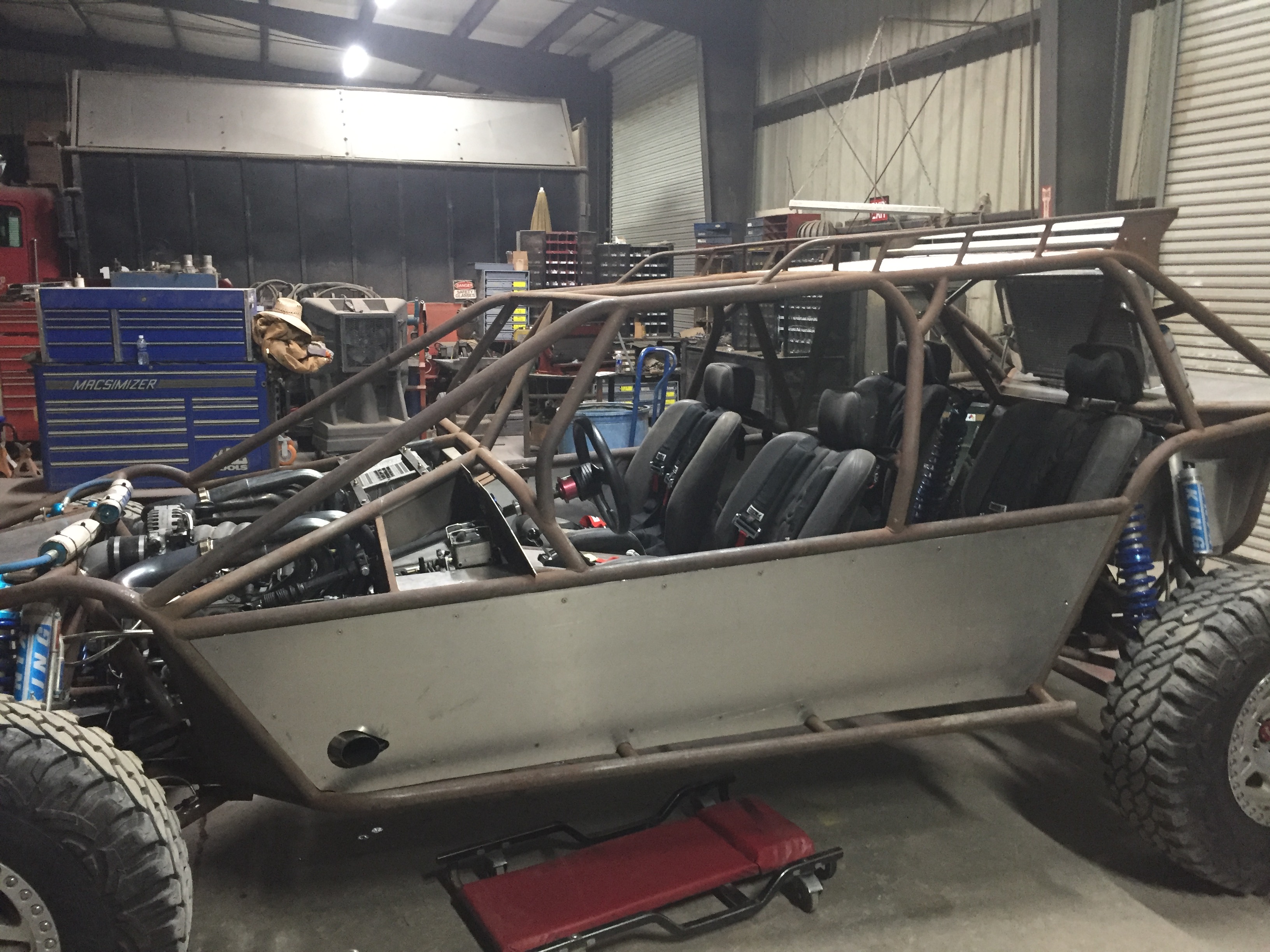

Limit straps done done in the rear. 9D648354-AE2A-40CD-9198-EBE6A604F4FE.thumb.jpeg.bc48cadb8754dafee190b642522814fc.jpeg53F82CDB-C08A-414E-AD2A-3D18944AF21C.thumb.jpeg.2286043acf07bca2570ae7932816bbb4.jpeg
Seats all in. Panels on. All shocks on and charged with nitrogen. With these headers the spark plug wires no longer hit. So that’s something I didn’t have to change in the end.
I had to fight like crazy to get the air bled out of the cooling system. Got it though. The car uses 5/8” studs instead of 1/2”. So I had to drill out the pro comp wheels. Man was that a job. I don’t have a mill, so I had to rig up a way to do it in the drill press. Finally got it. Took the better part of the day just to do that.
Got in a little seat time around the yard. Feels good.

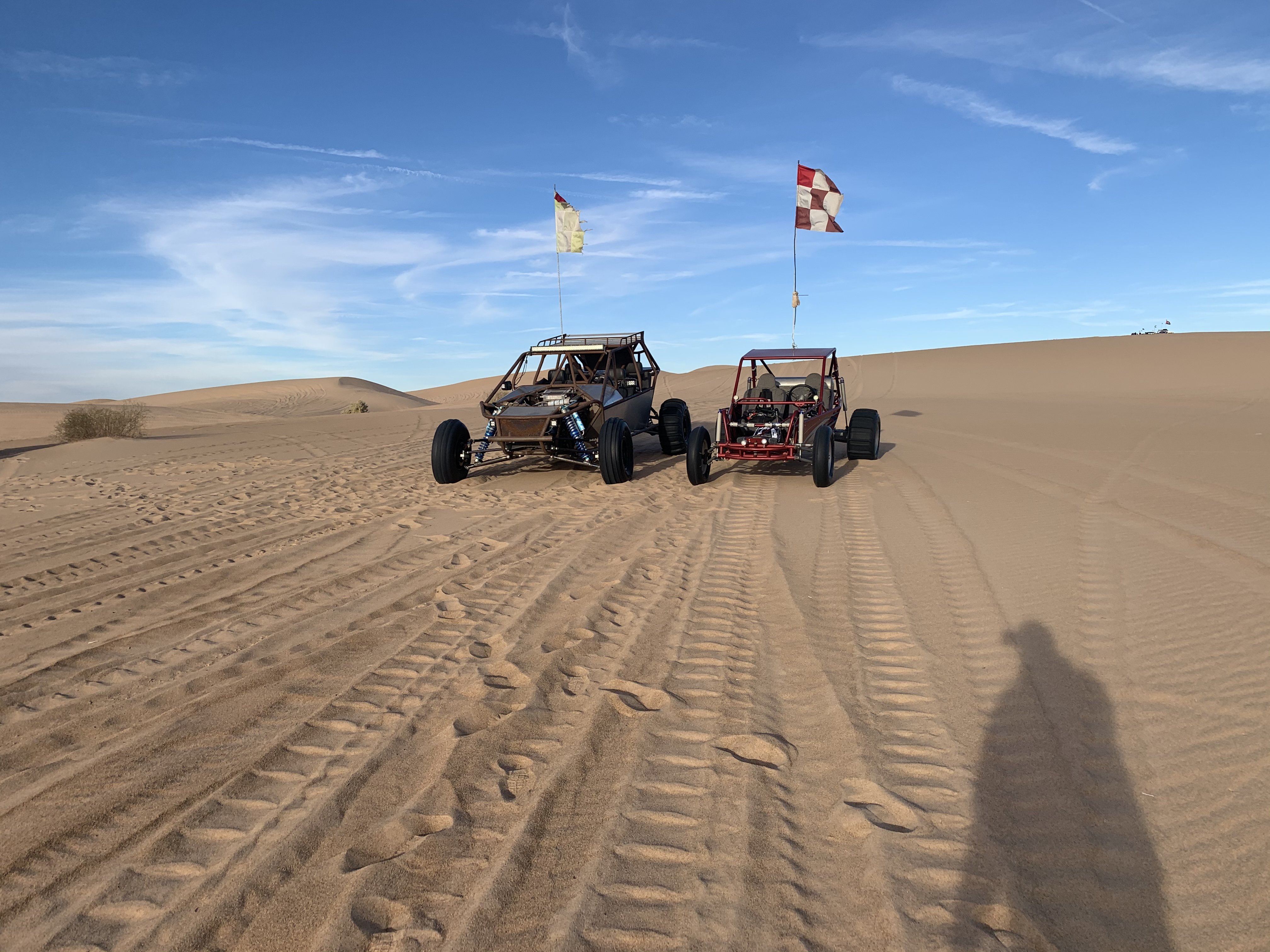

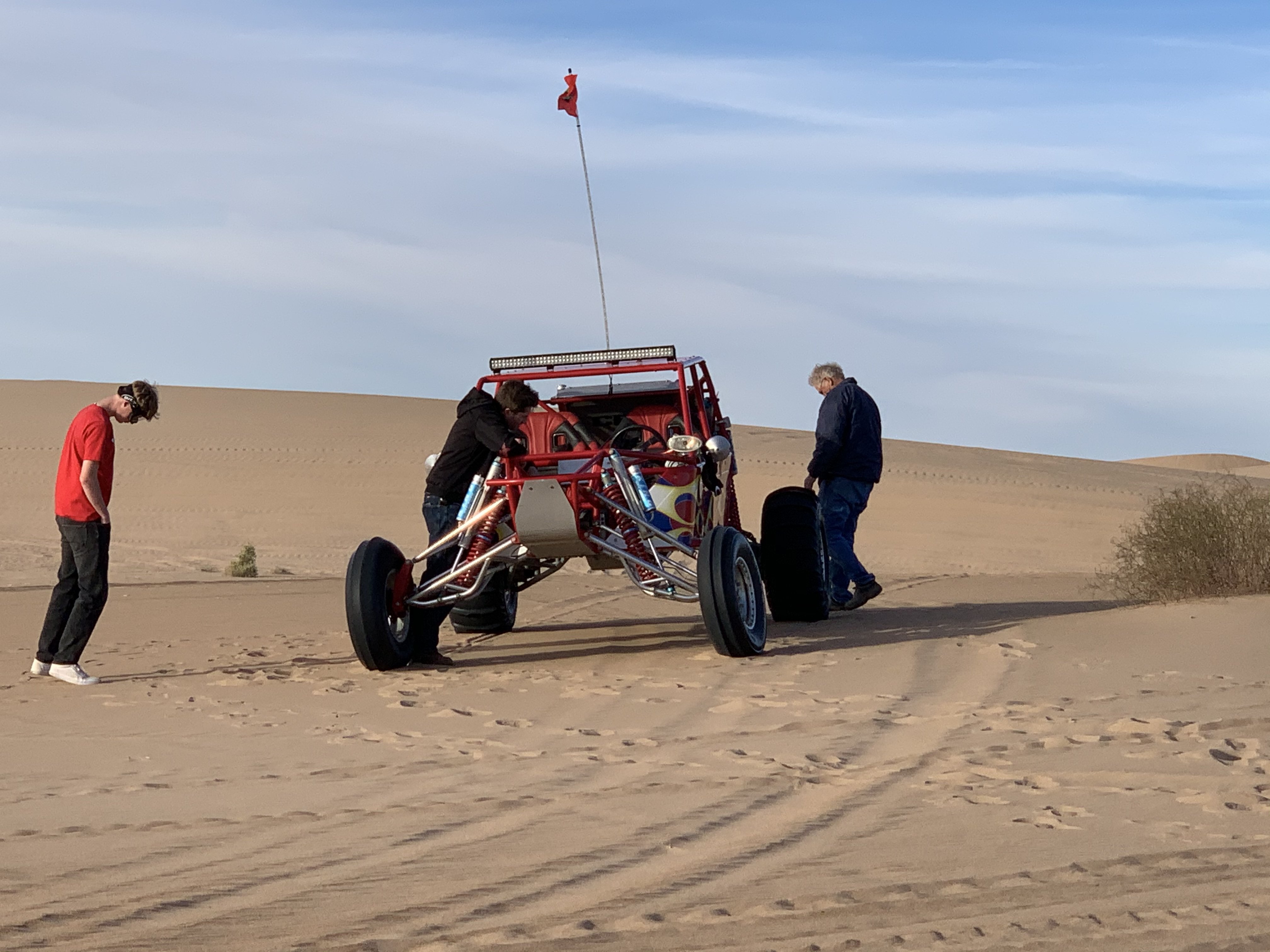

I did get out to the sand. We went to Gordon’s for New Years.
I had some issues though. Car was overheating real bad. Got stuck 3 times. Throttle was sticking and while trying to get that sorted broke the gas pedal in half. Front wheel bearings were to tight. I think that may have been a big contributor to the overheating.
Fan shroud was to tight to the radiator not allowing the fans to pull air across the whole thing. I made a cardboard spacer that helped a lot but ultimately I think the radiator is to small. I ordered a new one to replace it.
After getting all that corrected I got to take a short cruise around in the dark the night before we left. It felt like a new car but still hard to tell. So hopefully I can get some decent dune time on it now. I only burned 5 gallons of gas the whole trip. I can’t wait to run more through it.

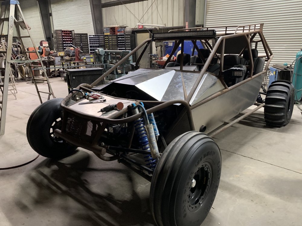

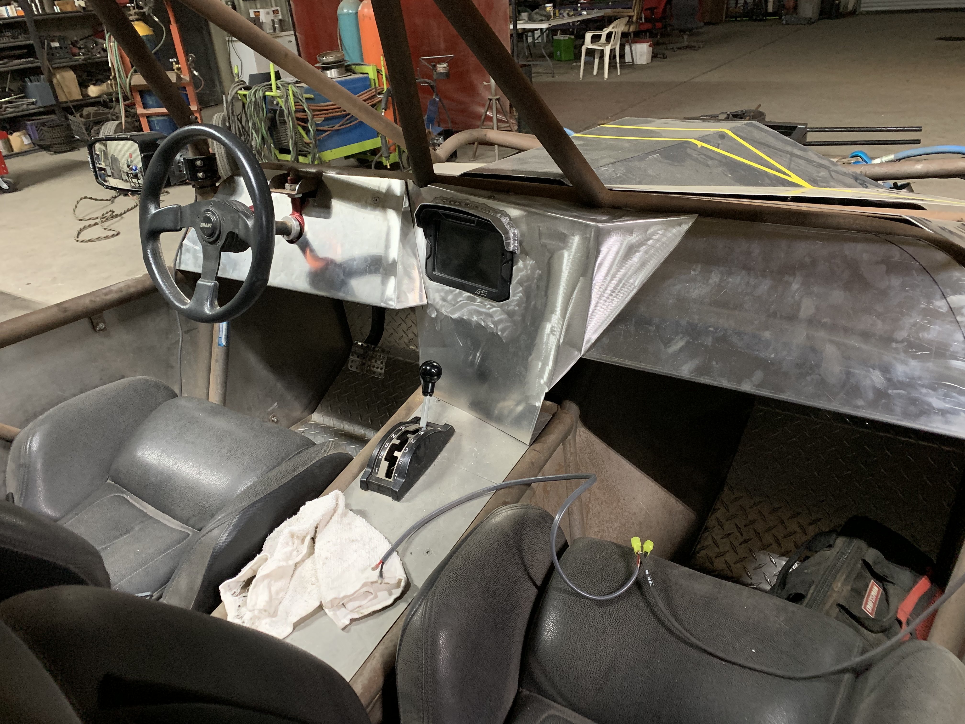

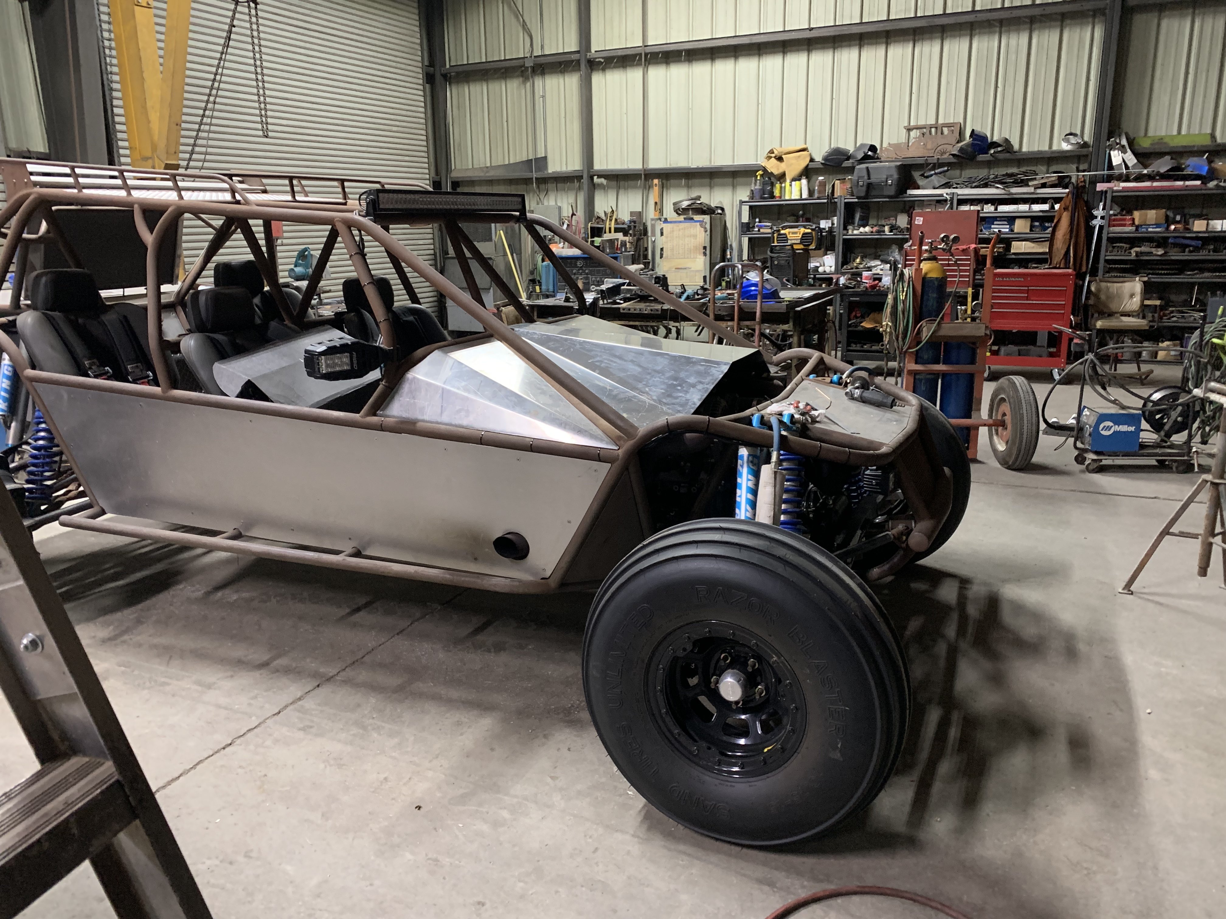

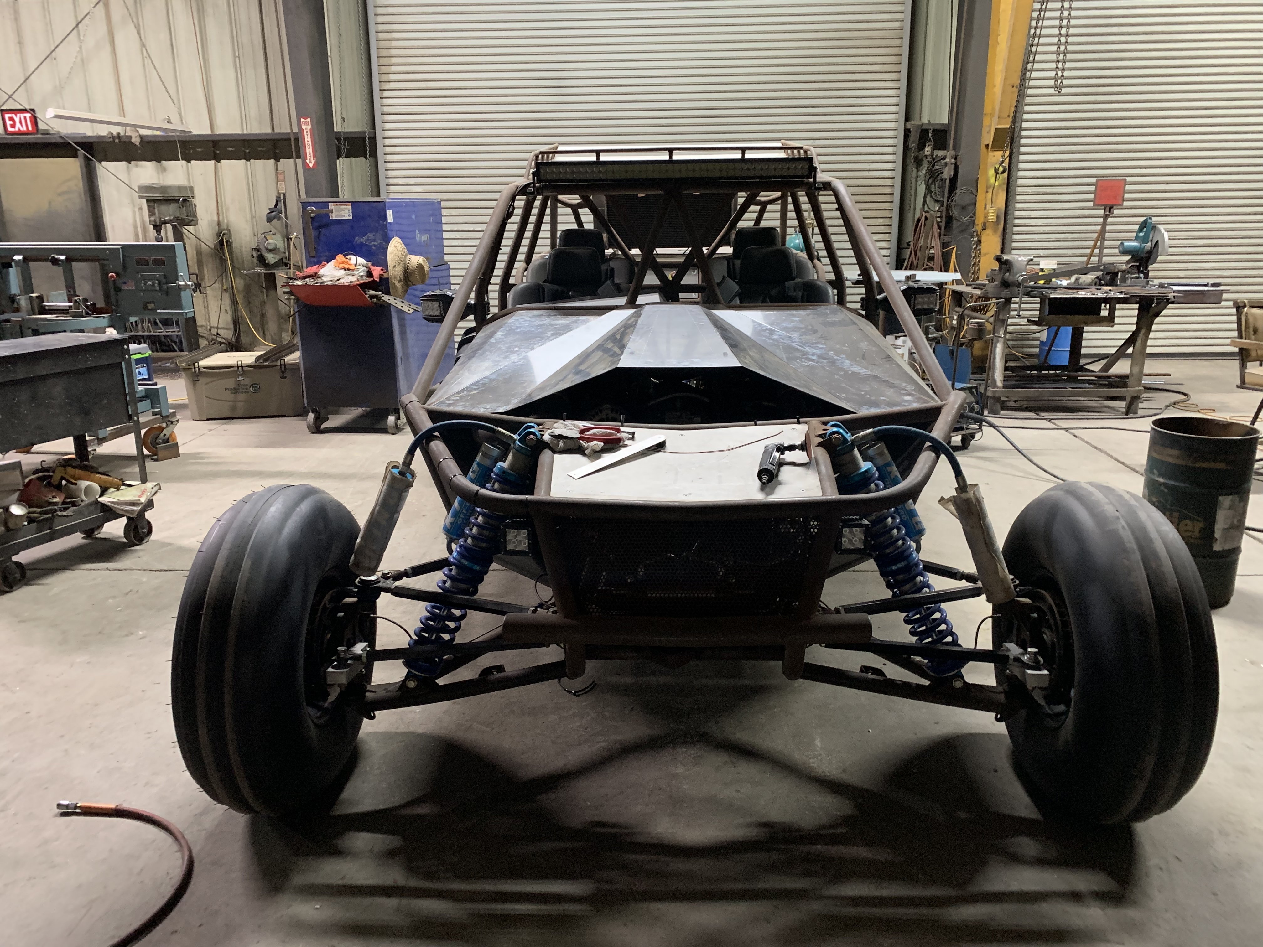

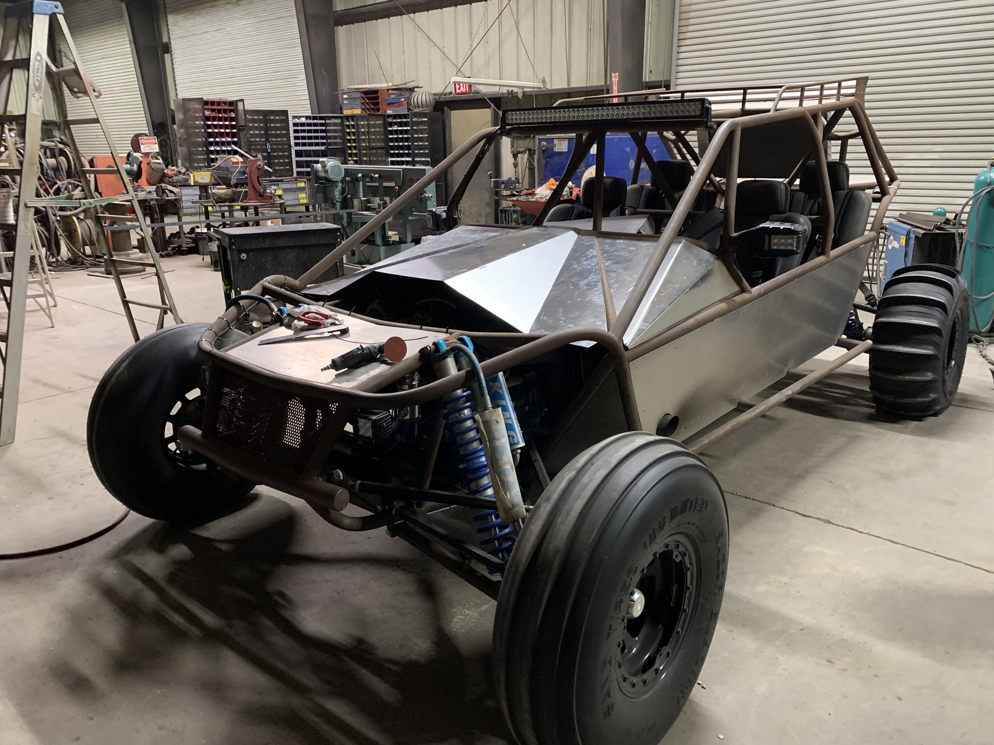

Thought I would update this. I’ve been toying with some aluminum tins for the car. Here’s a couple pictures of what I came up with. Still working on the (hood) still trying to envision it.
I am open to thoughts or ideas.
Share this post
Link to post
Hhmmm. Do you not like the shape or? Or just like to see the motor in the open?
For me I want to cut it back so it’s not so far forward. It’s just sitting on there. I was going to put some tape on for different cut lines to shape it some.
Share this post
Link to post

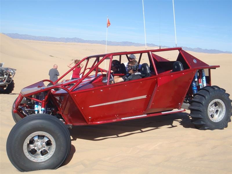

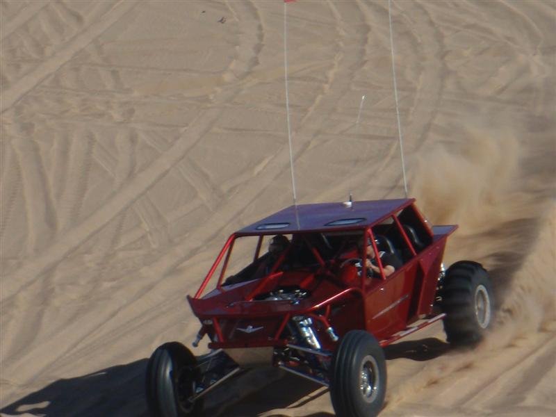

The shape is cool, but looks odd from some angles. I'd prefer to see more of the motor. Maybe just smaller and back farther so the opening is bigger. I tried finding a pic of my buddy Ryan's V8Rail to see what his hood looks like and these are all I could find. Just gives you ideas. I can get more pics if you'd like. He's just down the street.

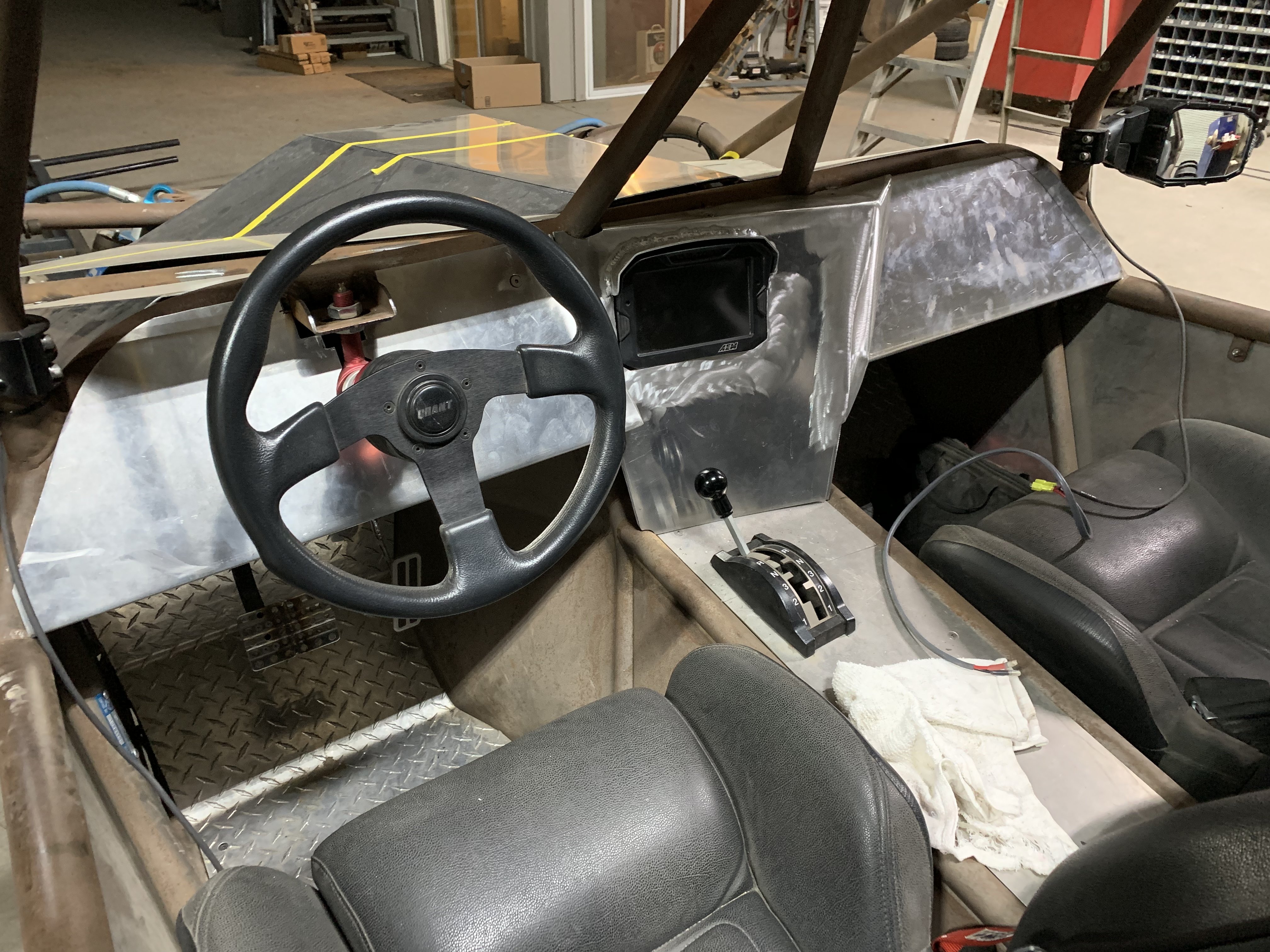

I put the hood on side burner for now. Hindsight is 20/20 though and I should have just finished it instead of jumping to the dash. I really wanted to take care of the dash first but I got distracted with the hood. Anyway here’s a couple pictures. Still more to do but I like how it’s coming along. Just a lot of work.

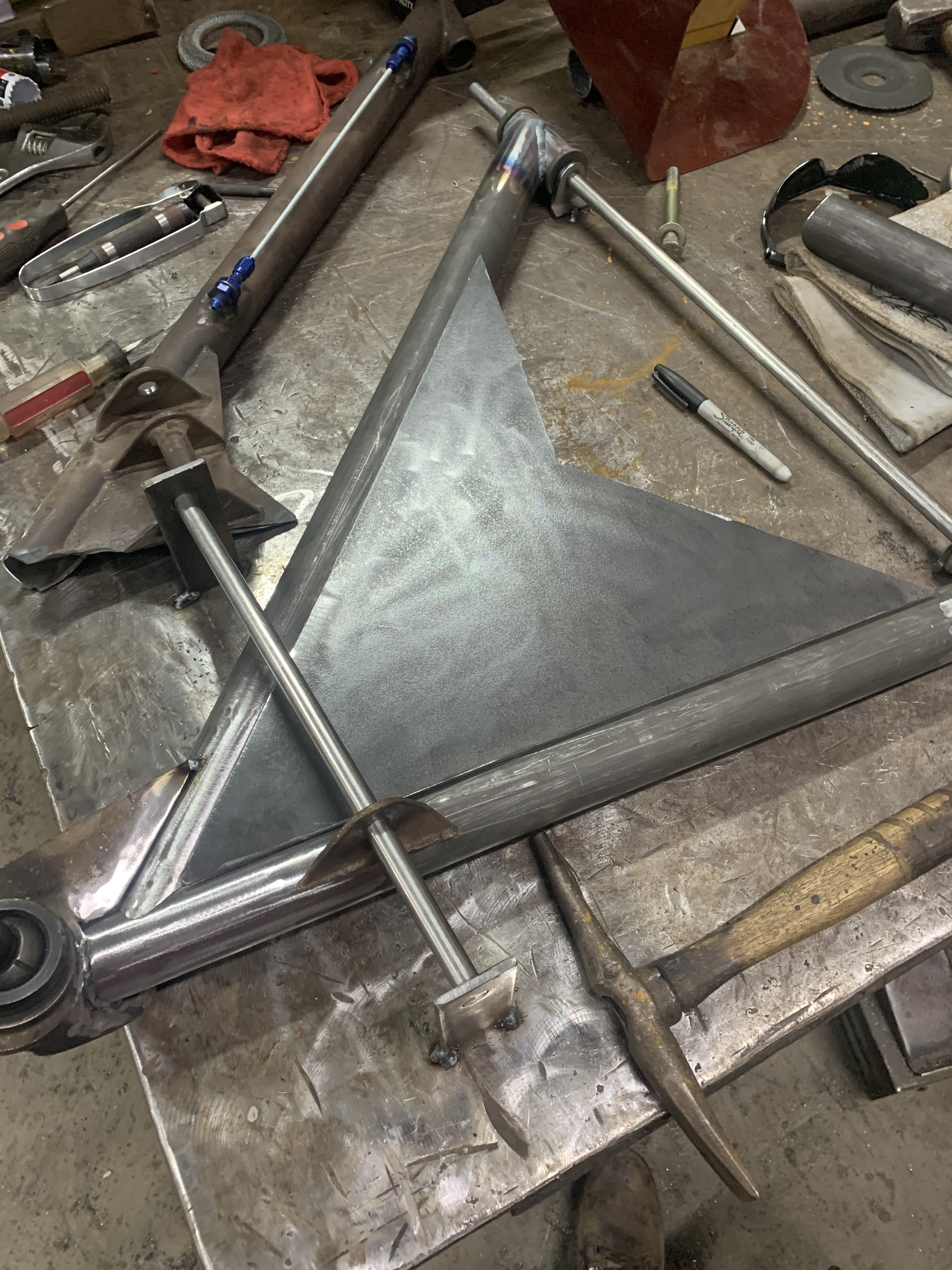

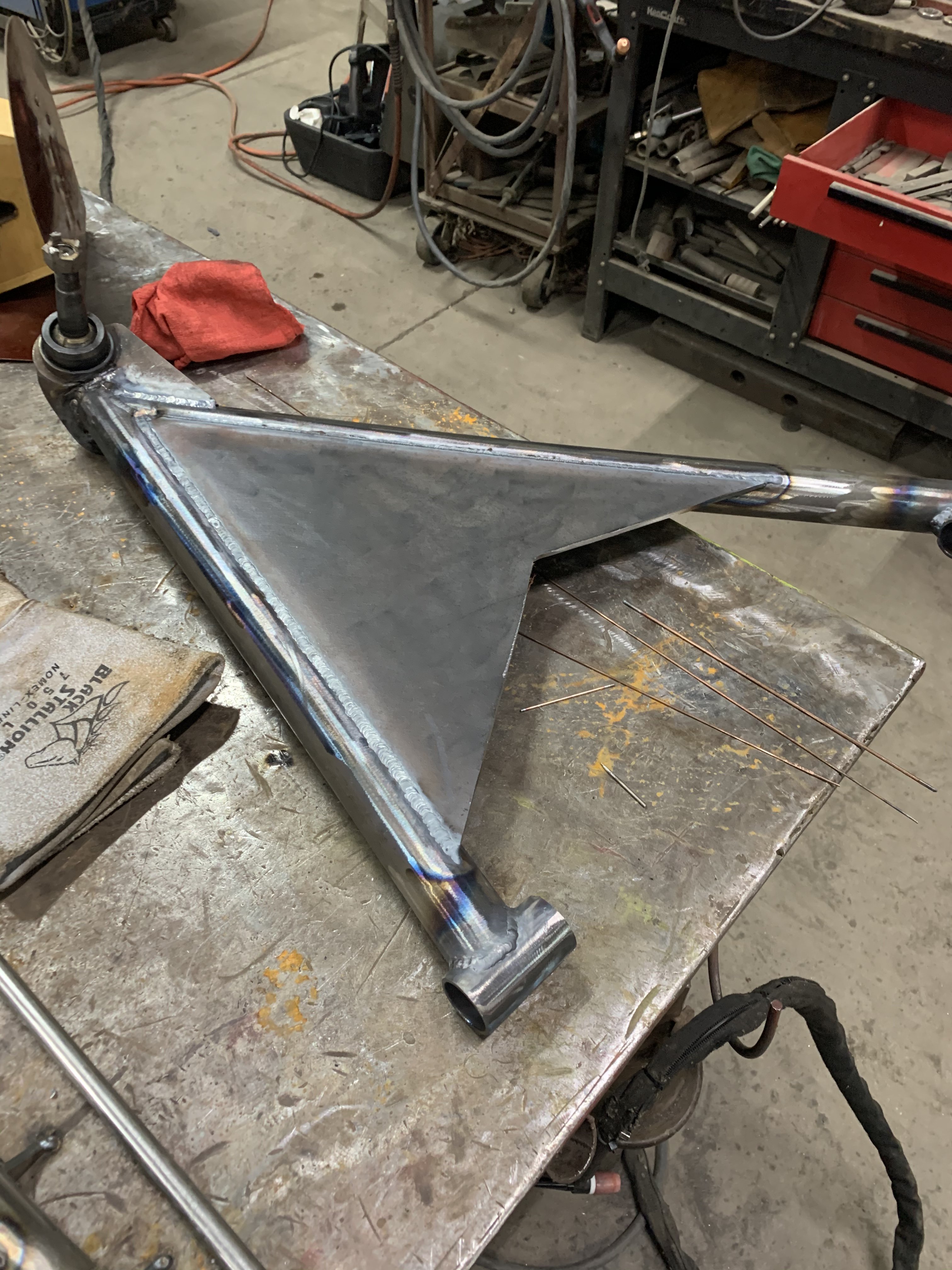

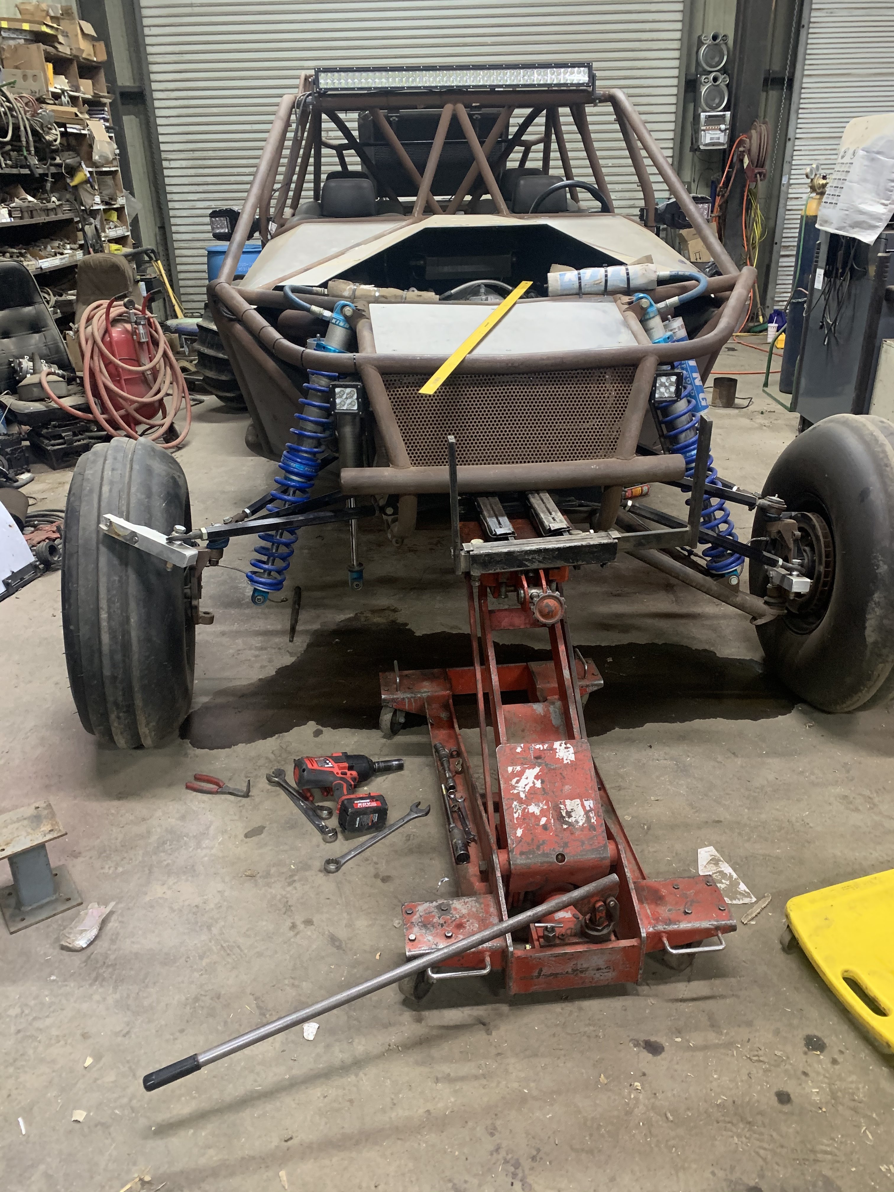

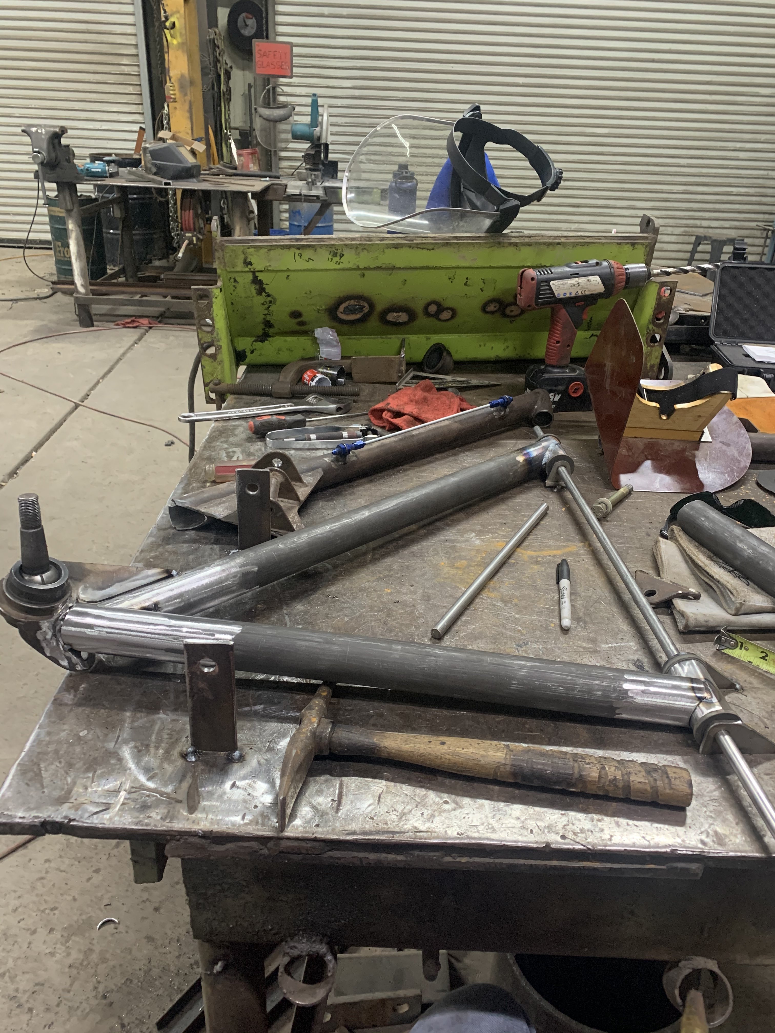

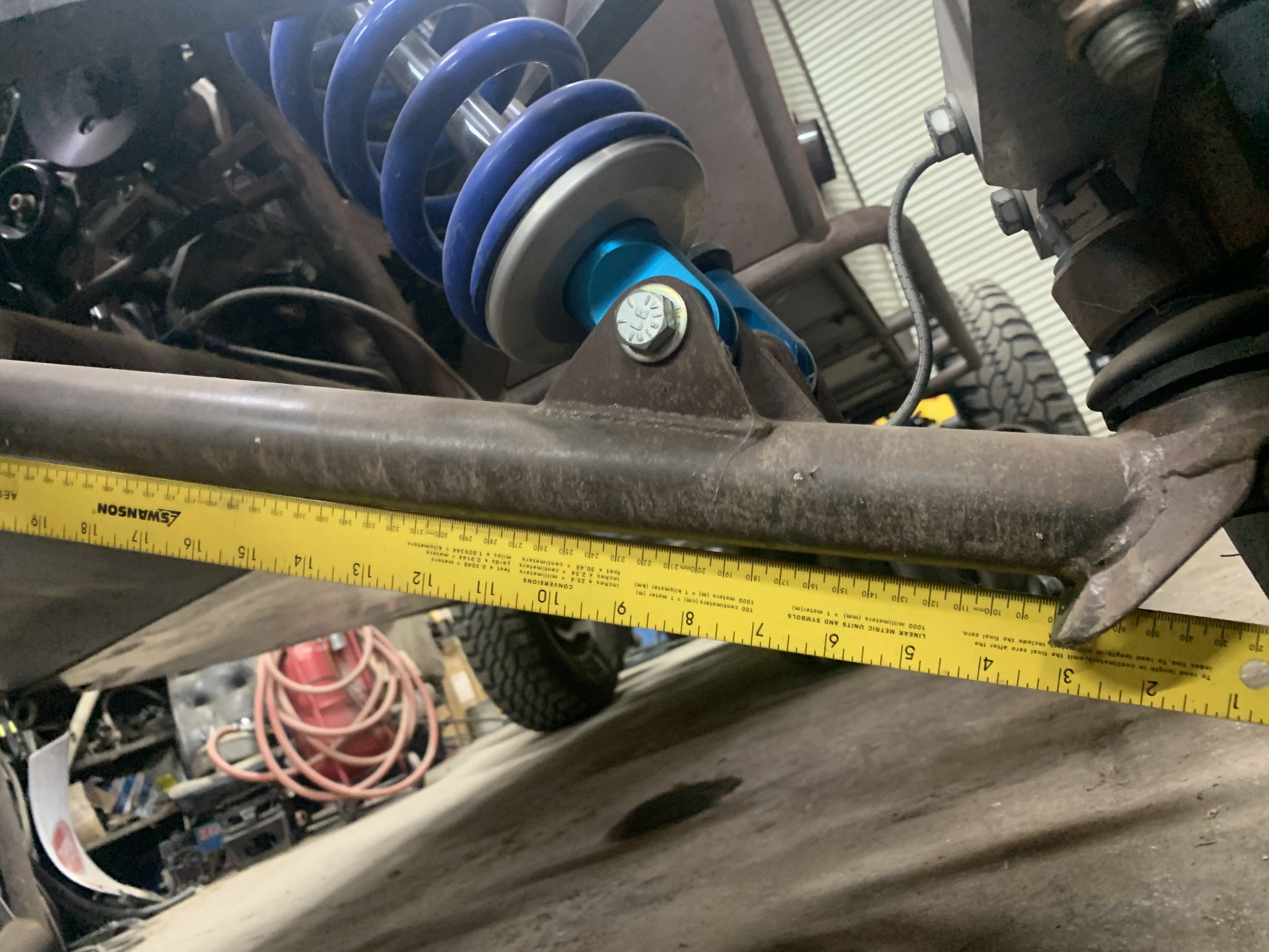

This is the better side. The other side is worse. Both front lower a-arms are bending. I thought maybe it’s not .120 wall tubing or maybe it’s not chromoly? Upon cutting its .120 wall, at least it looks like it but I didn’t actually measure. I have no way to verify material. So away they go. I simply don’t want to risk it.
Here’s the replacement
You can see a piece of the old arm. The bend was where the small plate stopped. Hopefully this will fix it.
