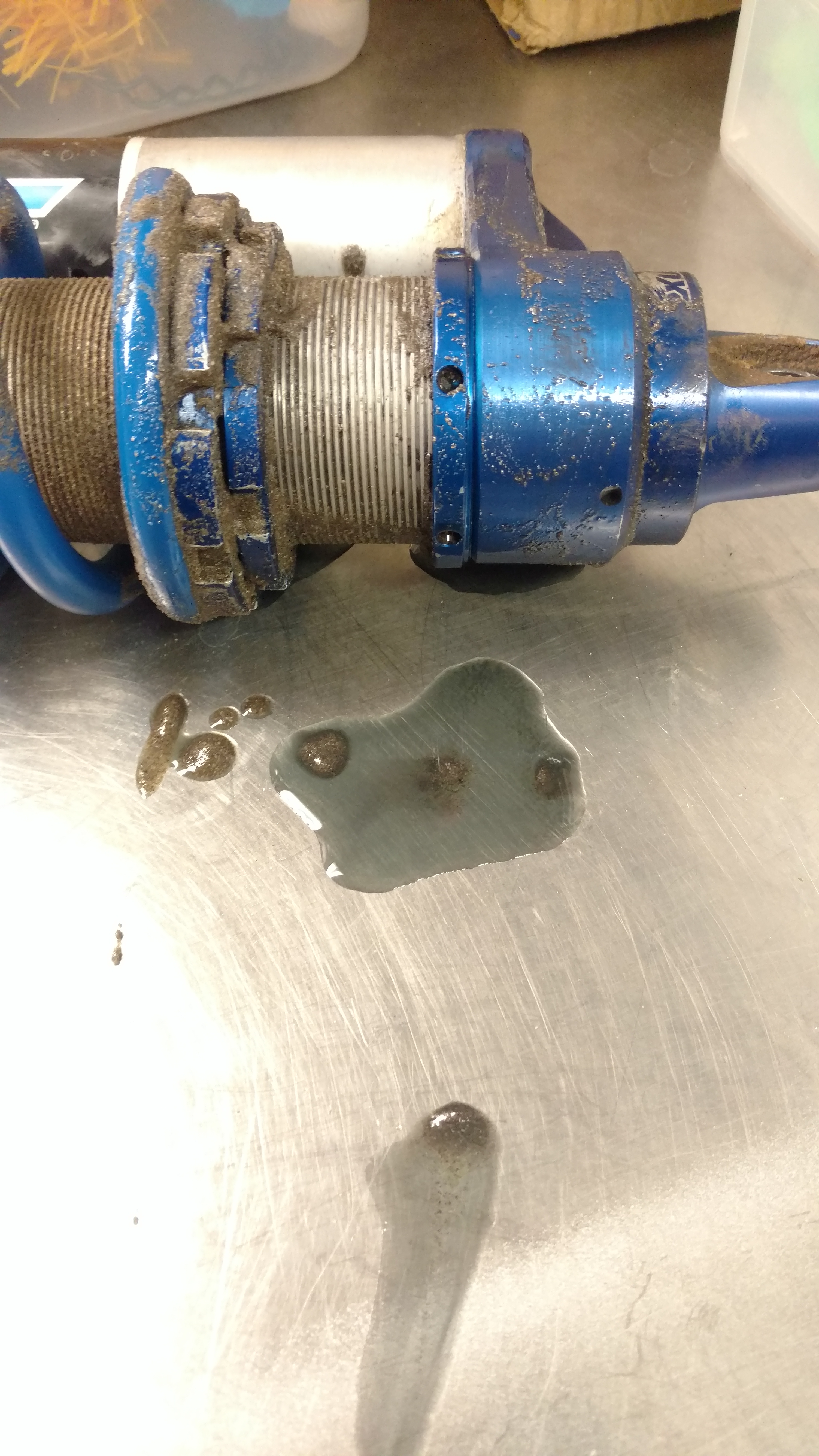

dunefreak Posted December 16, 2016 Posted December 16, 2016 My shock started leaking from the little hole in the piggyback bridge last trip. They were serviced just a couple seasons ago. Any ideas why it would leak from that hole? Quote
DirtBikeGuy Posted December 16, 2016 Posted December 16, 2016 From the looks of it... I see another rebuild in your future, nothing I can diagnose but it shouldn't be too pricey. Quote
dunefreak Posted December 16, 2016 Author Posted December 16, 2016 Yeah I figure it's one of the piggyback bridge o-rings. Quote

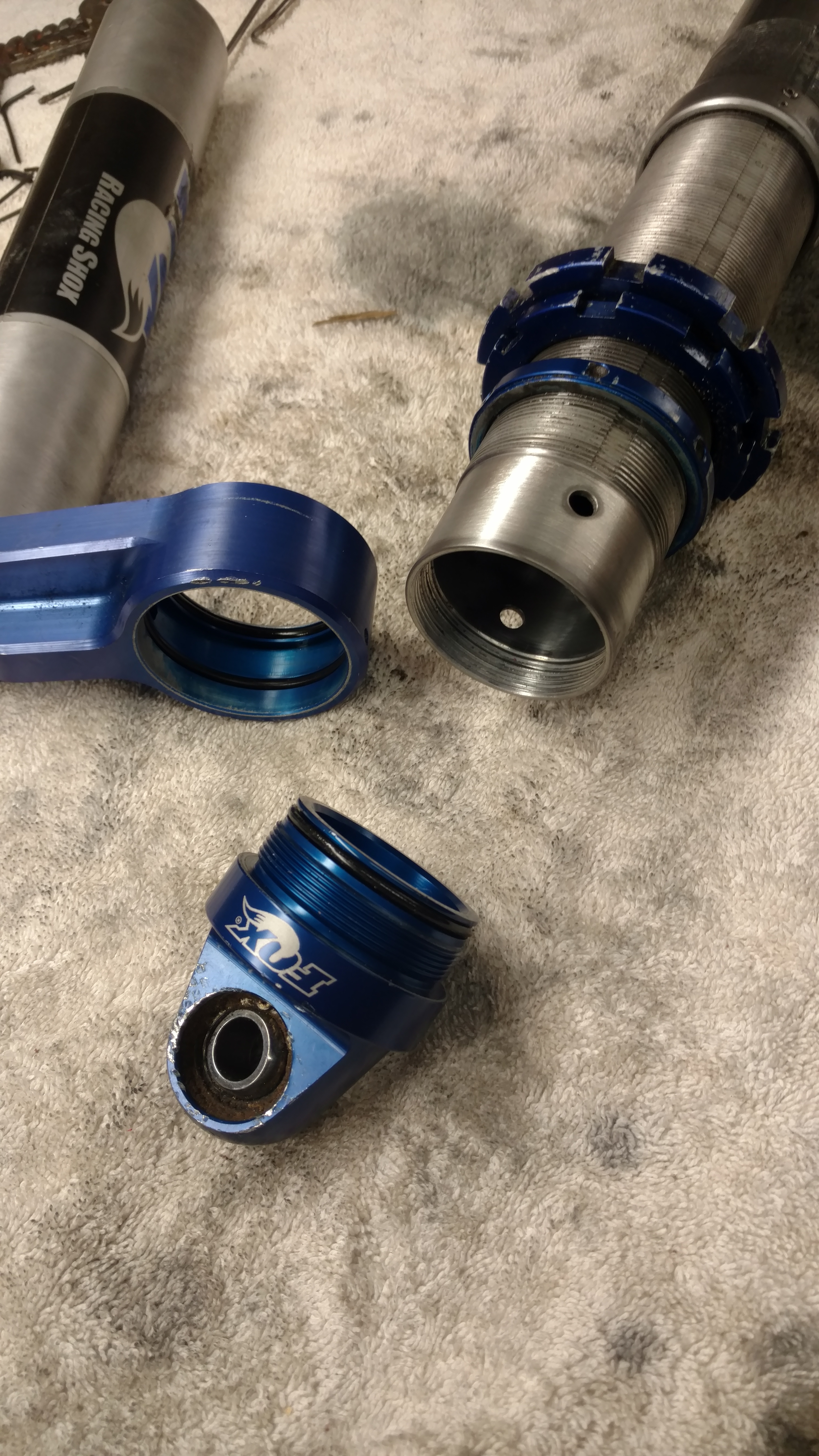

dunefreak Posted December 19, 2016 Author Posted December 19, 2016 Got it pulled apart and rebuilt it yesterday. Didn't see any smoking gun, but one of the orings on the bridge must have started leaking. Guess we'll see next trip. 1 Quote
