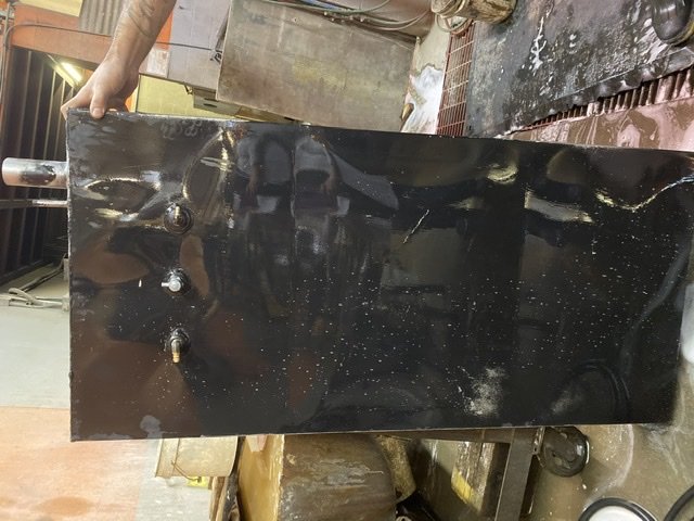

Hi all,
Super old post that I am bring back from the dead but I thought it was worth it with the aging toy haulers out there that are gonna start running into problems like I just did.
I filled up the tank for a long weekend boon-docking in the Mojave. And as soon as we got the trailer all set up the wife complained of smelling gas in the trailer.
I didn’t think much of it until I sat in the chair outside and caught a wiff.   Sure enough there was a decent leak coming from somewhere around the filler neck and no fix to be had.
So we pulled all the bikeS to the fuel station and topped them all off and ran the genny like it was going out of style.  Finally the dripped stopped and we could start to rest easy.
After the trip I yanked it out of the trailer which is no easy task by yourself and called the neighbor over to help me drain the remaining 7+/- gallons of gas and off to the repair shop I went.
I ended up going to Motor Mission for my repair and though I have not yet gotten it back I have been in constant contact with them and they have been very hands on and helpful with my repair!   I have great confidence that I will get a good product from them based on the awesome work they have done for me in the past (had a LT1 motor massaged by them)  I will update as soon as I get my tank back.
Edited by Vegas250rr
Share this post
Link to post
Ok so I got the tank back from motor mission and they were super communicative and nice in the shop but I do feel that I got a little taken advantage of on the price for repair.
Granted I do not know what it takes to dip a gas tank and weld on it but I have talked to more than a couple of welders now and the all agree that I was over charged.   That is to say that I could have bought a new tank for the cost they charged me to repair my filler neck and add a drain bung.
$486.00 OUCH!
