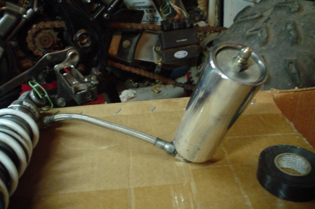

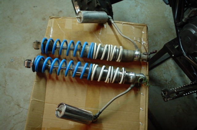

Anyone know hot to polish metal? I have my bypasses that are in a little need of help.. sand out a few gouges and finish them up. Mostley done but need fine tuned

metal polishing is pretty easy, heat is your friend in most cases, the harder the metal the more heat you ill need to generate to smooth it. basically aluminum is easy, sand the gouges out, the buff it with a cutting rouge (red bar usually) , then fine detail it with a polish (green bar). think the exact opposite as polishing paint, paint is a lower speed buff with minimal heat, and metal is high speed with a bunch of heat. :beerpint:

a bench top buffer works wonders, thats how i did my 660 works shocks and they turned out bitchin (i didnt polish the tops because of the sh*tty alum up top but you could sand it down and then polish it.)

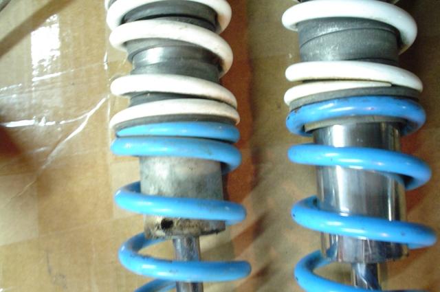

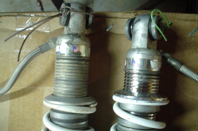

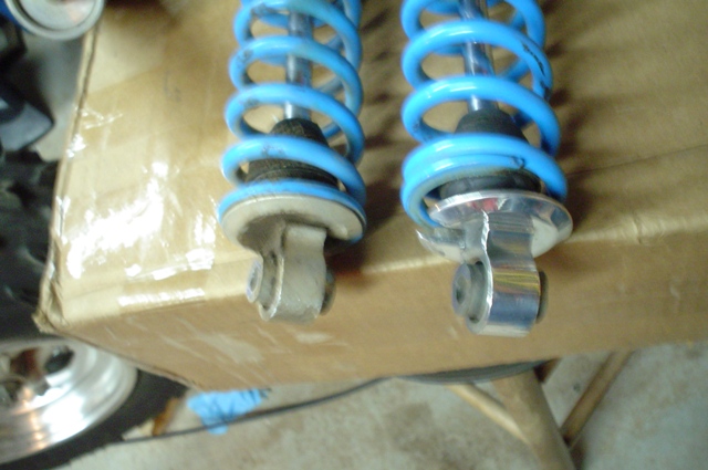

ya mans on my bypasses are scratched up a little and when they where pulled apart he had to grind them down a bit from the gouges. so upper part is buffed with a die grinder just a bit and the restof it is polished but the finish doesnt match

I've done tons of aluminum polishing and if you don't want a ripple reflection get a roll of emery or even good backing wet/dry, wrap around and sand like old timer shoe shine guy. Depending on how rough/deep the imperfection you might need 2-3 progressively finer grades, it actually goes quicker this way and will buff out quick. If you're not sure how bad the finish is get some regular Mothers (white & red container) and try it. Harbor Freight use to carry all the Dico pads and stick type compounds and if you are really N 2 it use the SCR compound last (S-CR stainless/chrome) and aluminum will look like a mirror, at least till you drive it :porn: I've buffed out hard clear plastic with the PCP compound (PC-P polycarbonate/plastic) like headlights and mini mag flashlight lens'. Mothers works the best, forget "Neverdull" or whatever it's called. If you polish under flourescent light and it looks good, it will look chrome in the sun. Get a couple pads for your grinder or you'll get big azz thumbs, good for olympic hitch hiking and polishing. :beatdeadhorse:
