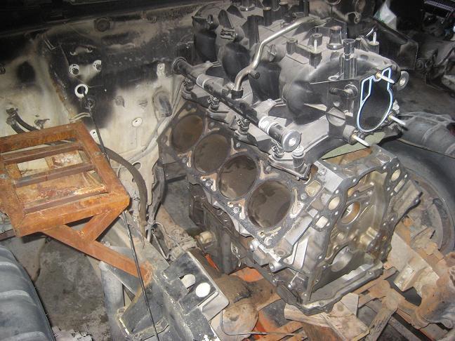

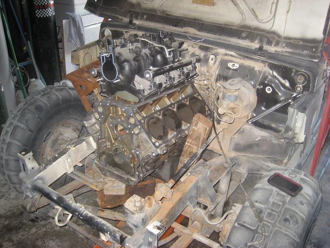

Heres it with the front end off...and the ls1(mock up block) just set in to see what gets cut.....
Because I have plenty of truck intakes and its worth power over the lower car intake and the access are different.....its best both cost and function to us the truck stuff.....but the hood will be cut......but then everyone will know its not a I4 anymore. The idea is to have it pull things out better(more power) and dune easier. No more shifting, just put it in gear and go. And with 300 hp it should be able to traverse any hill....pretty easy. itll sill be run in 4 low to keep speed down.

the rusty thing to left in the picture is the battery mount.....on we trip we were jumping it...and went back to camp....it wouldnt start, and found out that the battery was lost....and the cables.....and I got a ear full from my wife about it...so it got a new batery mount and hold down that would survive with the c*ck roaches after the nuclear halocost....
