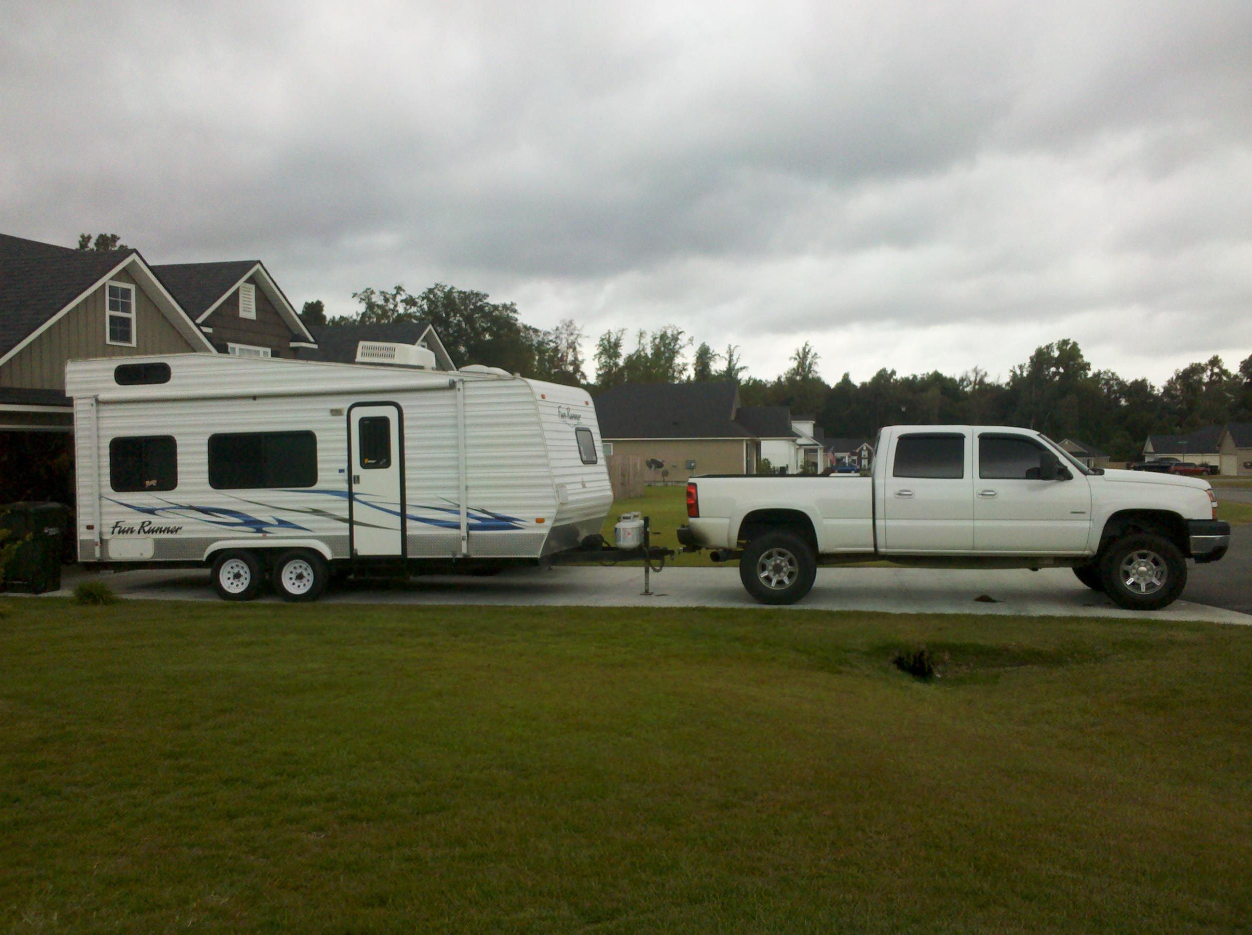

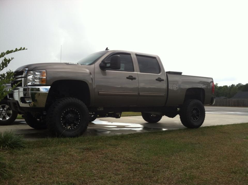

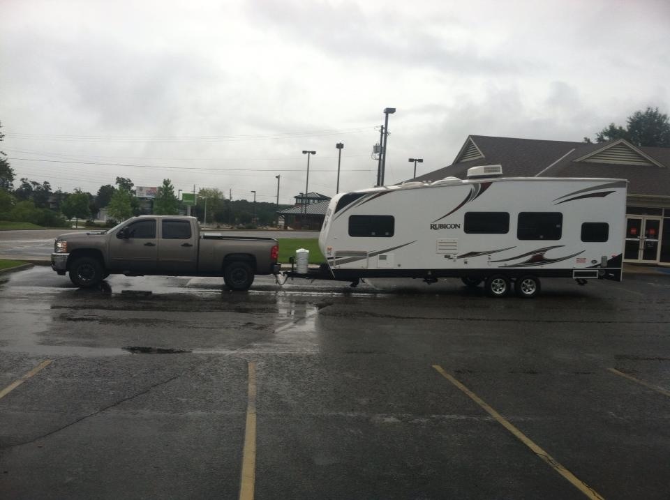

It's been a while since I have been on here but I decided to go with the 2013 Duramax. I loved the 2006 LLY but the deal on the 2013 LML was to good to pass up. I got it lifted at 4Wheelparts they hooked me up. With my family growing I traded the Carson Funrunner in for a big set-up. Finding toy haulers down here in Georgia is hard. Camping world gave me more for the Carson than what I paid for it new. I'm trying to get orders back to the southwest. Keeping fingers crossed
