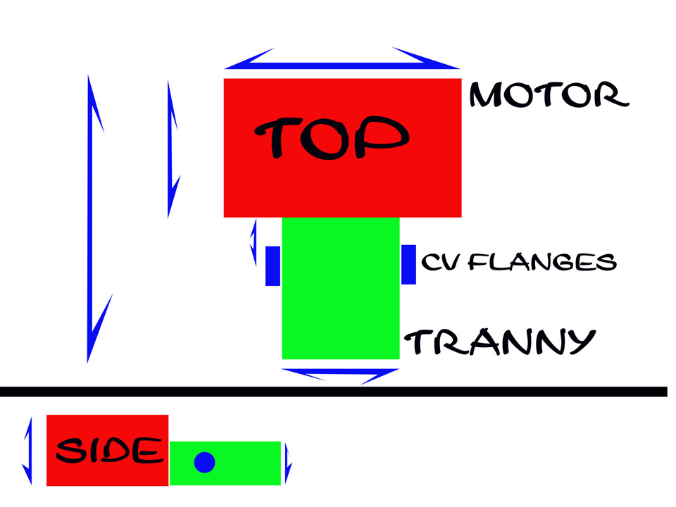

Yoshi Posted April 10, 2008 Posted April 10, 2008 (edited) Was curious if I could get some numbers from anyone with a 2.0 or a 2.5 subi and a tranny bolted up. Was thinking about a built 091, but if there is something else you would recommend that doesn't weigh a ton, feel free to put your motor tranny combo and fill in the blanks for measurements. Since i've had quite a few people ask about a subi as an option, I was gonna see how much changing I would have to do to the rear motor compartment to get it in, the width is what concerns me, around 31" is what I believe the motor currently is.. I need height of the motor and tranny, length of the motor, length of the motor with the tranny, width of the motor, width of the tranny, and the distance to the center of the cv flanges from the back of the motor. Is your setup mid or rear as well, any pics you may have would be appreciated as well.... So, thank ya much for any help... Edited April 10, 2008 by Yoshi Quote
