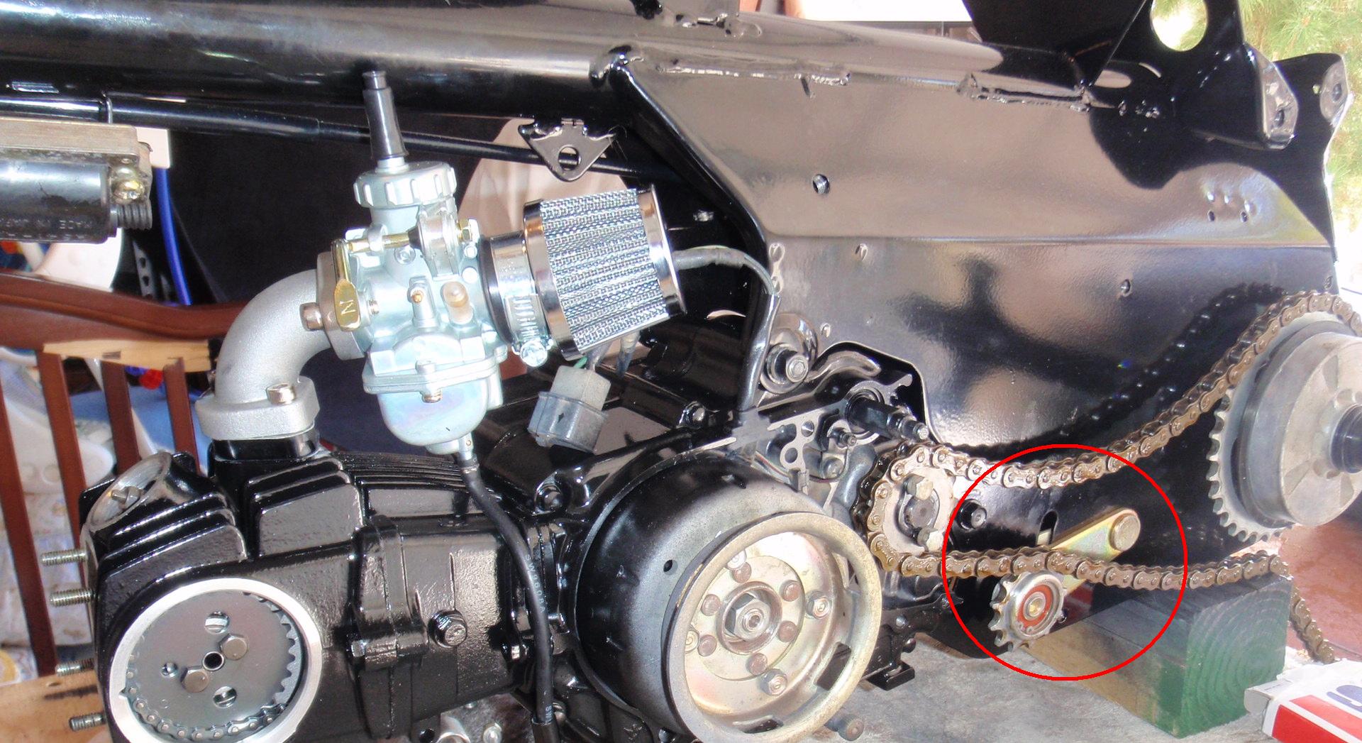

I have a nylon roller setup on my sandbullet right now just trying to switch it to something else. I am tired of changing these rollers out every three trips. I am looking to see if anyone has anything different out there that they have better luck with. I was thinking of useing a sprocket tensioner instead but I believe it will heat the chain more than I want. If not where can I get these nylon rollers at in vegas, I am getting them from a builder in cali but want a place in vegas. thanx for the help. i will get pics of my setup as soon as I put it back together

How about some pics of your set up?
