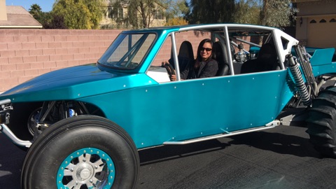

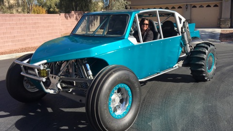

Well got the car to start today. Like a retard or total rookie mistake I was talking to my buddy Scott and we realized I had the fuel regulator in the wrong spot. So after moving and hooking up properly she fired right up. Still finding some loose ends that need some attention before going out. It's not together like the full body on it if that's what your asking. The body goes on like a puzzle and definitely don't want to keep putting it on and taking off while I chase off gremlins.

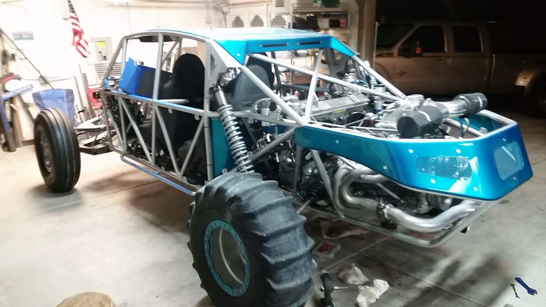

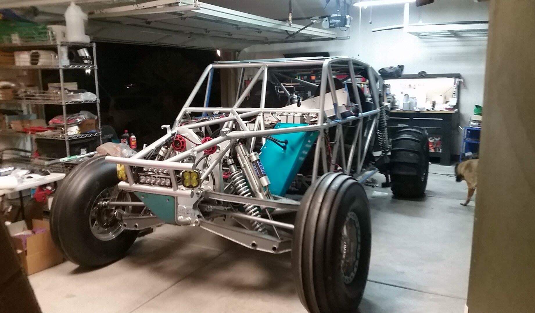

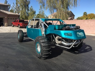

Some progress photo's. All the plumbing is done. Dash has been with wire guy for a bit. Throw the engine harness and finish wiring it hopefully.
Still chasing a few gremlins but still feeling good for buggy round up. When i finally got the motor to firei wasn't impressed with oil pressure. Alper and a couple of the guys felt the oil pick up ga
Chassis is at powdercoat, trans is getting checked out as a cya. Get it all back and start the mad dash. We definitely can't wait to tear up the dunes with the new car.
Posted Images
Still chasing a few gremlins but still feeling good for buggy round up. When i finally got the motor to firei wasn't impressed with oil pressure. Alper and a couple of the guys felt the oil pick up gasket was the problem. So unfortunately that lead to dropping skid plate and the oil pan which is no fun. Found that the gasket has stretched out, But just got it all back together and test fired and boom back to making great oil pressure. Now onto the next to do....

Well she's about ready for the round up andher first runs. Today was the first day we have pulled it out of the garage under it's own power. Few loose ends to tie up and throw it in the trailer and hope for the best.
