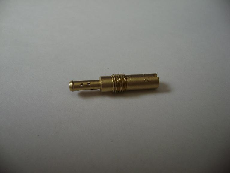

On most carbs you can swap main jets without removing the carb, as stated above use a 17mm to remove the drain plug on the bottom of the bowl (if it has one if not you have to remove the carb to get the bowl off) then get a 6mm socket and stick it inside, you wont be able to see the jet but you will be able to unthread it. Remember righty tighty lefty loosey :D

Ok so the reason i was putting a new jet in is because it was back firing so i got home from school today so i went out to do the carb and jet so i get it all off and i pull the jet out and the stupid jet i bought was the same size. So now i am really pissed off at the guy at mountian motorsports and i have to go back down there this weekend and buy a bigger jet.
Do u guys think 148(stock) is big enuff or should i go bigger if so what size. it only a Hmf slip on pipe????

I see your air box lid is still on? Stock air cleaner too? Are you
taking them off too?
How many times do you want to go to the store to get a jet?
I drilled mine out when I was in the "out back" boon docks, or
get a set of jets. 3 or 4 in your range.

keeping lid on, maybe new filter, tring to get new jet dont know what size to get...
Put a 152 in it !
you said it was poping , when ? on decell / or reved out ?
if it's on decell then you need fuel on the idle screw [ bottom front ] turn out 1/2 turn and try it .

If thats the jet they sold you for your main jet its not the right one. It should look identical to your stock one other than the number (which is the size). It kind of sounds like the people your dealing with at your shop are idiots...That makes it a little harder for someone to learn!
