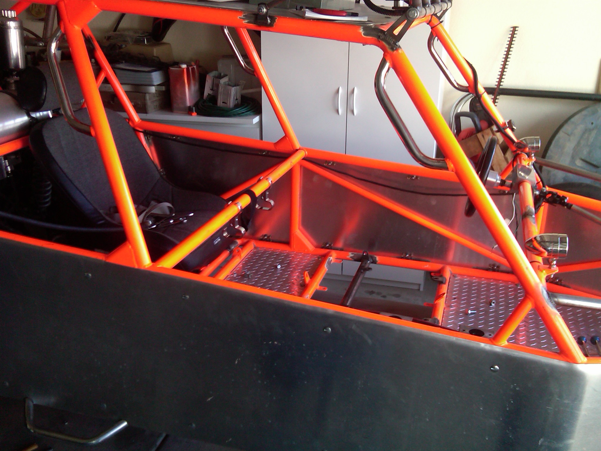

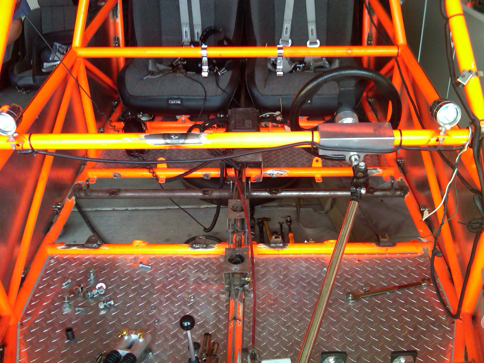

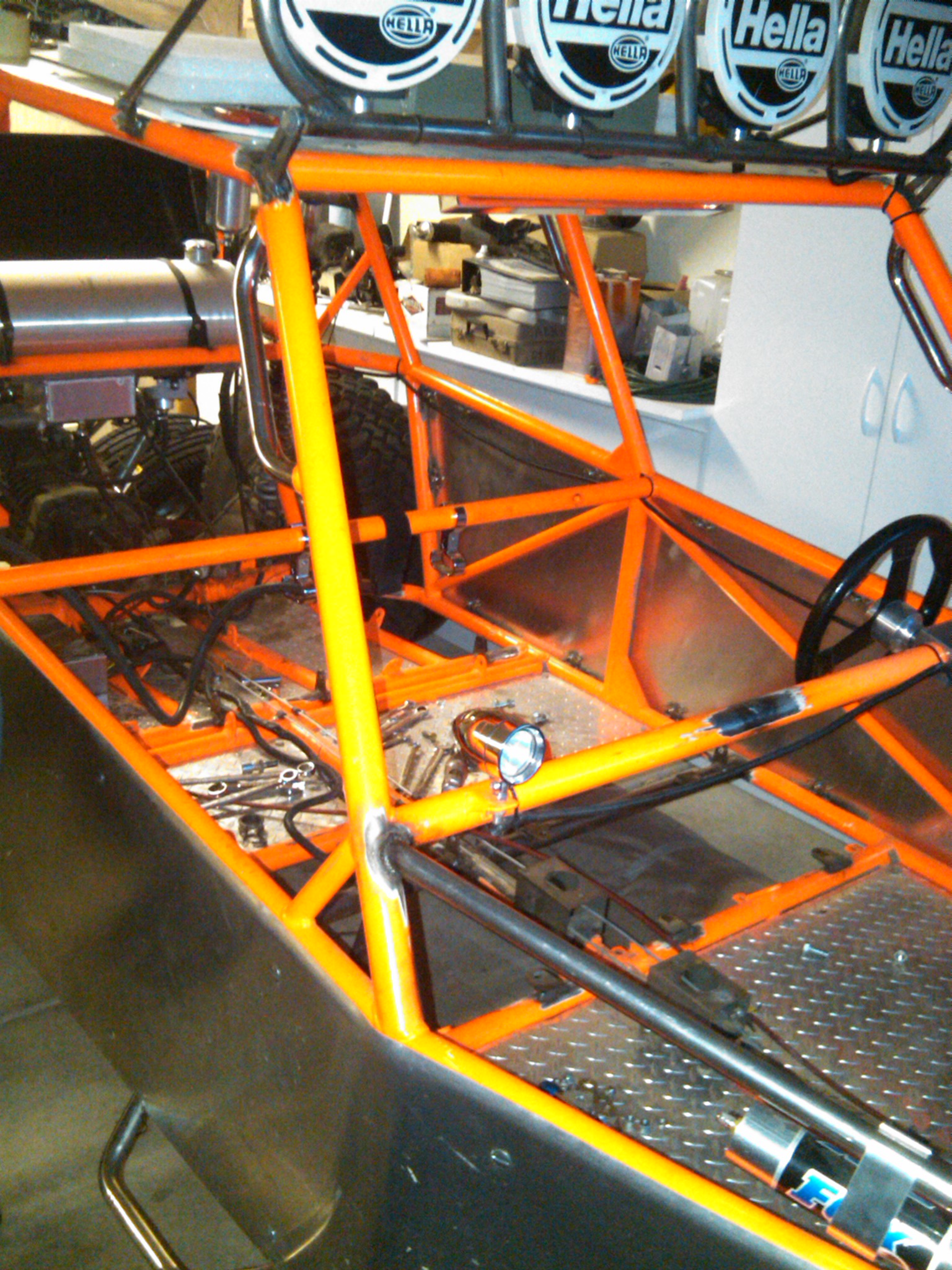

BigBlockTank Posted June 12, 2010 Posted June 12, 2010 Im having an old friend make some inside "door panels" for my new to me sand buggy. He needed the seats out, so out they came. The last time out, I heard something "pop" in the transmission at the top of comp hill, and kinda made a grindy noise. I have to take the trans out with the motor as well. I'm putting in a cutting brake, and making a new dash and console so I can reach ALL the switches while I'm strapped in too. Here's my question.....you know how much I've taken out, and what all has to come out, and how much is left bolted on the car. Should I just rip it all off and re-powder coat the frame and make it look like new (which it really is)???????? I'm going to replace all the brake lines due to the cutting brake, along with the clutch hydraulic line. I plan on mounting the cutting brakes behind the dash with slots for the handles above the shifter. All the gauges, in-car communication, switches can all go there too. Post up your dash pics too, please!! I mean, am I relying on the old "since I'm doing.." syndrome, or does it really make good sense to go ahead and do it now? I think I have the $1500 to sand blast and powder coat (back flourescent orange), but is this the time? Here's some pics if I can get them to load up....... BBTank Quote
badass24racing Posted June 12, 2010 Posted June 12, 2010 Do it now No better time then when your Half way there Quote
BigBlockTank Posted June 13, 2010 Author Posted June 13, 2010 Do it now No better time then when your Half way there That's what I thought too, but I just wanted to make sure I'm not "just justifying it" because I'm 1/3 of the way there right now. I think I 'm gonna do it. We'll both be happier when we take it out to play. I mean, it'll feel like a completed car, not some POS off the shelf for the weekend. I'm never indecisive, for more than............. BBtank Quote

BigBlockTank Posted June 14, 2010 Author Posted June 14, 2010 To be honest, the turning brakes are not an issue at this point. I've had the car out, where we've been, and it needs the cutting brakes, nuff said, they're in. I'm grinding the welds from the old shifter and brake location getting ready for the new Jamar shifter, and the cutting brakes. I still have to pull the tranny for repair. That's gotta happen too. I'm gonna be so close, I just can't see NOT doing it now. It would appear that it will be coming apart to repowdercoat the frame, and the new additions/modifications. Pics will follow as they happen! BBTank Quote
bp-guy Posted June 15, 2010 Posted June 15, 2010 Tear it down and make it look like YOU want it to. Here's a quick tip for your wiring- If it is wired into the frame already, as you pull the wire have some welding wire follow the old wire out and leave it in the frame. Leave a few inches hanging out of all the holes, that way when you go to rewire it all you have to do is attach the new wire to the welding wire and pull it through the frame. Quote
BigBlockTank Posted June 15, 2010 Author Posted June 15, 2010 Tear it down and make it look like YOU want it to. Here's a quick tip for your wiring- If it is wired into the frame already, as you pull the wire have some welding wire follow the old wire out and leave it in the frame. Leave a few inches hanging out of all the holes, that way when you go to rewire it all you have to do is attach the new wire to the welding wire and pull it through the frame. That's a really good tip. Unfortunately, it's wired outside the frame. I plan on doing the rewire and going inside the frame. I had already thought of using some safety wire in the channels for the wire, it's true what they say, great minds think alike. OK, I just want to be thought of as just barely smart. Quote
