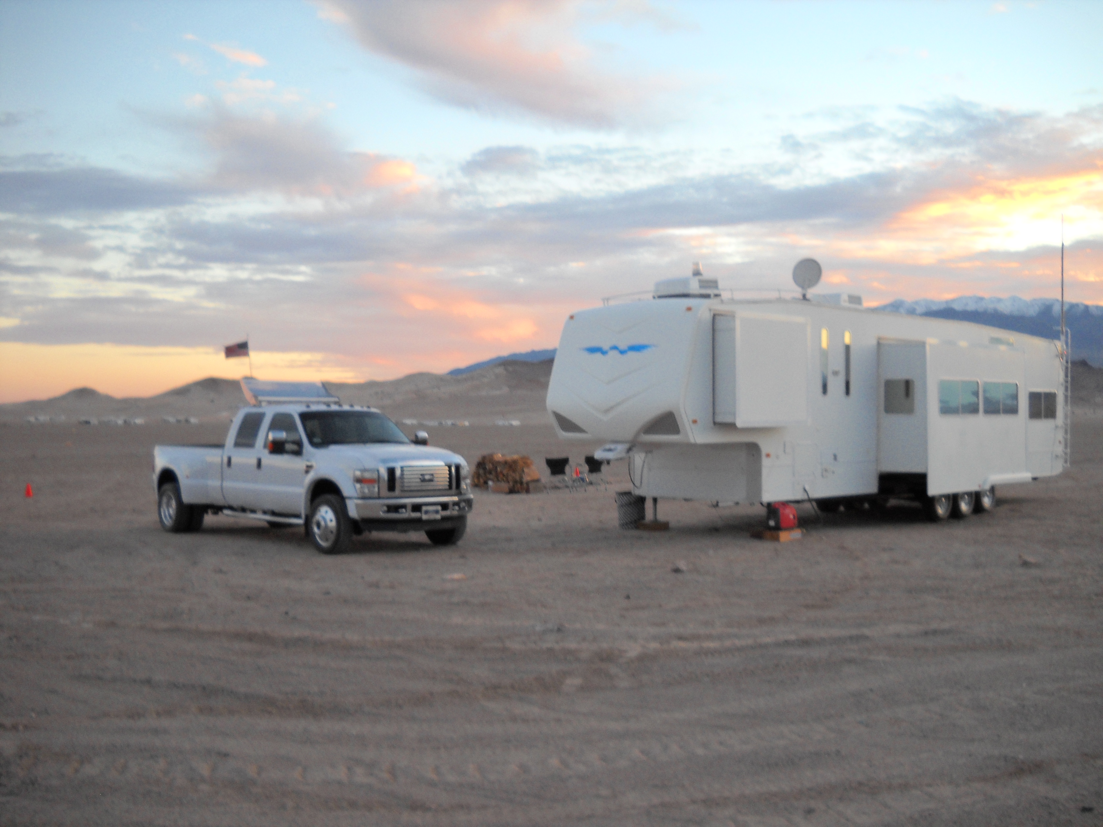

Well, i'm pretty sure that my new to me WW has some sagging walls. I didn't see it when I bought it but after the Thanksgiving trip it seem to have shown it's ugly face. I am noticing it on the "driver's" side wall. There is a buckled panel in the closet at the front of the trailer and there is a bow just over the wheel well.
I am going to try the "bounce" test tomorrow I hope.
I got a good deal on this trailer, so i'm not really offended by having to do this. I'd just like to see if I can fix it up here without having to take it to the So cal Doctor place.
I need to try and jack the trailer at the ends and see if the wall moves back at all or not. None of the cabinets inside look bad, just the panel in the closet is bowed. I need to look closely at the wheel wells.
I'd like to plan on keeping this trailer and the rough roads and off road trips aren't going to get any better so neither will the trailer unless I fix it.

I have done some research and I understand the fix pretty well. Generally it's use the landing gear at the front, and jack stands at the back to flex the trailer back. The axles act as weight in the middle to "pull" the center down. Nobody really seemed to have luck with actually "jacking" the walls up.
I will talk to the others and also going to talk to Dale @ H-Town he has fixed a few trailers. Nothing on the interior is bad, other then the wheel well so there isn't any cosmetic fixing that is needed. It's just a matter of supporting the walls.
I did the "bounce" test myself today and O-Yeah. you can see the walls and wheel well moving for sure.

Got the trailer back today from Jim Goodwin RV. 4 hours down, 4 hours back. Traffic wasn't too bad overall. just some idiots at the top of Baker hill going 60mph and brake checking for no reason.
Jim did a nice clean install and fixed a few other things at no extra charge. Overall I am very satisfied with the work that was done. Now it's ready for Coral pink, and a new RZR.
