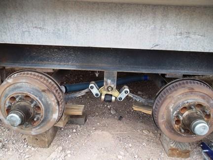

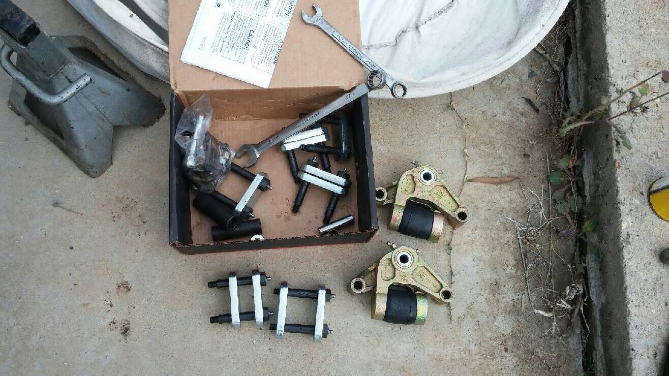

Getting the trailer ready for the swap out. This kit is pretty beefy. It weighs in at just over 20 pounds.
post-1872-0-97258800-1385251732_thumb.jp
post-1872-0-25991200-1385251771_thumb.jp
Wheels off, Time to remove the old and put on the new.

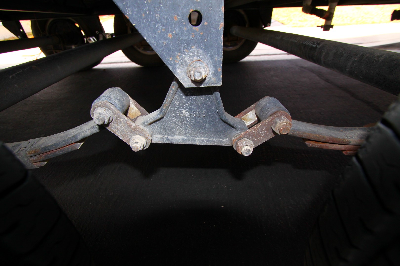

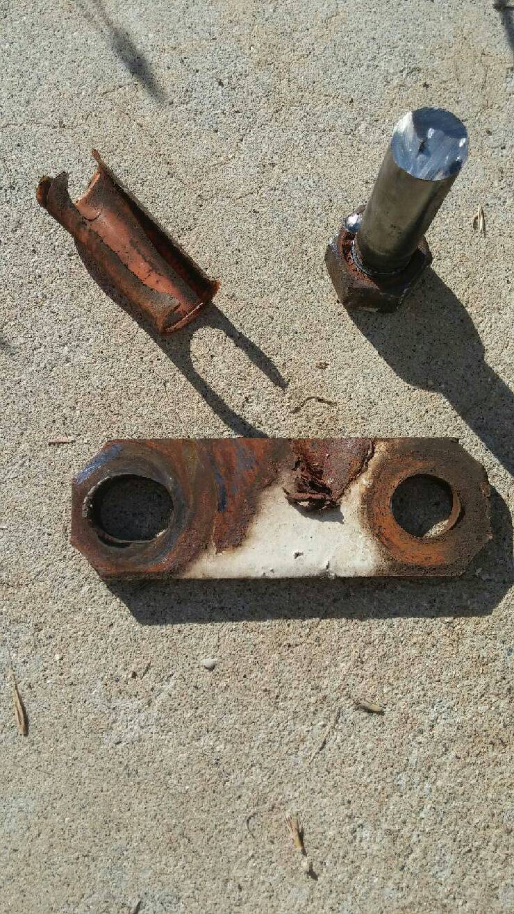

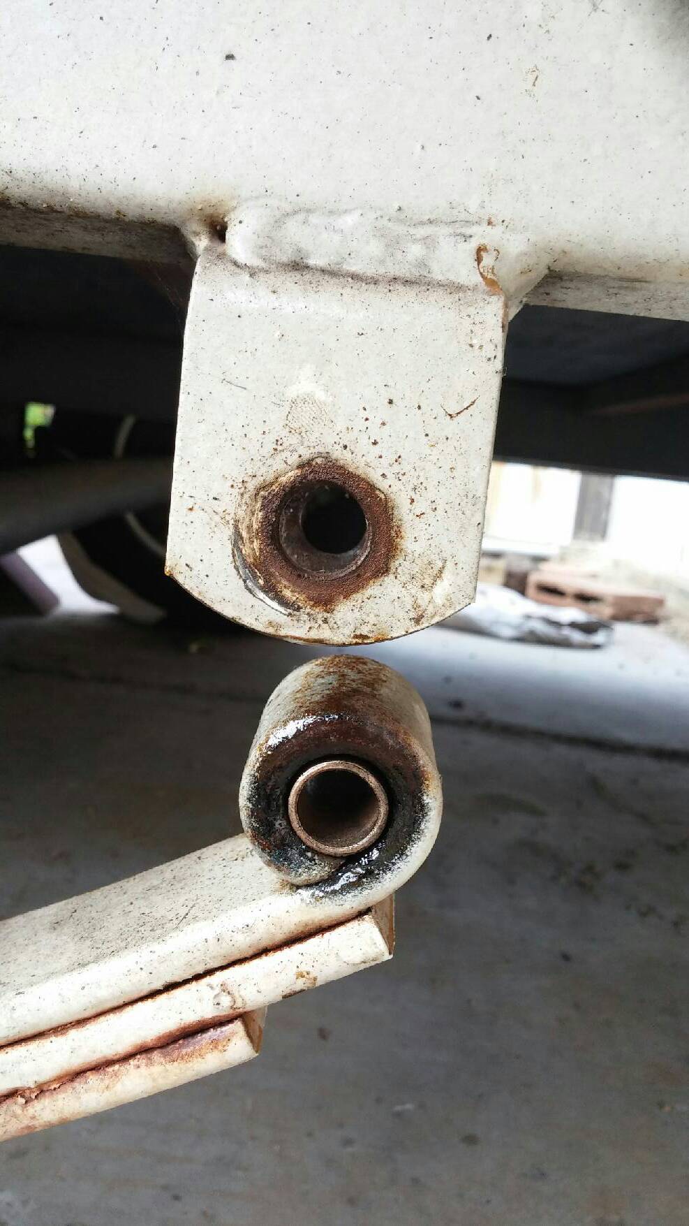

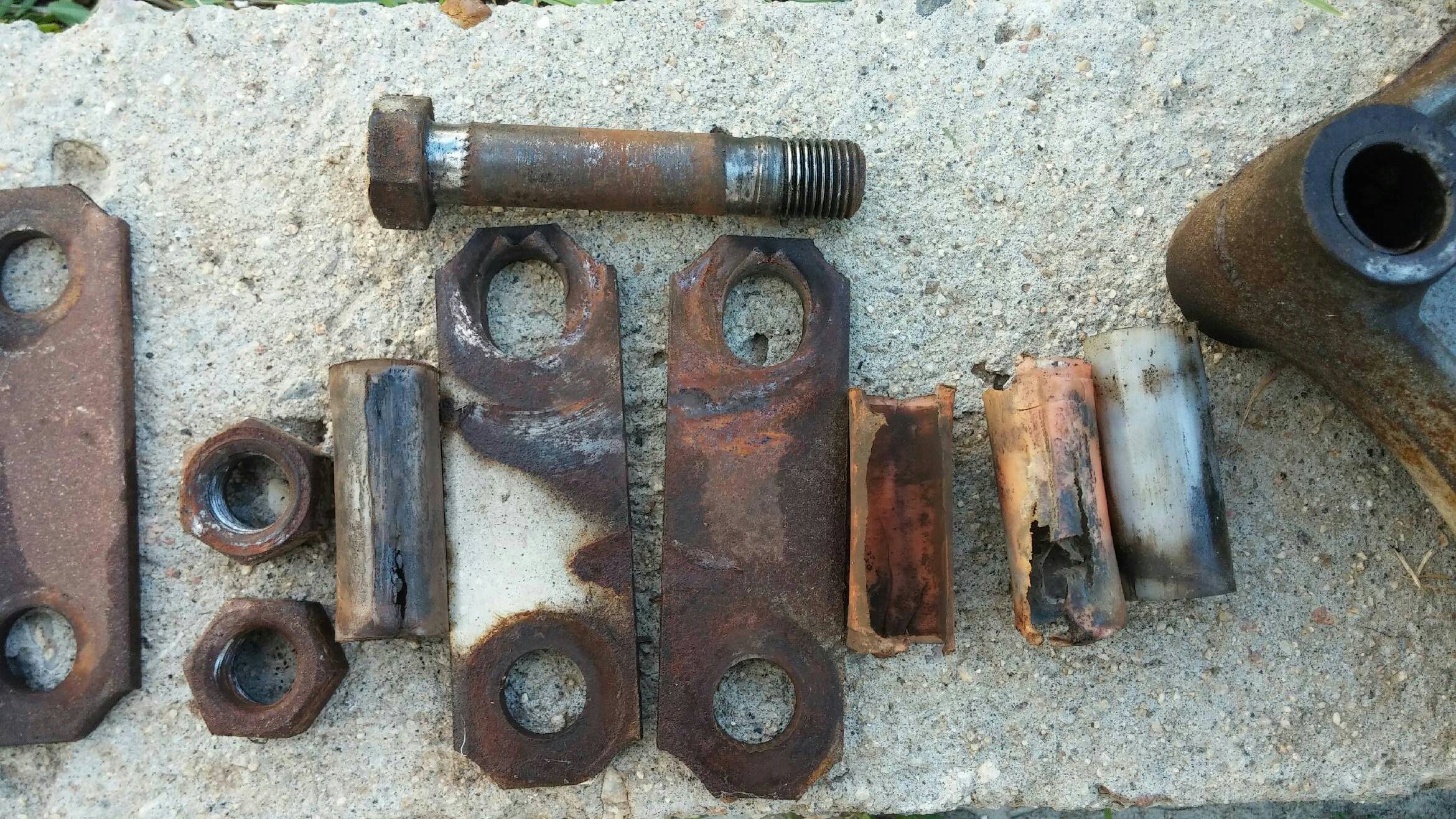

Glad I did this, look at the bushings. They are made of plastic and were in bad shape.
post-1872-0-33037000-1385251946_thumb.jp
post-1872-0-51800600-1385251995_thumb.jp

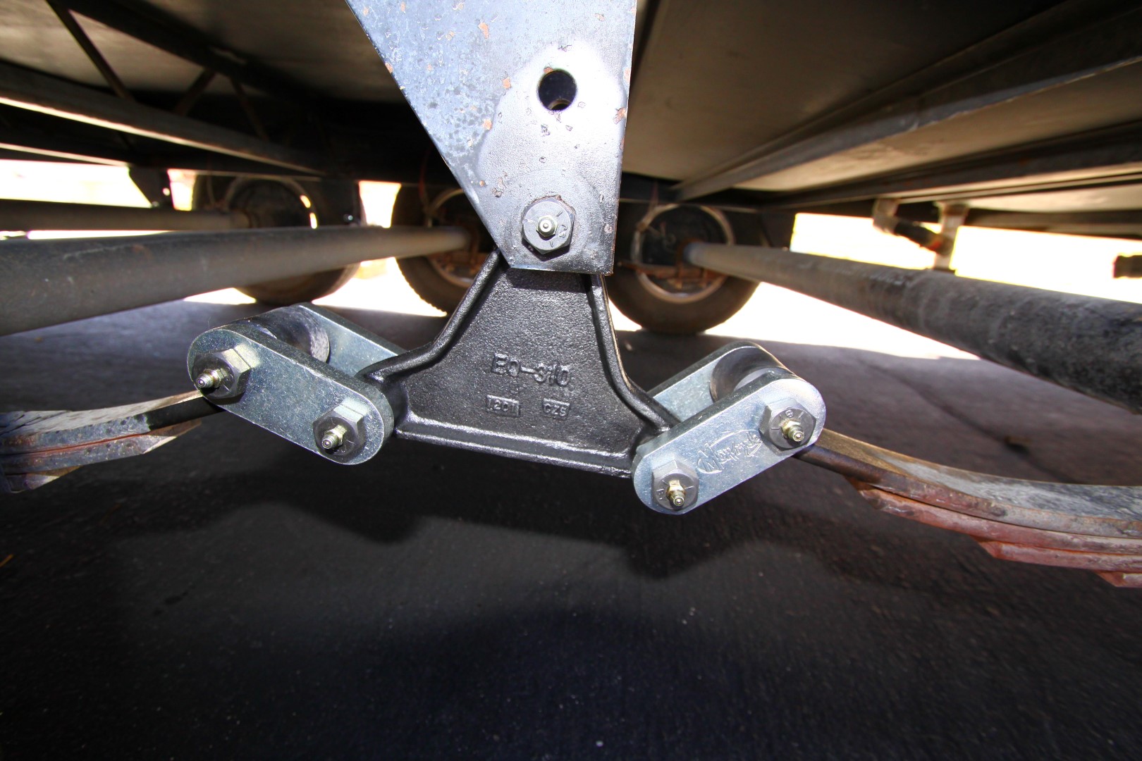

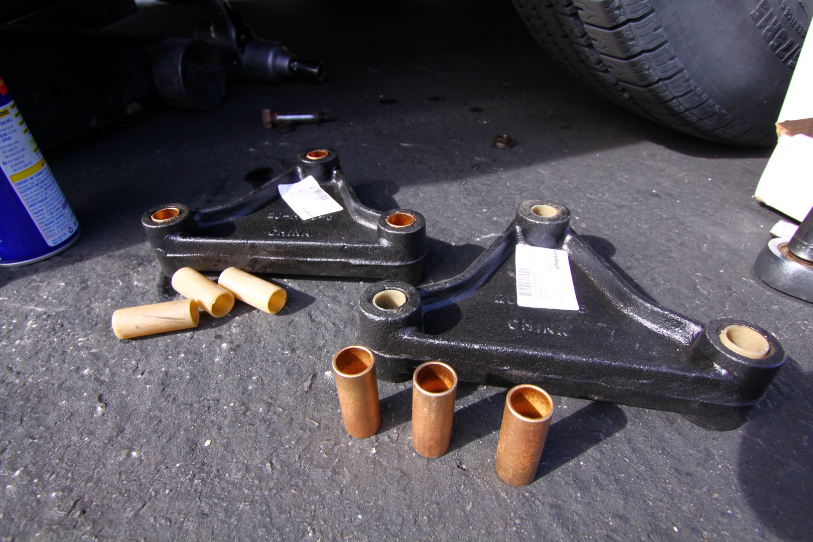

The new kit supplies you with Bronze inserts that tap in easily.
post-1872-0-76429200-1385252062_thumb.jp

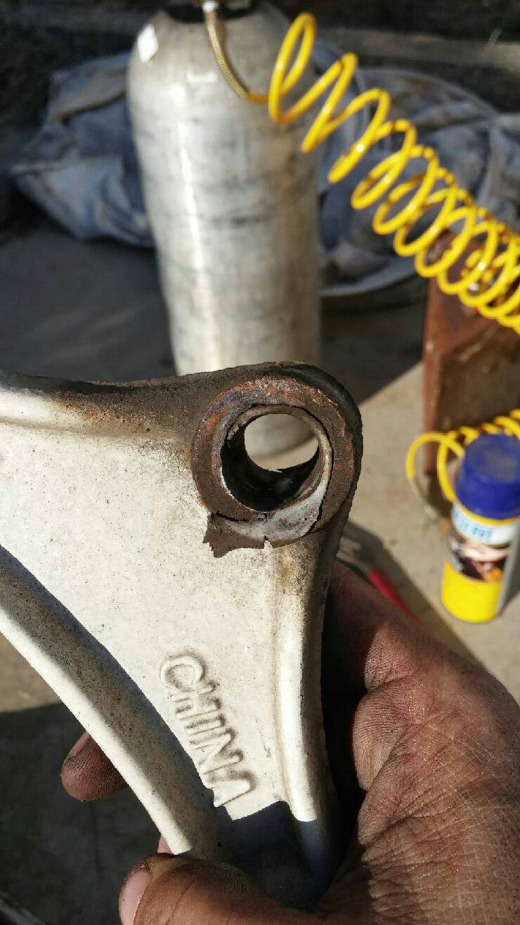

Here is the old stuff, as you can see it was way over due for maintenance.
post-1872-0-69997000-1385252146_thumb.jp
post-1872-0-56564100-1385252159_thumb.jp
And here is the kit all finished-
post-1872-0-89363500-1385253109_thumb.jp
post-1872-0-56269800-1385252228_thumb.jp
All the end pieces have Zirc fittings for grease. The bolts have a hole in them the allow the grease to go to the middle of the bolt and come out and lube the Bronze insert.

Yikes, some of those shackles and parts look like they were about to ruin a dune trip. I've been there before.

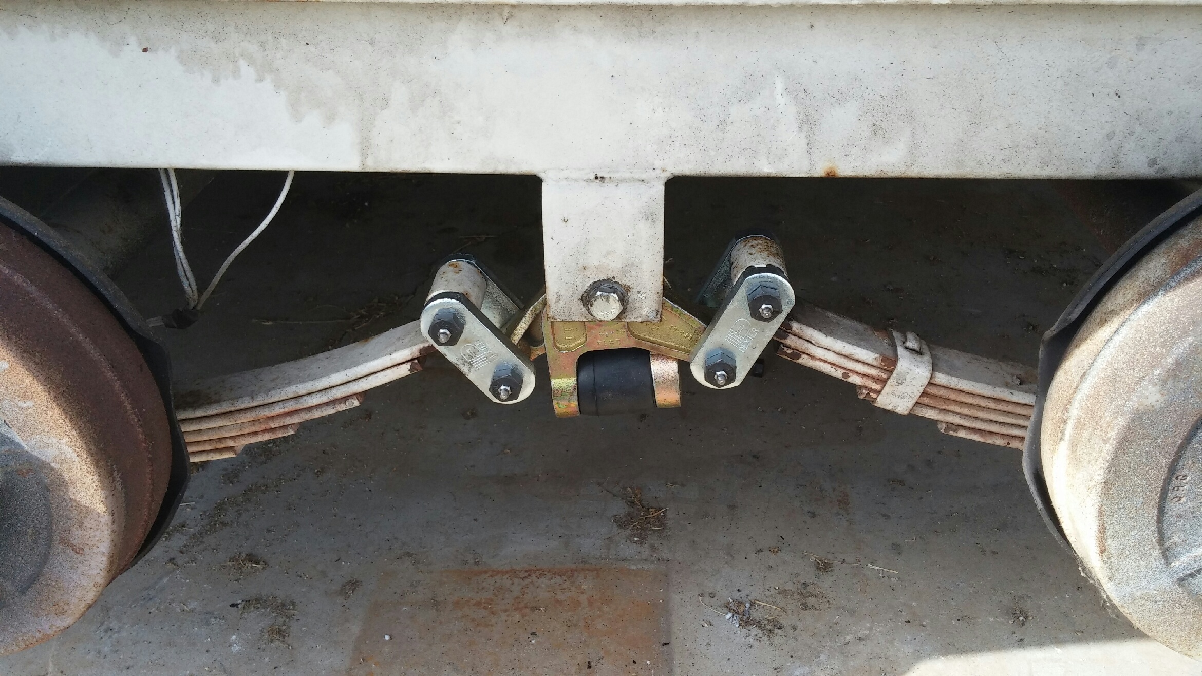

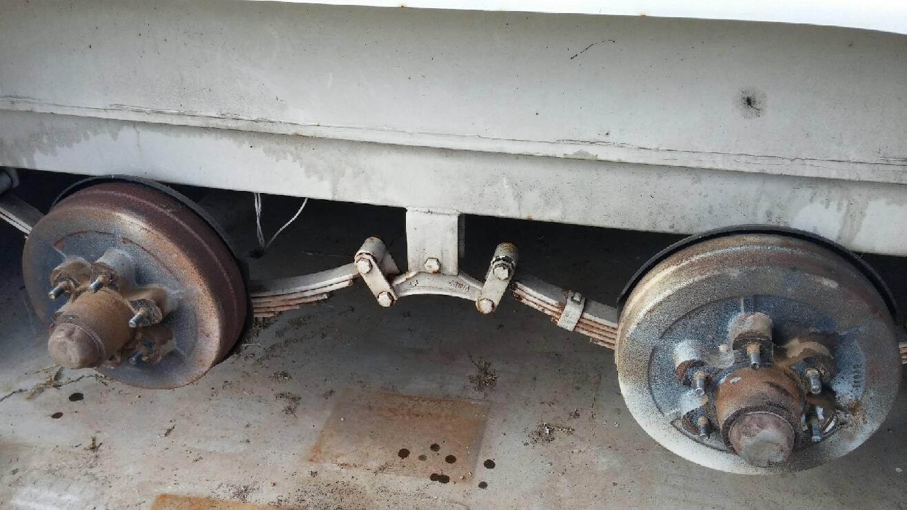

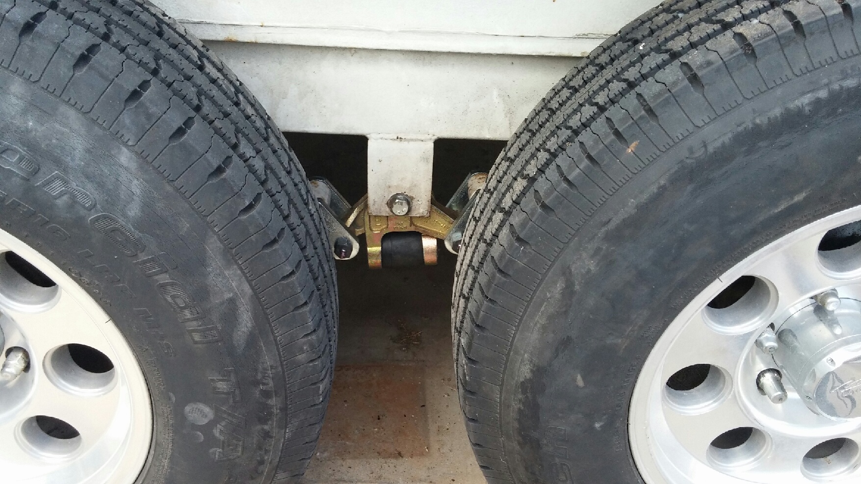

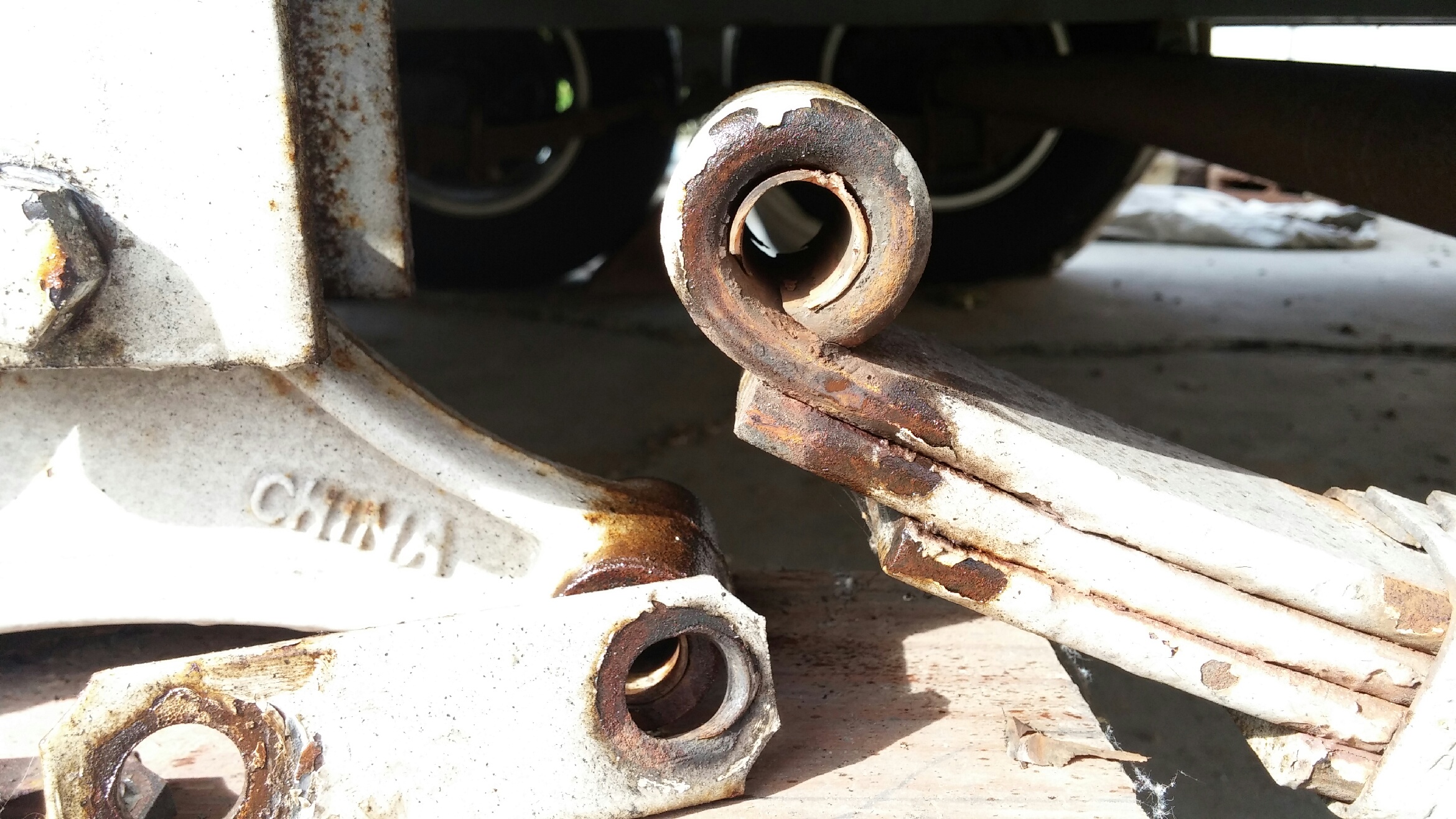

Couldn't do a Dexter setup on mine, but I installed the wet bolt kit and all new equalizers today.
before
after
replaced all the nylon bushings with metal ones in the kit

Nice, That should give you piece of mind knowing that you did that upgrade. Hit with a few shots of grease every couple trips and they should be worry free for a long time to come.

I don't notice any big difference while towing with them installed but nothing it the trailer has moved after getting to the desert. I have a few loose tools on the floor and they stayed put. The big thing is knowing your suspension is now good to go and will be for a long time to come. Those plastic bushings are crap and probably weren't meant to last more than a year or so.
