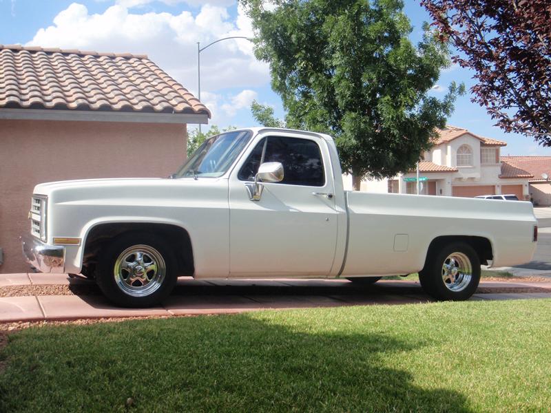

dunefreak Posted July 27, 2008 Posted July 27, 2008 OK, since it is summertime and the board is kinda slow, I figure I'll share my stupid carburetor story with you all. :clown: After d*cking around with this stupid old azz Holley carb for days and days now, I finally got it dialed in. I almost forgot how to work on these damn things after all the years of being away from them. Carburetor? What's THAT? I completely went through the carb and rebuilt it. THEN, last weekend after I got it running, half way around the block the stupid needle and seat decided not to seal and it just started dumping fuel. I parked the p.o.s in the driveway and said eff it. Except, it wasn't quite far anough of the driveway. So sitting on an incline in the driveway , I started it about 20 times to try and move it up about a foot. Not so much. It died as soon as I took my foot off the gas. So I two-footed it and dropped the hammer and burned em up my driveway. :ah: I said screw it and went inside for a beer and left it until this weekend to mess with. So today I finally went out and figured out why the needle wouldn't seal. There was this black chit getting pumped into the carb. The old azz anodized fuel filter housing has a rubber seal that deteriorated to crap and got pumped up through the fuel line. So I got her running again and it runs great. I didn't even throw in the plugs and change the oil like I meant to either. I did wash it though! This time I threw some stabil in the gas so I don't have to do this again. I gotta start driving this thing some more. :peek: Quote

TheAlaskan Posted July 28, 2008 Posted July 28, 2008 Thats a good looking truck pete! I always wanted a shortbed C10 350/350 combo Quote
ltr450 Posted July 28, 2008 Posted July 28, 2008 WOW- had the same truck in high school but the 4x4 version with a super lift and 44 inch tires. Spent more time working on in than enjoying it Quote
