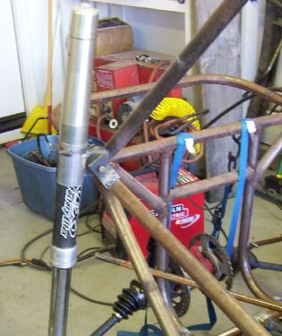

Do you think this rear shock set up will work?

Looks like it will work as far as the geometry, not sure if the forks are ready for that much load though. Try it and see, most of us have a garage full of stuff that didn't work the first time.
I wouldn't trust those clamps on the upper mounting point.

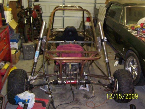

Yea I'm worried too! It's my nephew's buggy build...he built it from scratch...all said and done he has much less than than $1500. into this thing...like the good old days!
Funny... that's the truth! May 19th it will be at Sand Mt. Nv. for a test... run? :beerpint:
Hope it out performs the high $ rails!
Good eye!
What year model? the luuk pretty thick like some 50mm ? He is going to have to fime some SERIOUS springs to handle the weight and probably would want to find a way to run an extra set of upper clamps. Either way props for trying something new :beerpint:

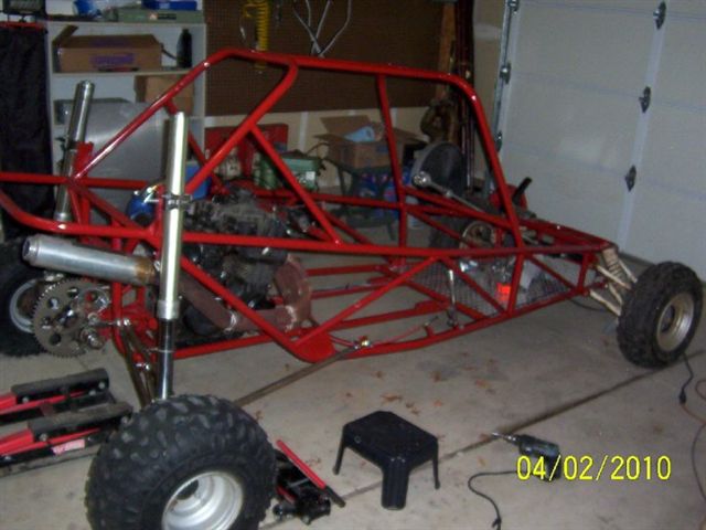

I could see the front shocks being up-dated to dirt bike forks soon and some longer ltz type of arms next trip.
