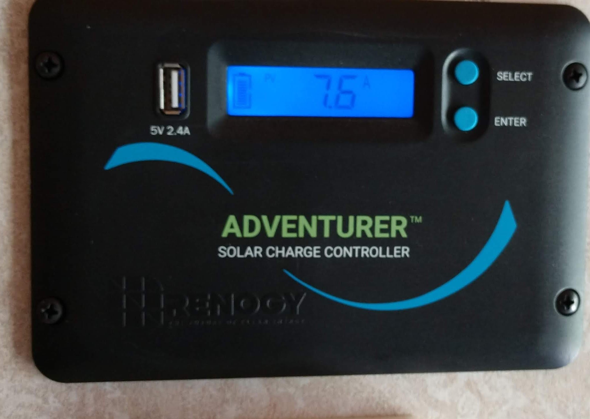

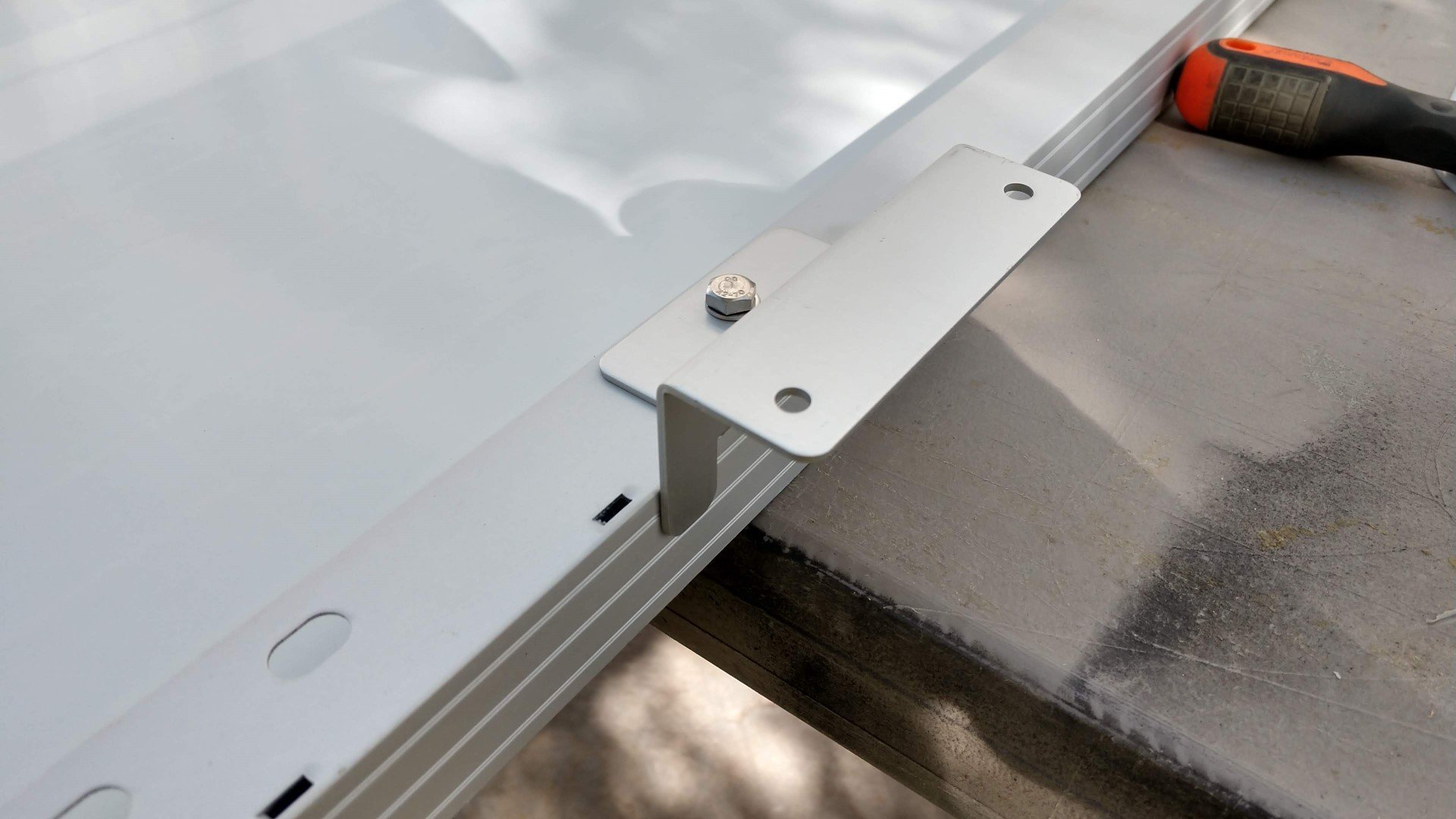

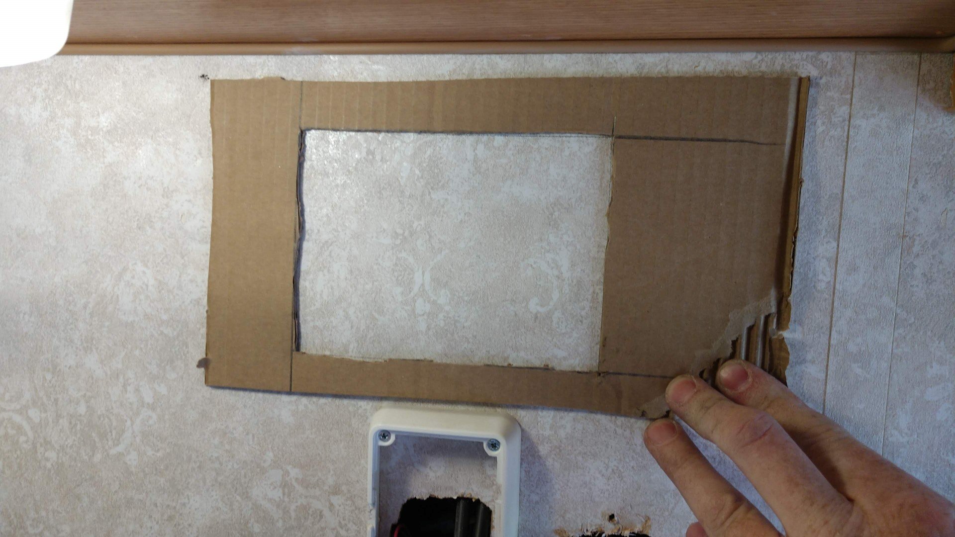

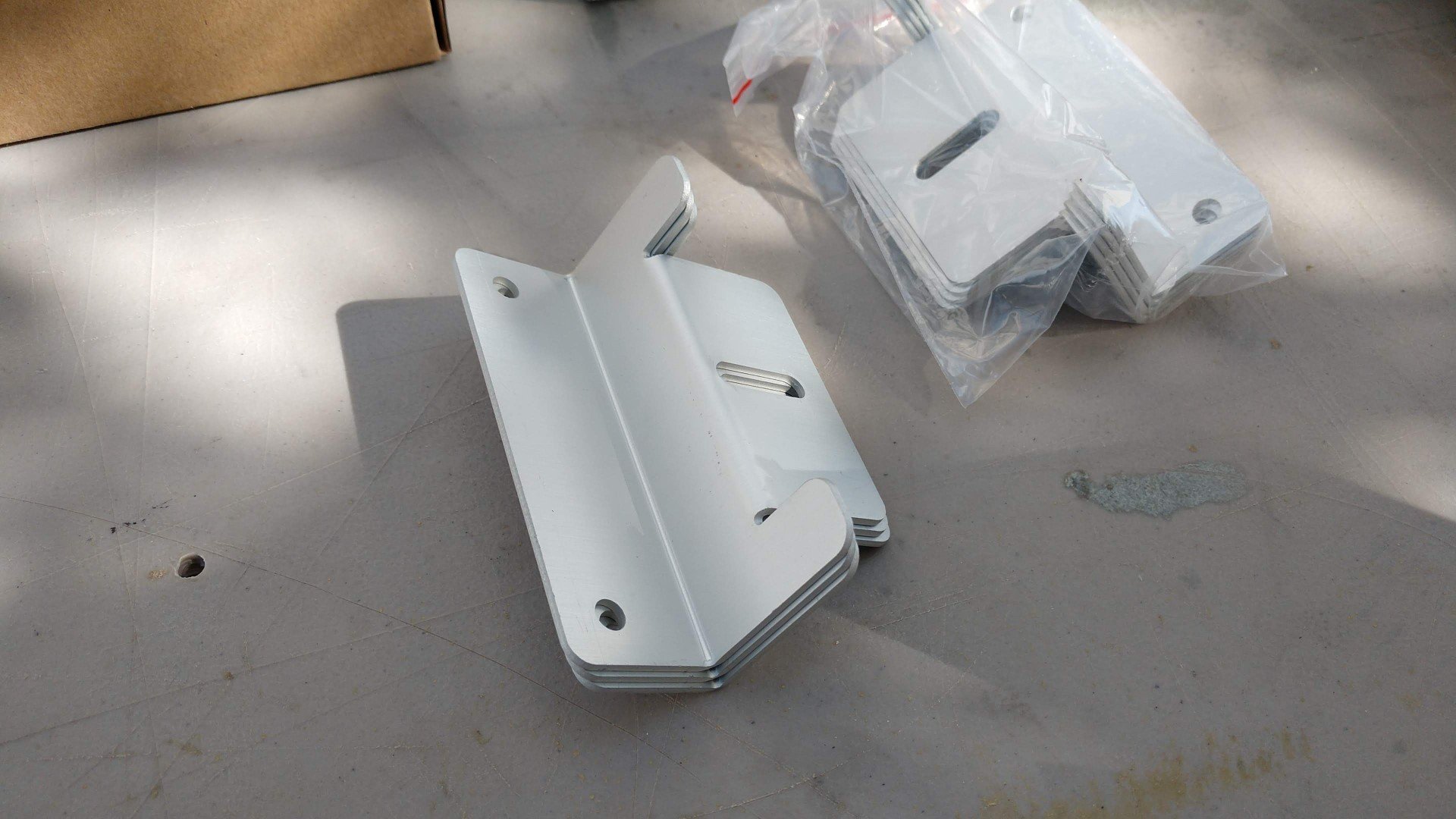

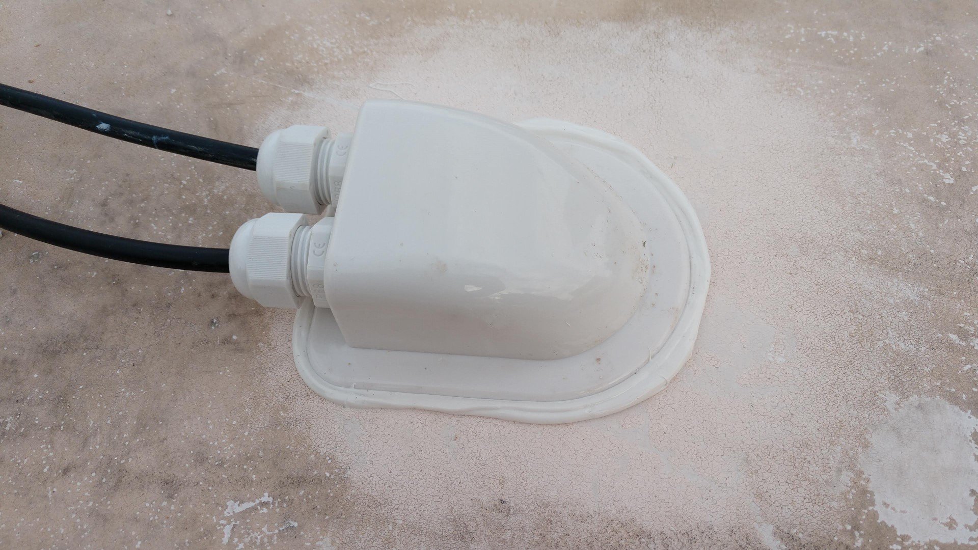

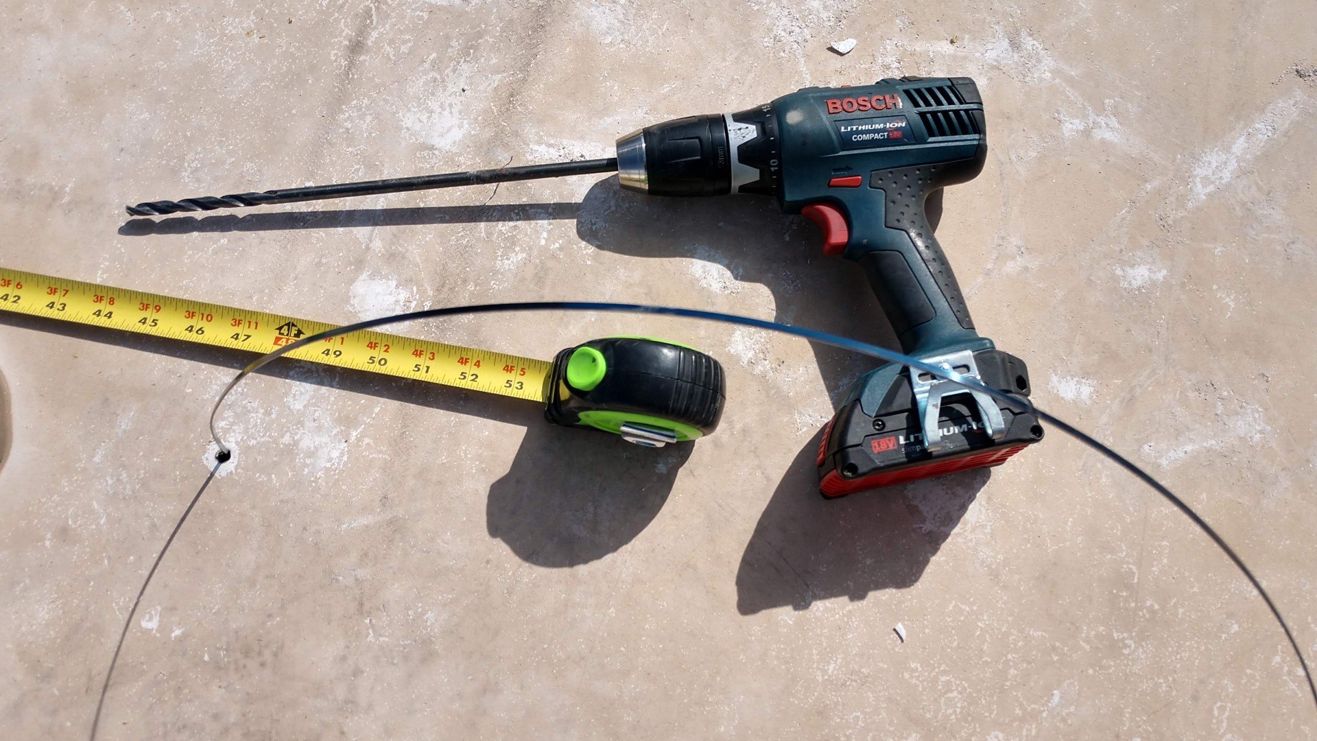

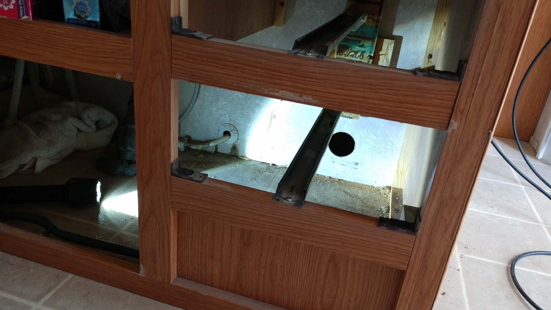

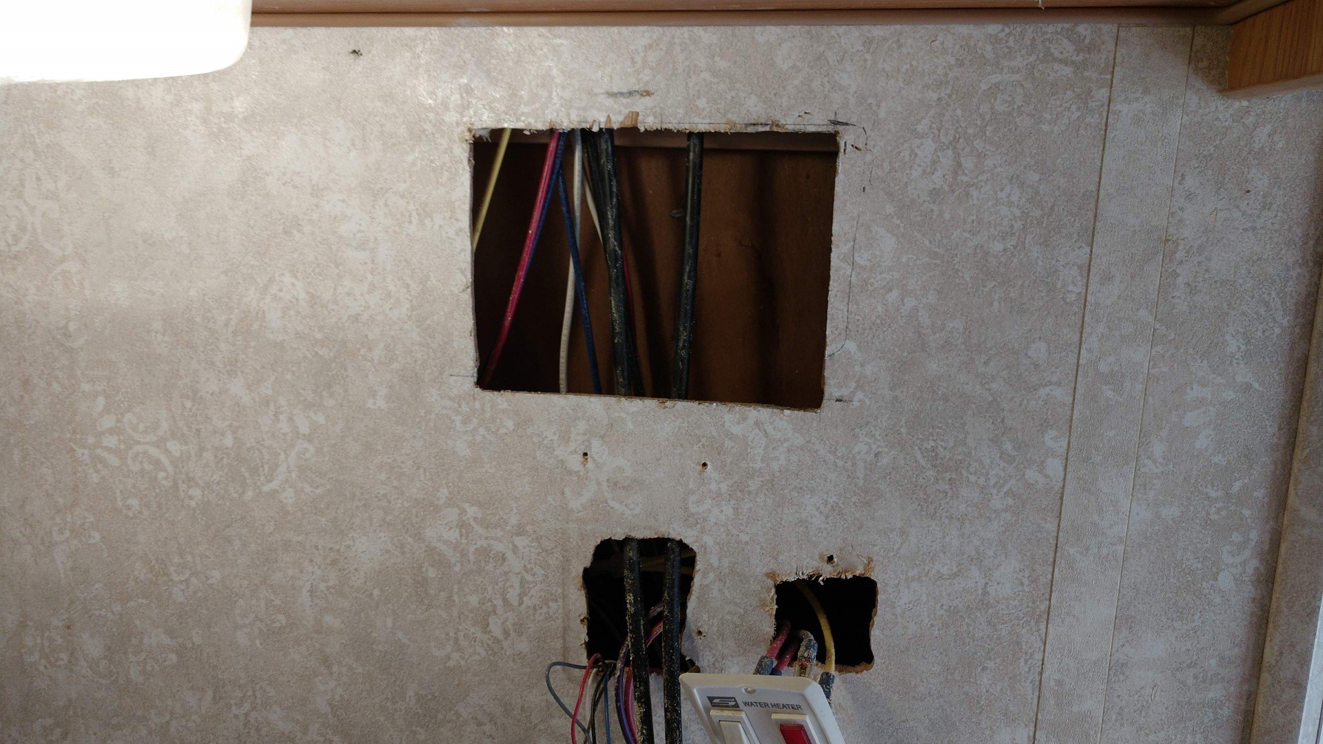

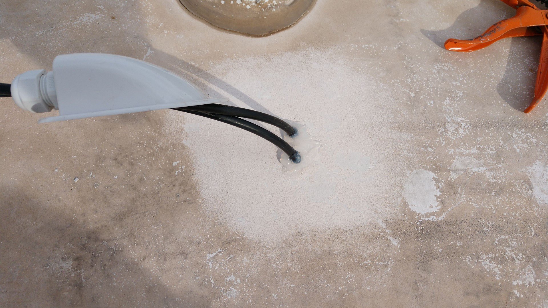

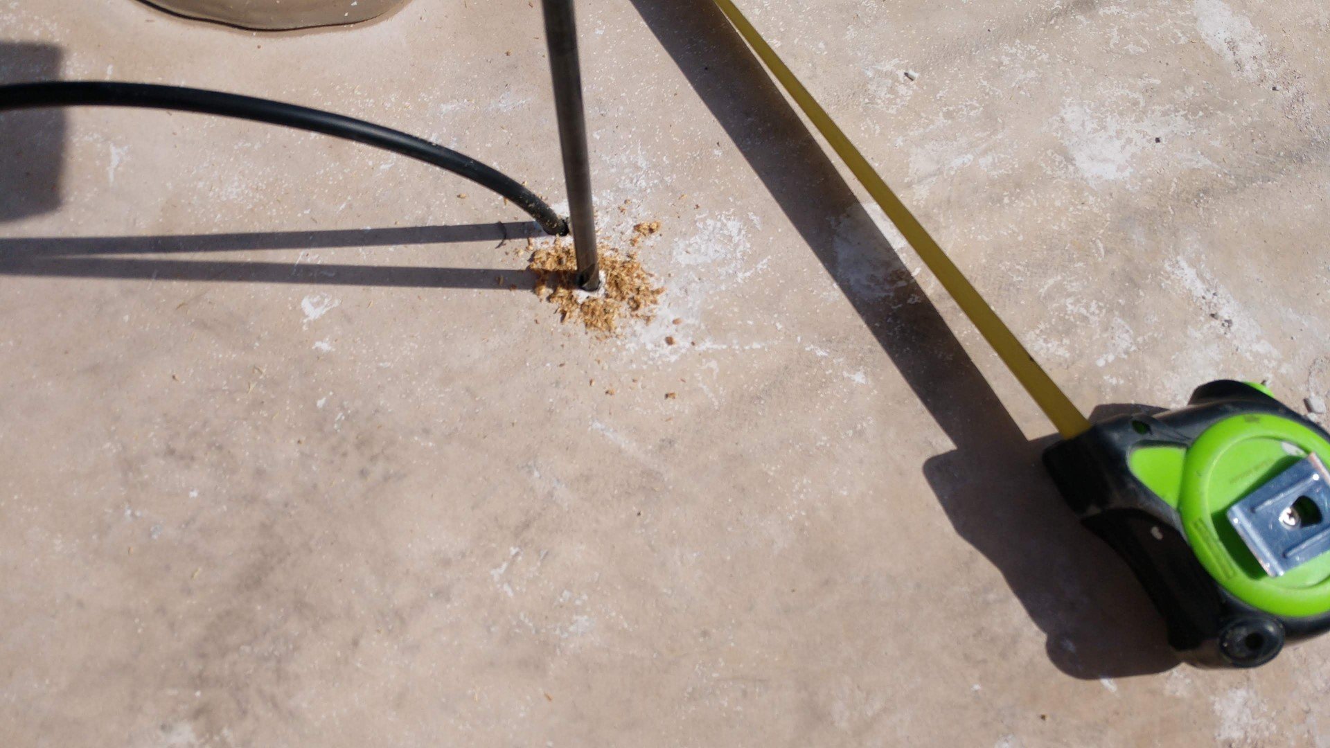

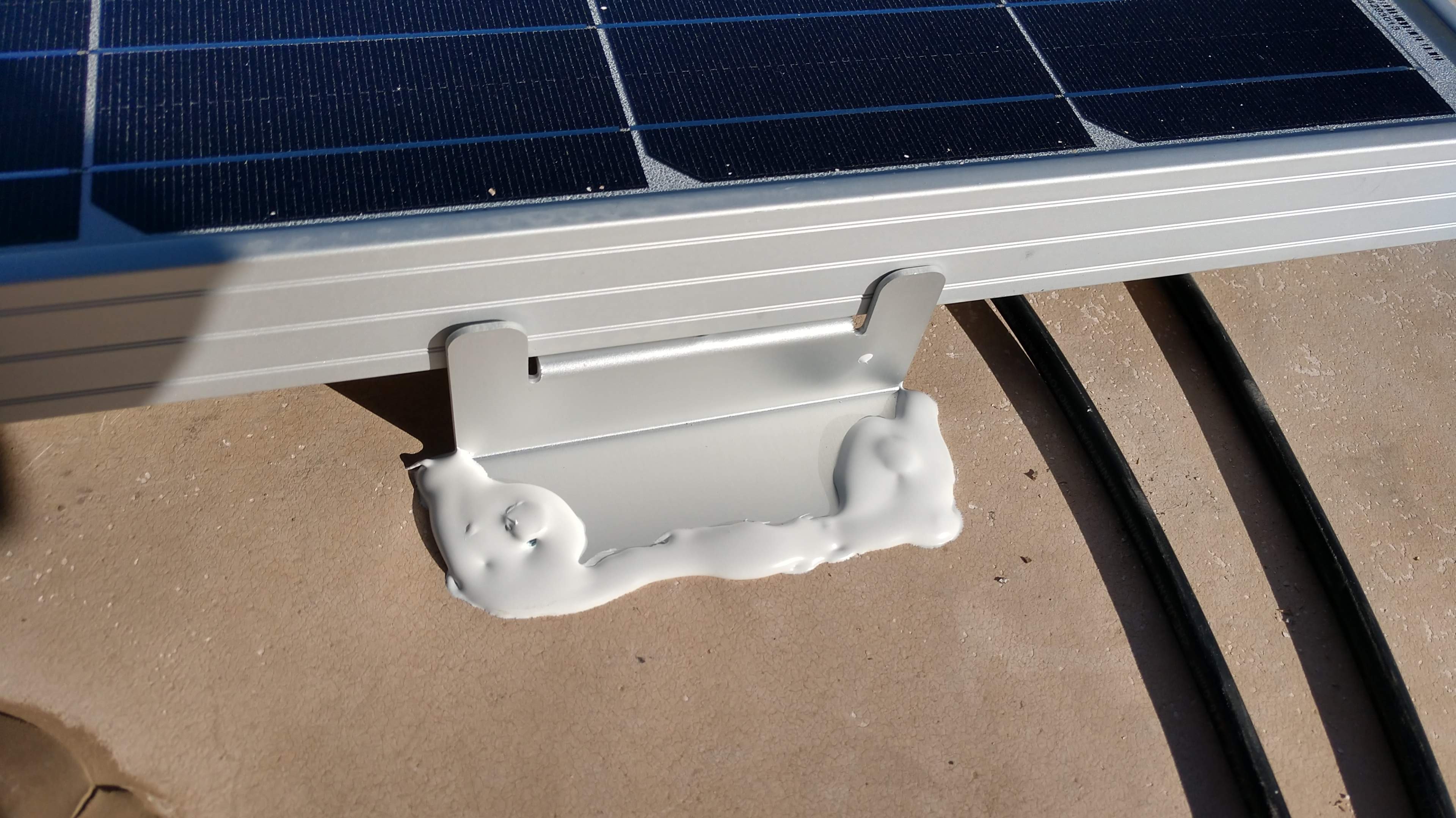

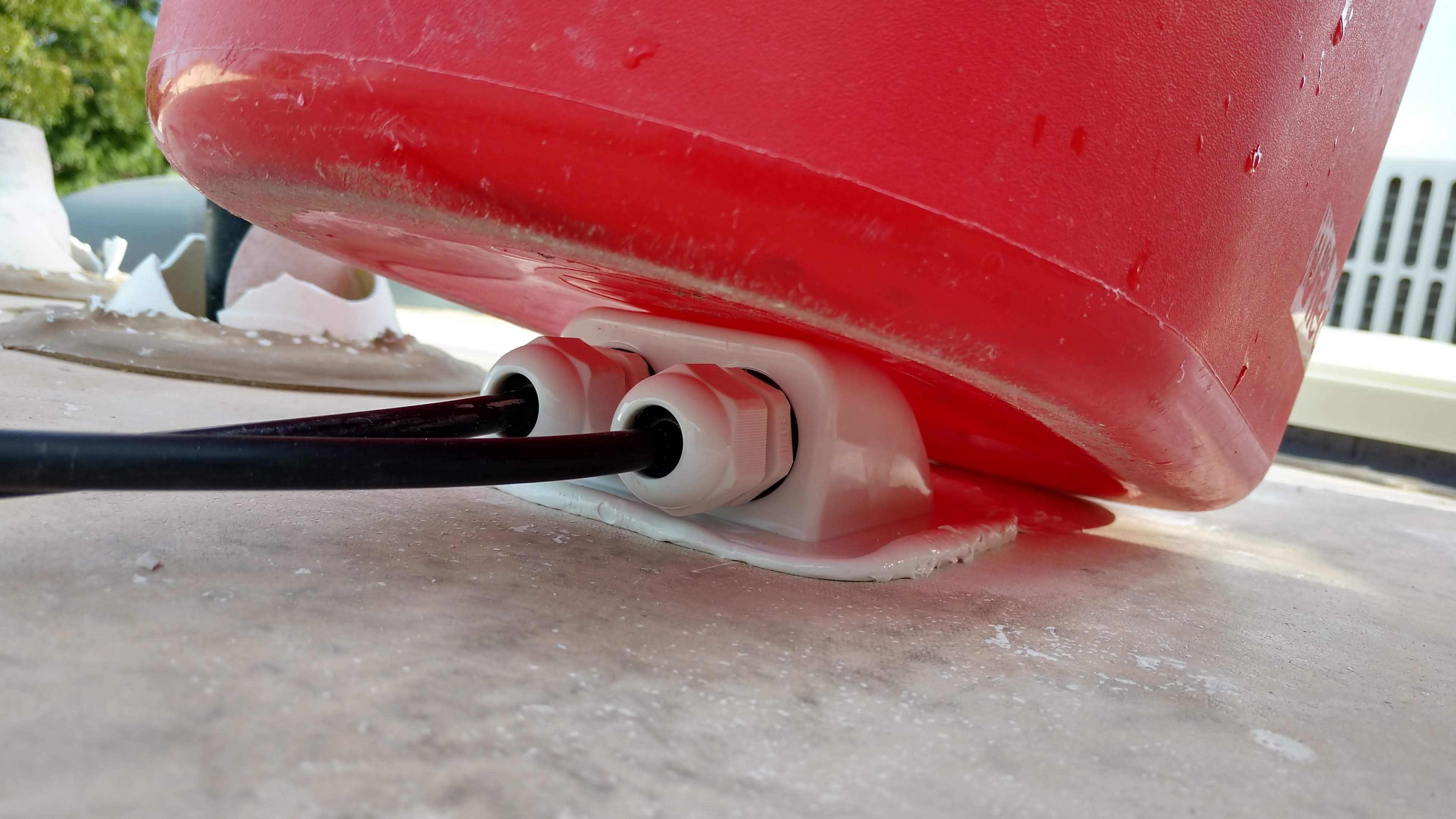

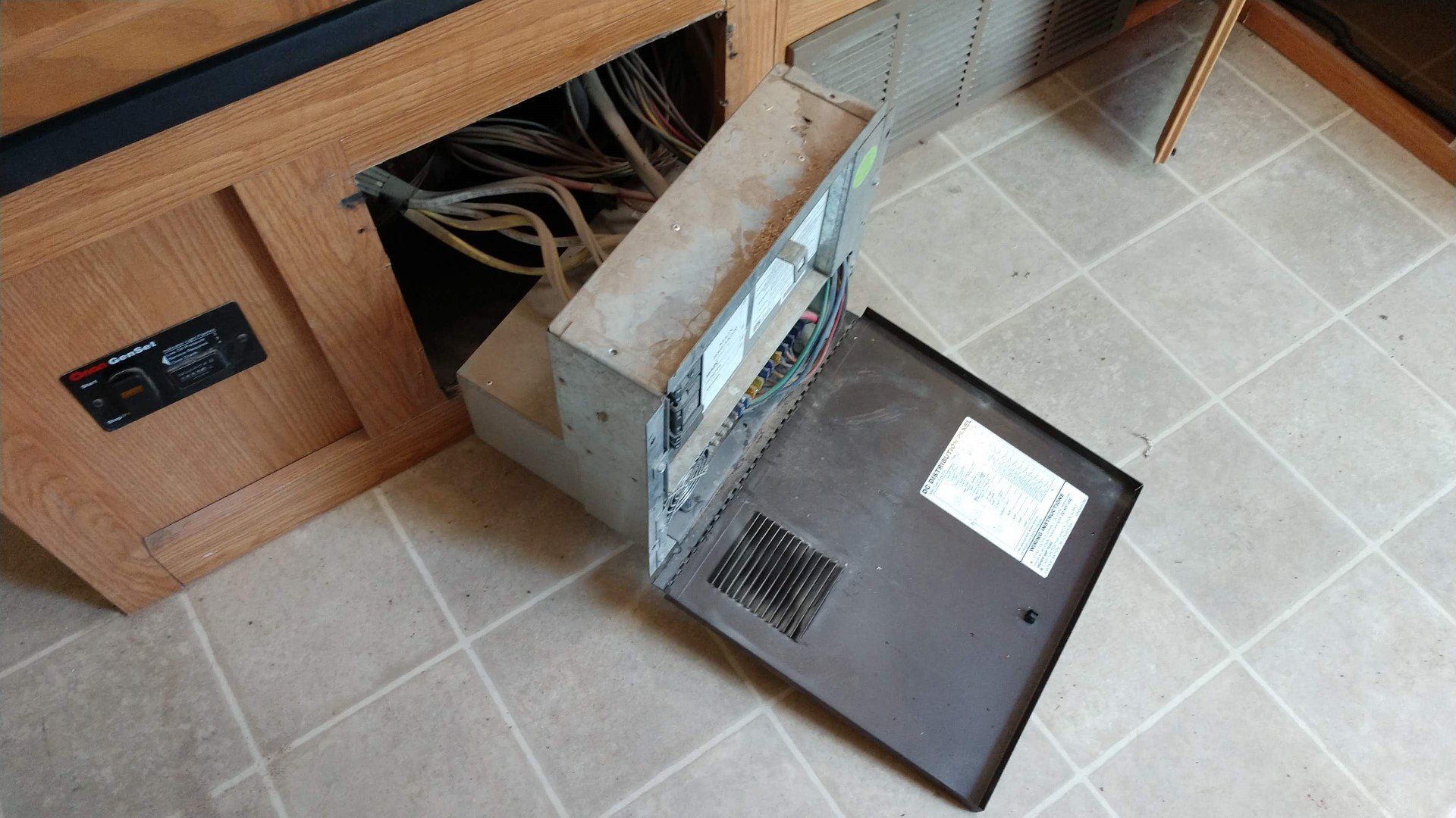

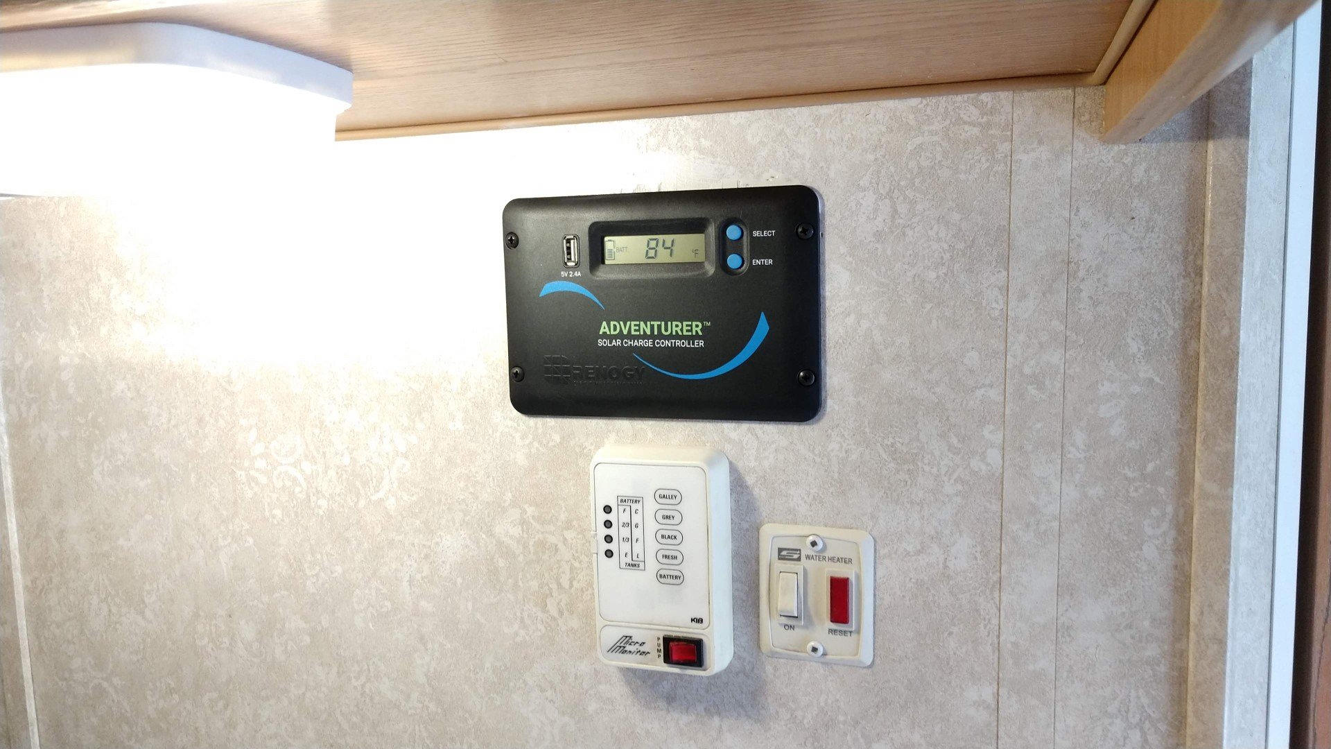

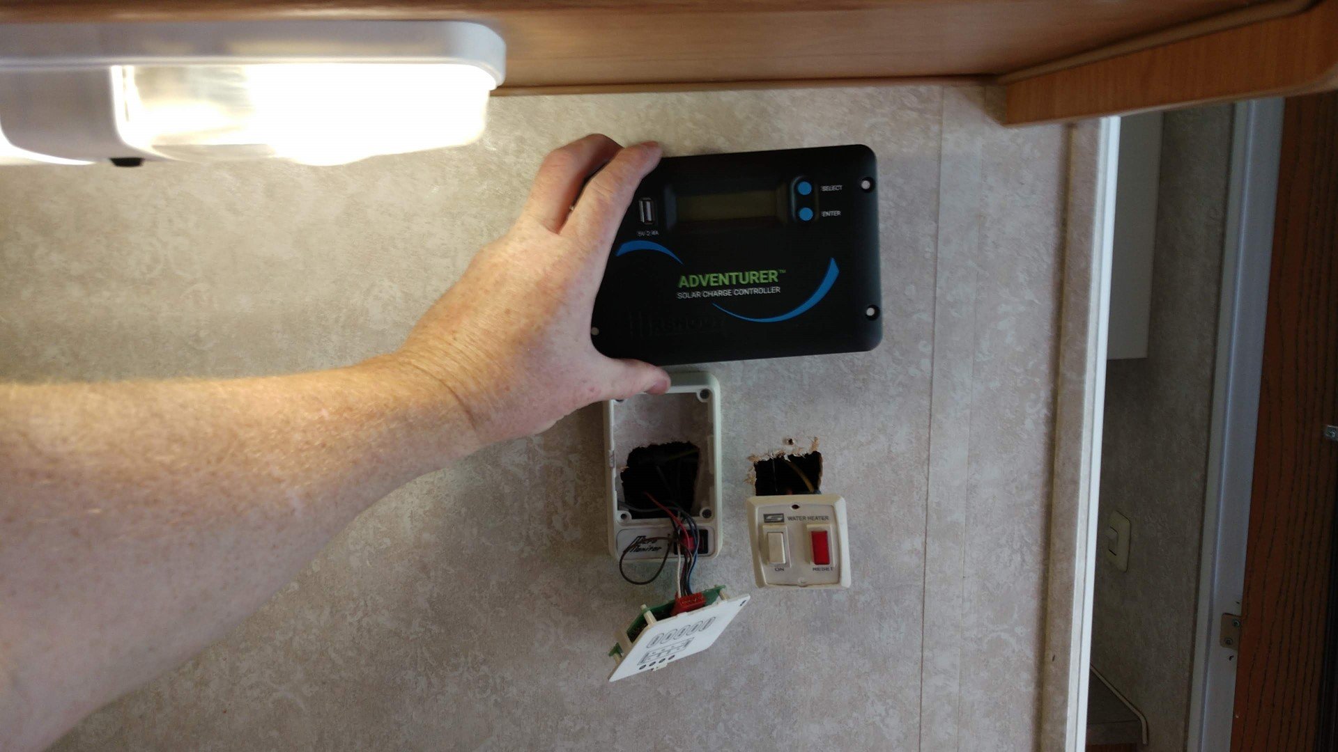

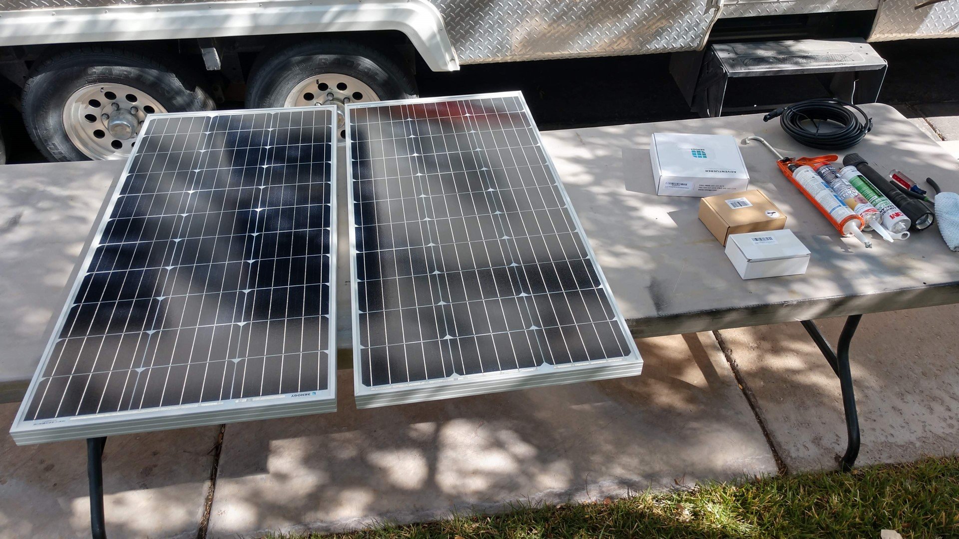

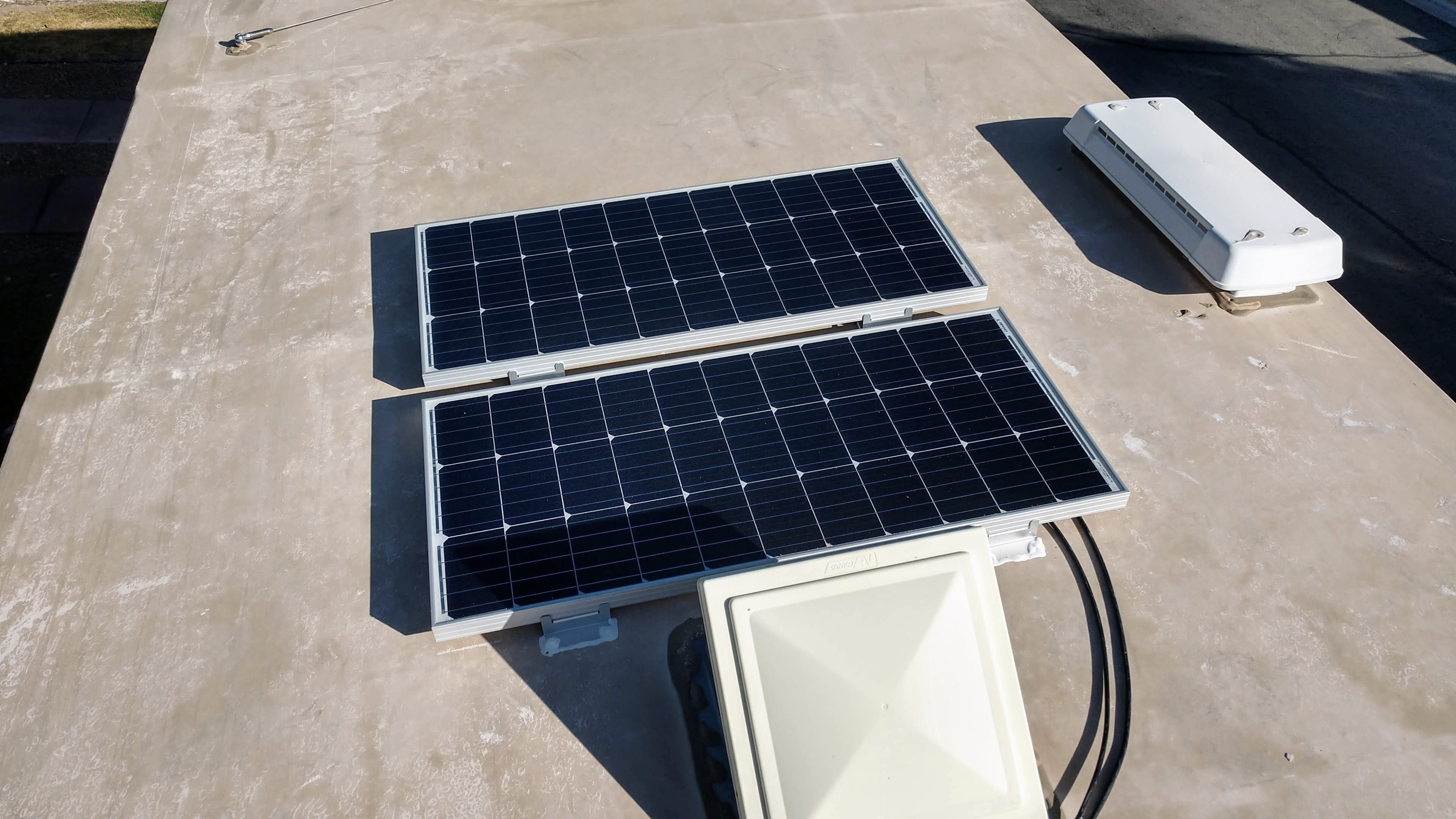

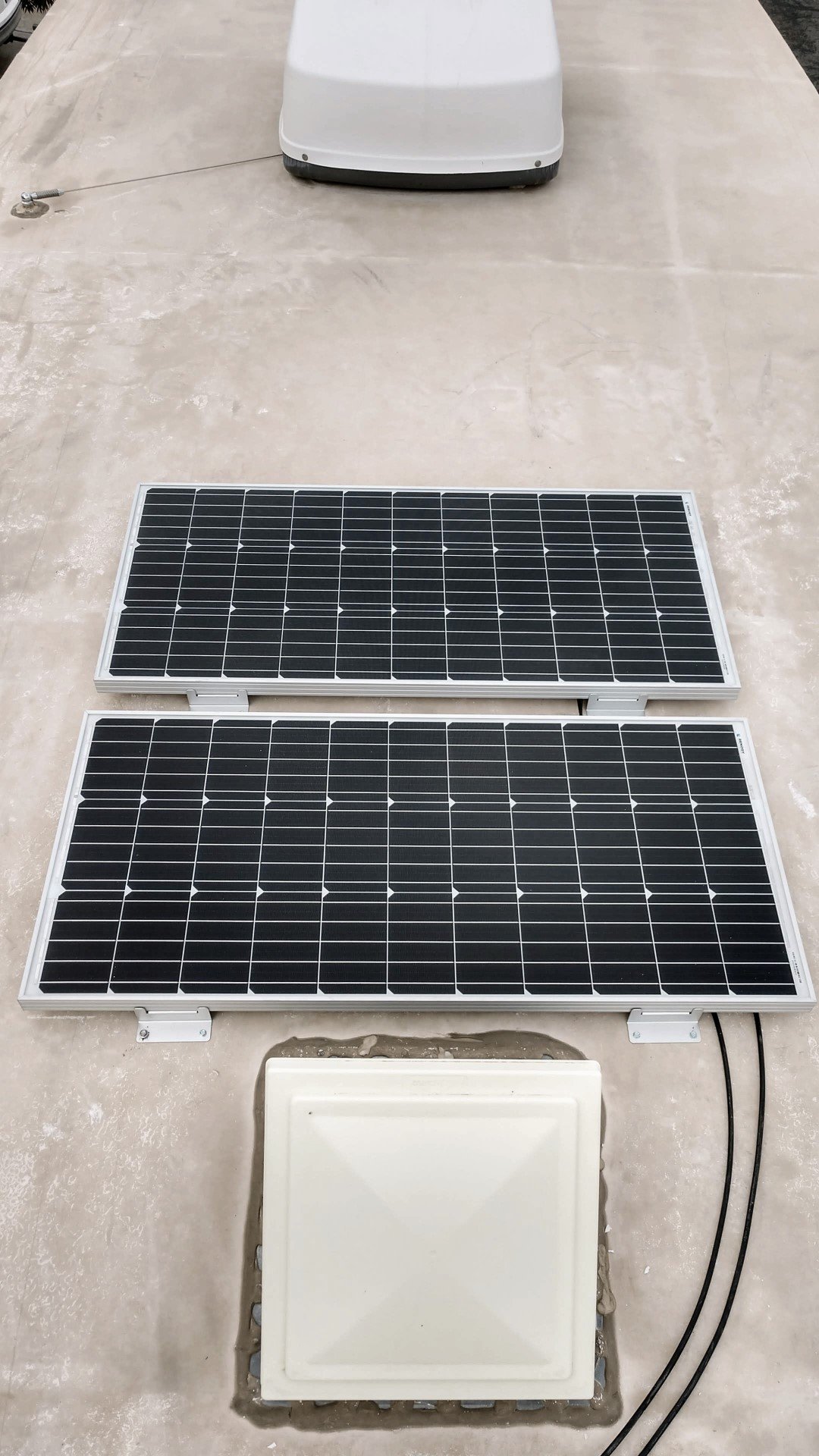

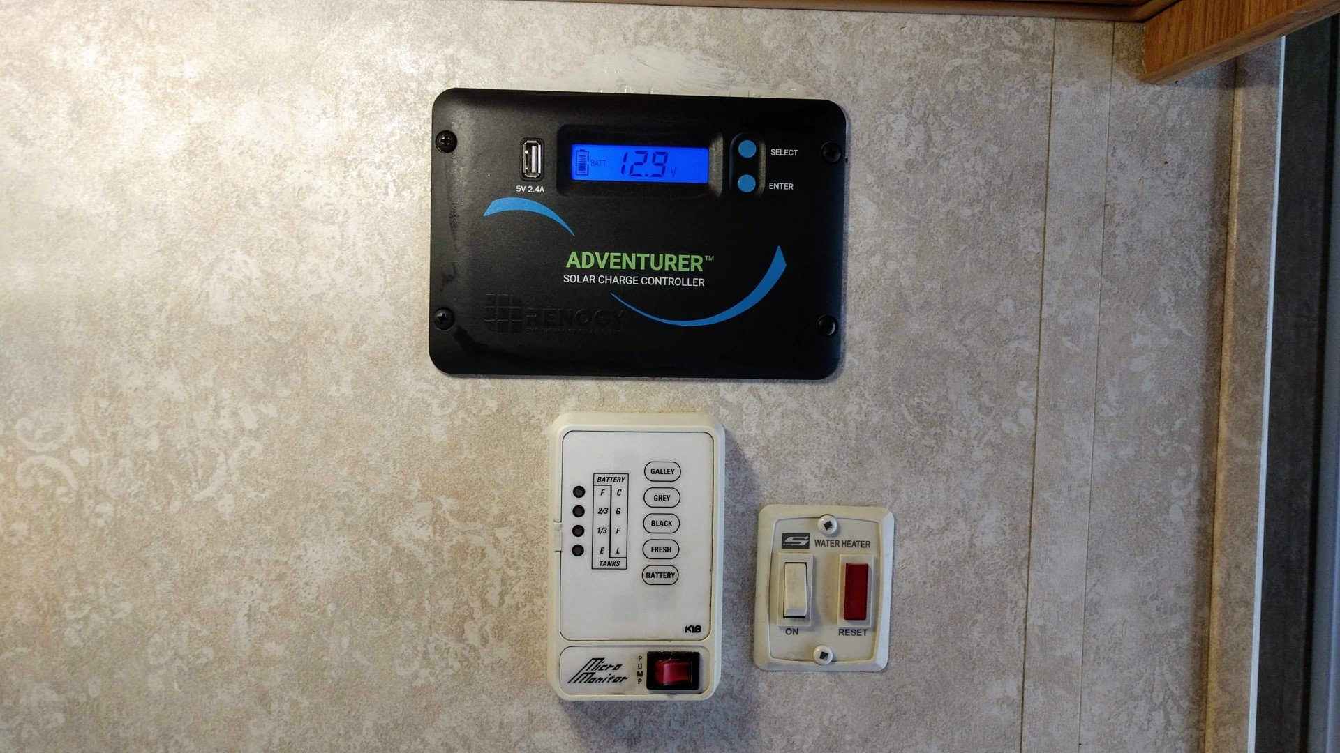

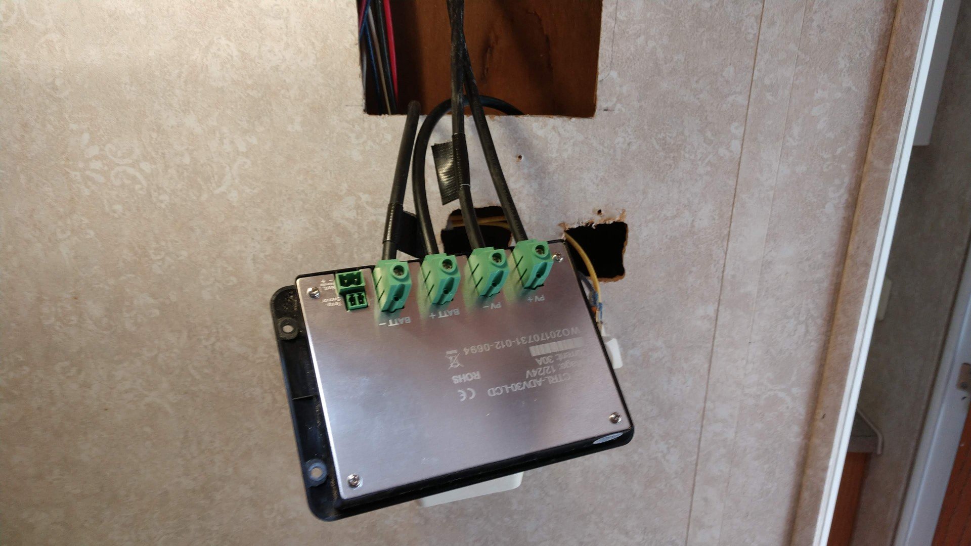

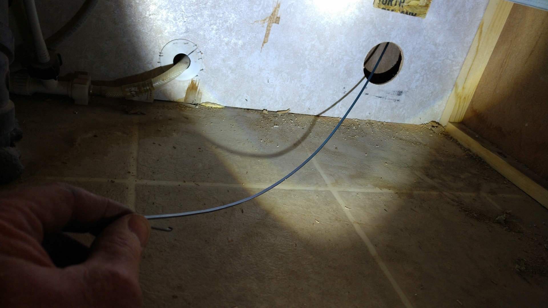

dunefreak Posted November 6, 2019 Posted November 6, 2019 I got tired of picking my trailer up from storage with low or dead batteries. I also wanted to keep my batteries topped off during the day on dune trips while we listened to the stereo, charged phones, ran the vent fans, etc. So it was time to install a solar on the trailer. I did this on our Sprinter van when we built it so I figured it would be stupid to NOT do it on the toyhauler. Everything I bought was off Amazon and extremely easy to install so I figure I would pass along the info from my install. I bought two 100W Renogy panels. I could always add more later, but for now this was plenty of juice. Z brackets attach the panels to the roof. The trickiest part of the whole install was getting the wiring from the solar panels from the roof, down the walls, and to the fuse panel. I located a couple gray tank vent pipes in a wall where I wanted to mount the solar controller to. I carefully measured about 129 times and went for it. I used a long drill bit because I had to get through the roof, then about 8-10 inches of "attic"/ insulation space), then the actual ceiling of the trailer. After I drilled the hole, I used a fish tape to make sure the wire would make it all the way down the wall. Once that was confirmed, I used a large hole saw to drill a hole in the wall in a space that you wouldn't see (behind the drawers in the kitchen area). When I knew that wall would work for running the solar power wires, I fished them through a sealed cable gland. This seals them off on the roof and prevents any water from entering through the holes. (I also siliconed the holes.) Then I used some 3M Marine adhesive to seal/ glue the gland to the roof. A bucket of water worked well to keep some weight on it while it cured. All cured and water tight. I made a cardboard template and cut the hole for the solar controller in the kitchen wall. I made sure the other control panel wires were clear before I cut into the wall. The hole was cut and the wires were dropped down from the panels on the roof. Installing the power and ground to the solar controller is easy. Positive & negative power in and positive & negative power out. 👌 I yanked the power distribution/ converter out so I could access the back side to run the wires to it. I ran the wires through the cabinet and connected them to an open spot in the fuse center. I added a 30A fuse and walla. Power from the sun! The controller is very simple. It takes the high voltage (approx 19-20V) produced from the solar panels, and charges the batteries according to their needs. On an average sunny day, the solar setup produces about 7-10 amps. After I knew everything was working and permanent, I sealed off all the brackets, screw holes and cable gland with Dicor lap sealant. This whole system only cost me about $325. There are even better systems available and you can go much bigger, but for the money this setup is exactly what I was after. It keeps the batteries topped off at 100% all day for when it's time to run lights, heater, etc at night. There's plenty of space on the roof to add more panels too if I feel I need more. Here's the parts breakdown. 100W Solar panels: ~$200 Z brackets: $15 Dicor lap sealant: $10 3M 4200 adhesive: $17 Solar cables: $25 Cable adapters: $10 Solar controller: $35 Cable gland: $11 __________________________ total cost $323 2 Quote

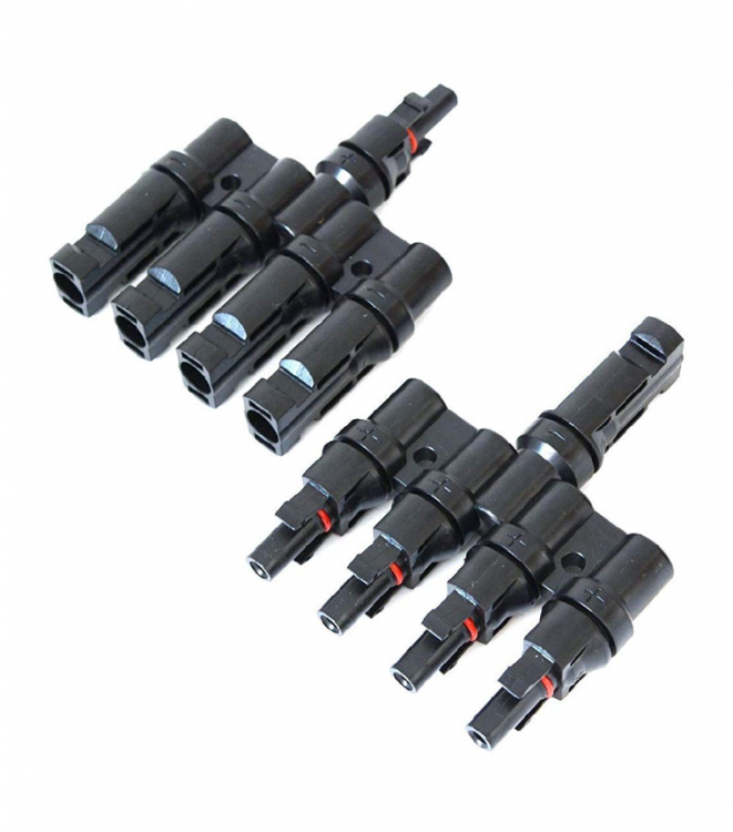

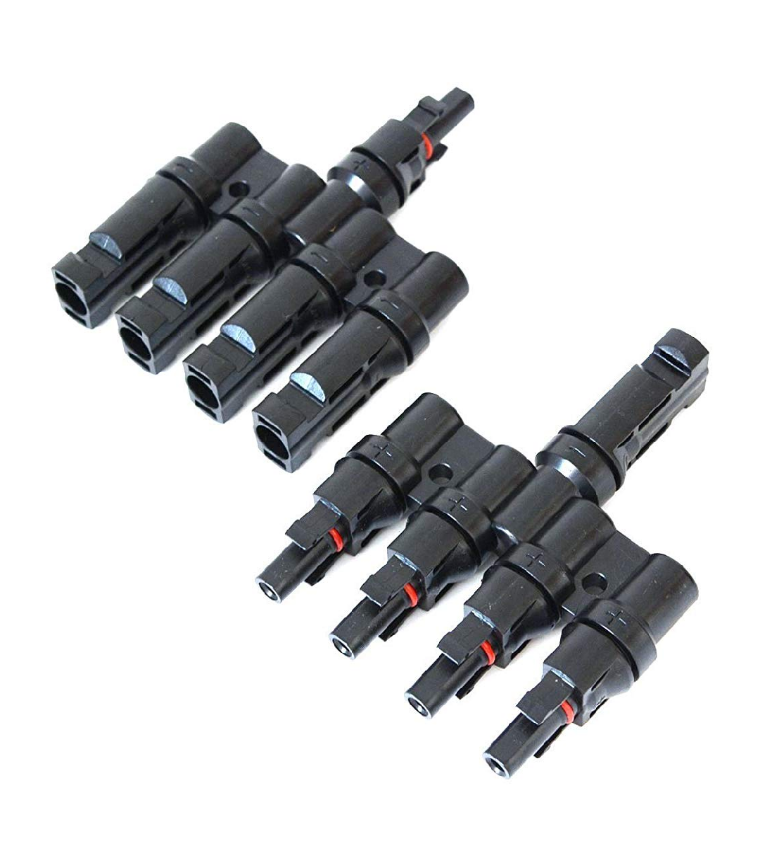

SandBox_Kid Posted November 6, 2019 Posted November 6, 2019 How would you add an additional panel? Would you have to pull another wire into the hauler, or can you "daisy chain" the wiring from one panel to another? I'd like to consider adding one panel to my existing setup. I like your comment "I carefully measured about 129 times and went for it. " 🤣 Quote
dunefreak Posted November 7, 2019 Author Posted November 7, 2019 5 hours ago, SandBox_Kid said: How would you add an additional panel? Would you have to pull another wire into the hauler, or can you "daisy chain" the wiring from one panel to another? I'd like to consider adding one panel to my existing setup. I like your comment "I carefully measured about 129 times and went for it. " 🤣 Super easy. They make solar cable connectors to plug them into the one set of solar wires that feed to the controller. https://amzn.to/33z1jvD Quote
aceisback Posted November 7, 2019 Posted November 7, 2019 Nice job and write up Pete. Especially like that cable gland. Most I've seen just drop the wires down the refrigerator roof vent. Clean install you have. 1 Quote
DESERT_RACER Posted November 7, 2019 Posted November 7, 2019 14 hours ago, aceisback said: Nice job and write up Pete. Especially like that cable gland. Most I've seen just drop the wires down the refrigerator roof vent. Clean install you have. Yup, i agree. Down fridge vent works, but the little wire cover is so clean. I used it when i did my solar also, makes it look factory. Quote

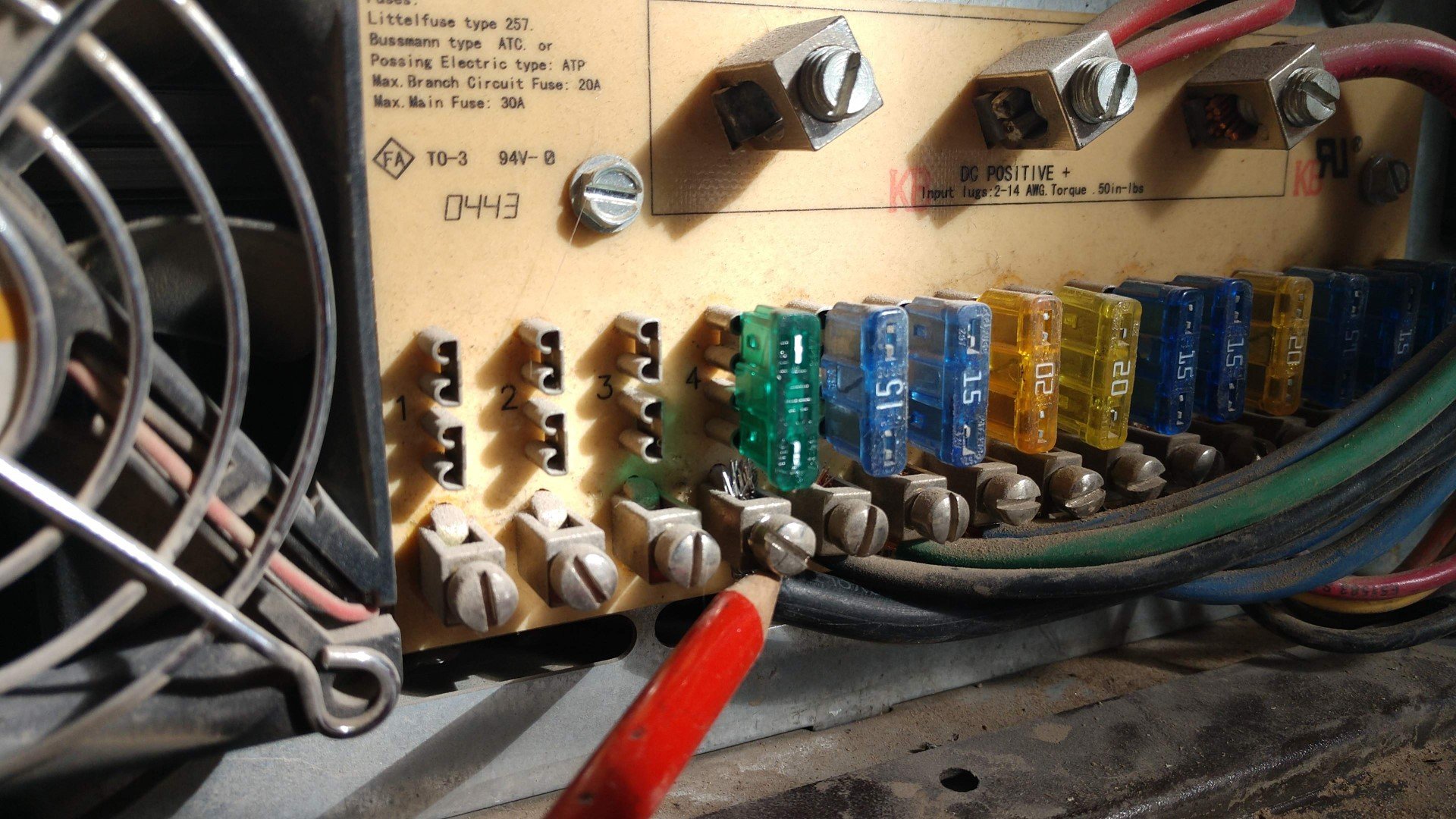

ntrsandman Posted November 25, 2019 Posted November 25, 2019 Found it interesting that the wiring from the controller is connected to the converter. Obviously on the B+ circuit to feed the batteries. Most all RV solar diagrams show direct to battery connections. Was this to eliminate more wiring to get to the batteries, was it as instructed, or a "Hey, if I do it this way, it will do the same thing!" idea? It actually makes sense. Quote
dunefreak Posted November 25, 2019 Author Posted November 25, 2019 1 hour ago, ntrsandman said: Found it interesting that the wiring from the controller is connected to the converter. Obviously on the B+ circuit to feed the batteries. Most all RV solar diagrams show direct to battery connections. Was this to eliminate more wiring to get to the batteries, was it as instructed, or a "Hey, if I do it this way, it will do the same thing!" idea? It actually makes sense. It's just how I decided to do it. The battery mains (cables) connect right there anyways so it would be redundant to run a second set of cables up to the batteries. It's all tied together. Quote
aseman Posted November 26, 2019 Posted November 26, 2019 I believe the converter power line goes to the battery disconnect switch. The solar goes directly to the battery to bypass this, as you may want to disconnect when the rig is in storage. At least that's the only logical reason I can think of?? Quote
dunefreak Posted November 26, 2019 Author Posted November 26, 2019 Correct, the disconnect would be in between. The whole point of installing the solar was so the batteries stay topped off. I plan on leaving the switch on so the batteries never die. The solar controller will handle the trickle charge. It's ok with me if the switch stays on and the system has voltage. Doesn't hurt anything. Quote
