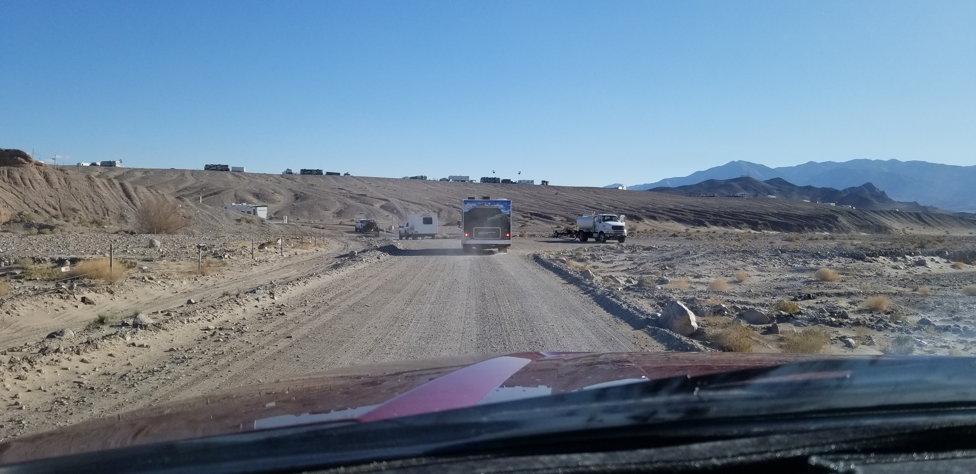

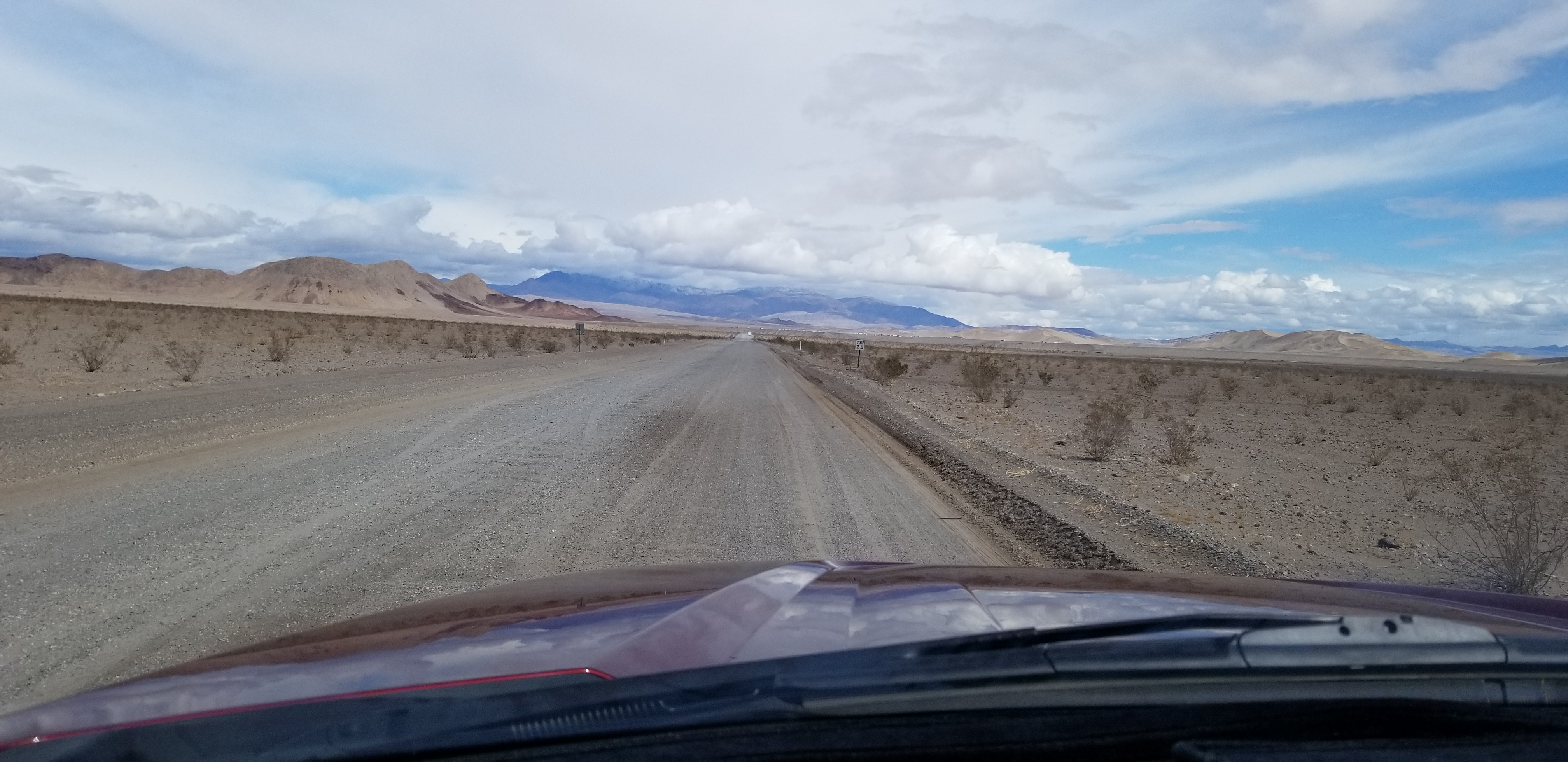

I spoke with a local blm ranger and he said they had to use a private contractor for road maintenance because the normal operator is on light duty. He said they are supposed to start maintenance a few days before the holiday weekend but he couldn't guarantee it. I was out there today and I can agree that it has been the worst I've seen it in my 17 years of duning.
