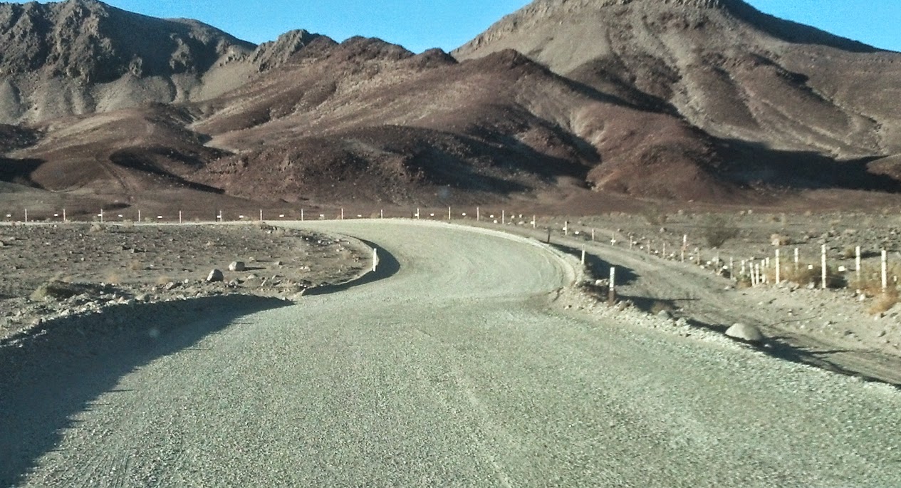

I'm a heavy equipment operator who has graded for many years. I try to avoid discussing the road as the condition and grading techniques drive me nuts. But what the heck, here goes.
First, I would regrade with proper crowning and ditches, next I would have the road sprayed with lignosulfonate.
Lignosulfonate is essentially tree sap suspended in a salt water solution so it can be sprayed. With the road material "roughed up" using button bits, the solution is applied,finish graded, then rolled before it dries.The salt water evaporates leaving behind dried tree sap. After it dries it becomes almost as hard as asphalt and is insoluble. The tree sap sticks the particles of dirt together holding the road shape, stopping the road from wahboarding and holding the dust down to below PM10 standards. That means very little or no dust
PM 10 standards:http://www.epa.gov/airtrends/aqtrnd95/pm10.html
The cost is low because it uses a waste product, and we would be happy with no washboards or dust.
This is what it looks like being applied. It smells like bbq sauce!

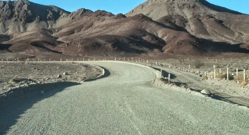

I like like bbq sauce! I say your hired!! :thumb: Get er done and send the bill to Ynot..

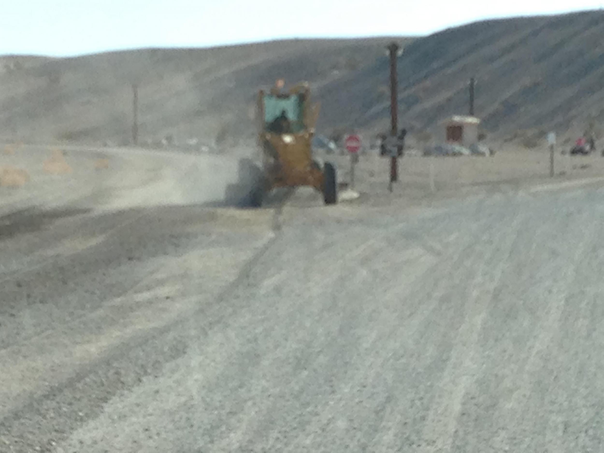

According to my buddy who rolled in this morning, the grader is working on it now.

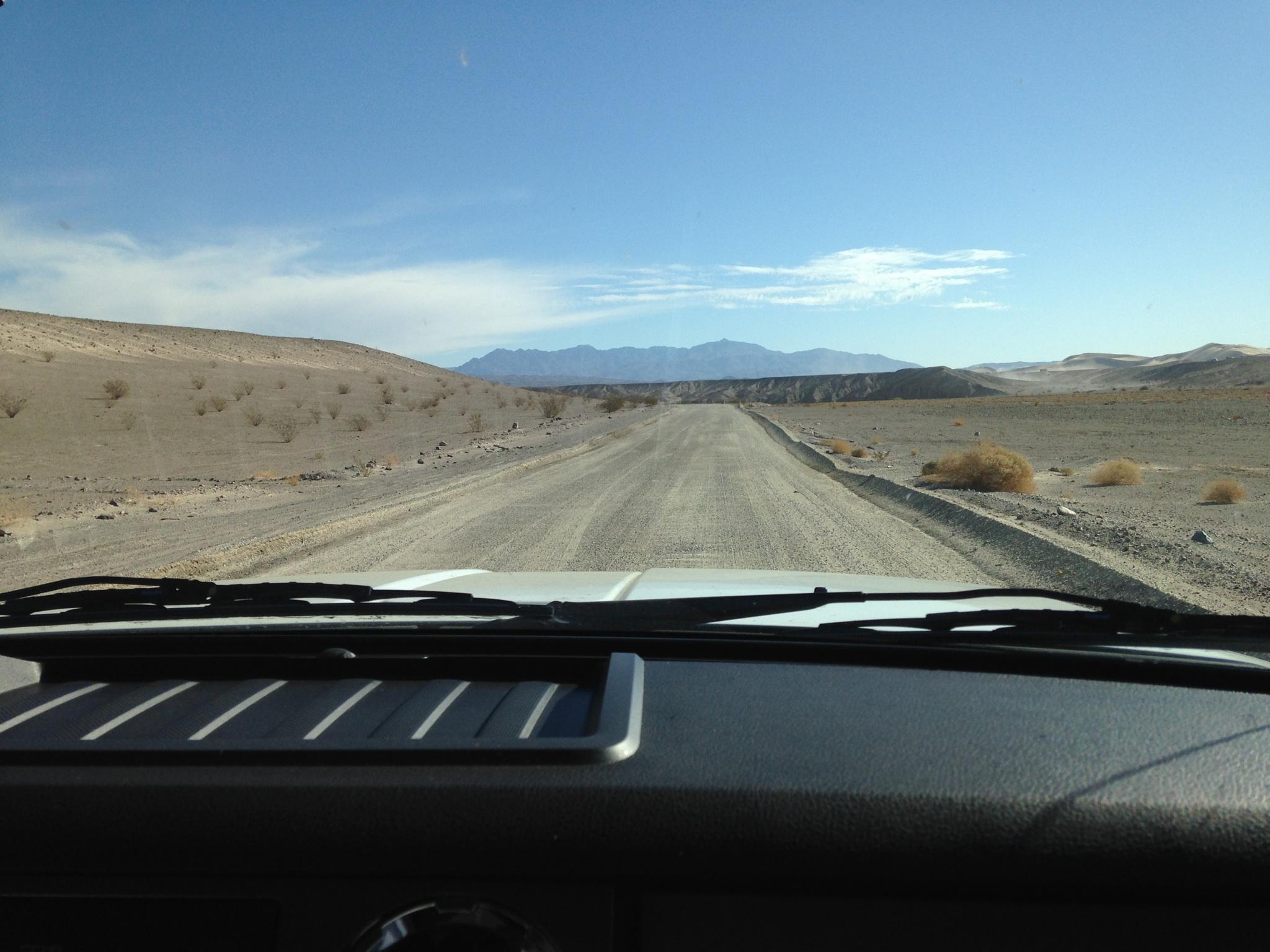

UPDATE: A rating. The entrance road as of Sunday was already graded and very smooth. You can easily do the speed limit without losing your fillings.
